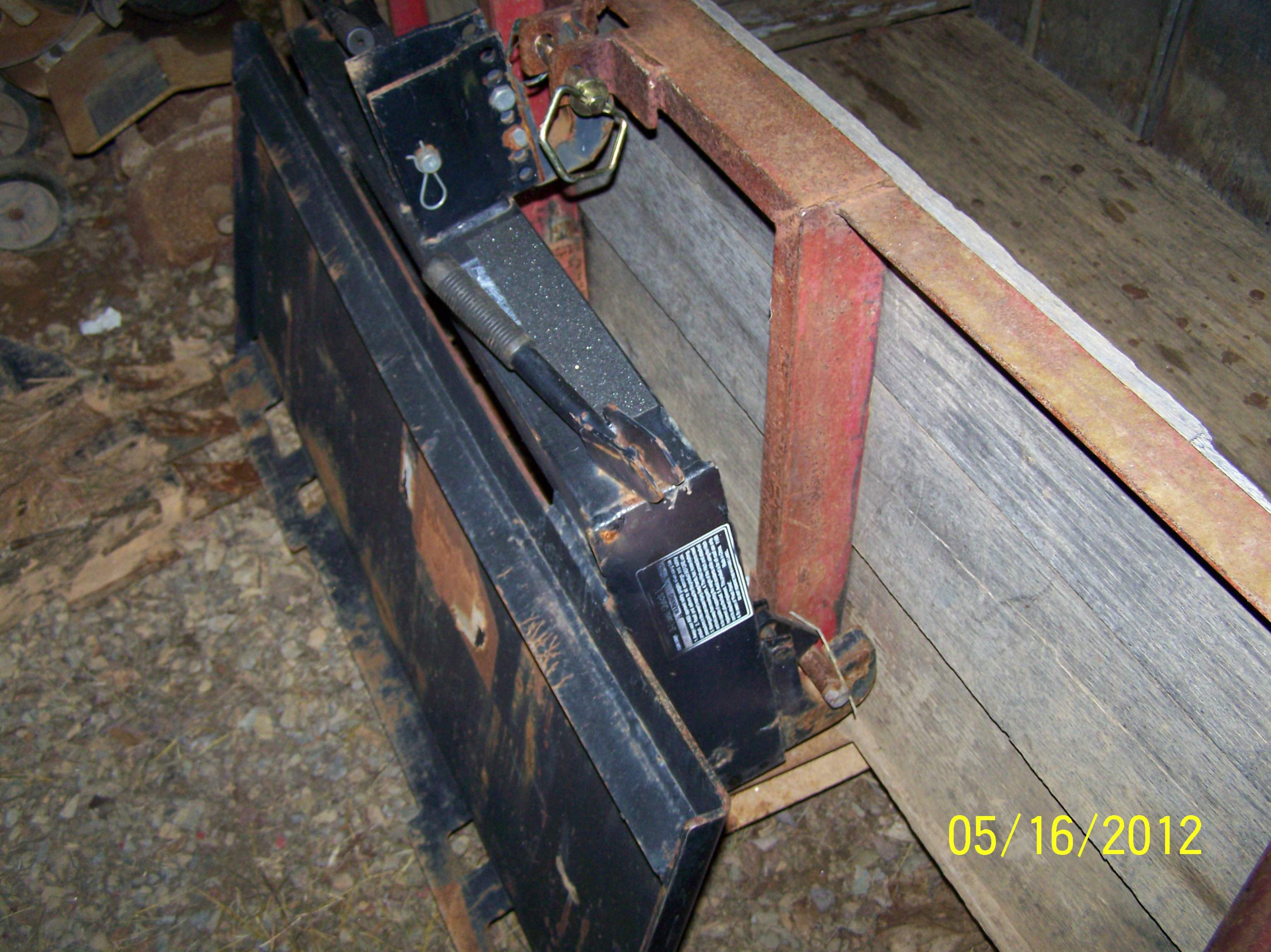

I need a landscape rake, at least I think I do. you see I have a couple of hundred trees on my place and I cant mow without hitting fallen limbs, so i was thinking a landscape rake might pull out the downed limbs,but then I have to make two trips around the whole place( one to rake ,one to mow )
so, Imma thinkin, why not build a rake to fit the qa on my fel, rake and mow at the same time.
So would this work or not. and if not , why not??
Sure I can see still having to go back around and collect the limbs afterward but........

Some folks have welded a harbor fright quick attach to a FEL quick attach plate. That way you could use the rake or other 3 point attachments on your FEL. Another thought would be to get a Ratchet Rake to strap on your loader bucket to pull the branches out.

I have a rachet rake and it works great for pulling brush out but I can sure tear up the yard with it .I like the idea of putting the Landscape rake on the front loader instead of building a unit that could only be used on the front.
That's what I did. It works well for cleaning out ditches. I use it with my carryall for a work platform/ lift, to trim trees.
I originally built it for use on my bobcat, but it has lots of uses on the tractor.
If you have a mower on the back it's going to be loooooong.:eek:
Bill

I'm not sure I understand what you are asking. I don't know of anything that attaches to the loader bucket itself. They go on to the loader QA.
I think this is what you are refering to.
Bradco Universal Skid Steer Quick Attach to Tractor 3 Point Hitch Adapter
This is something like what I used to build mine.
I do think you can build one for< $350.
NorTrac Three-Point Quick Hitch Category 1 | 3-Point + PTO Hardware | Northern Tool + Equipment
Skid Steer Loader Quick Attach Mount Plate 1/4" Bobcat, Bare Metal, No Finish | eBay
Some welding required.
Bill

That's a great idea if you don't have a quick attach FEL bucket. I was thinking of a skid steer quick attach plate arrangement like Notforhire posted.
I know it needs paint BAD.:D This is my QA. It's on a carryall now. Works good for tree trimming. When I was building my barn, we put a pole boom on it to set trusses. Handy:thumbsup:
