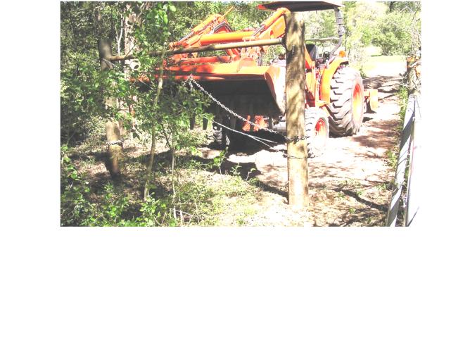

Apr 3, 2005 / FEL - installing wider gate #1 txdon Super Star Member Joined Jul 23, 2003 Messages 17,137 Location Central Texas Tractor Kubota M6H-101 The FEL worked great on this job. The object was to take out a 4' gate and put in an 8' gate. I had to move the H corner post over 4" I took the barbed wire off, grabbed some chains, and picked up the corner post H. Attachments 619915-hlifting2.jpg 57.2 KB · Views: 600

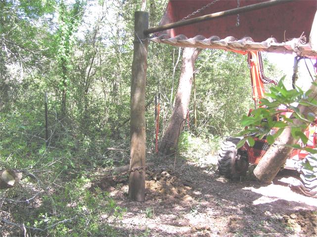

Apr 3, 2005 / FEL - installing wider gate Thread Starter #2 OP txdon Super Star Member Joined Jul 23, 2003 Messages 17,137 Location Central Texas Tractor Kubota M6H-101 The H came out and stayed together so I backed up and dug two holes 4' over. Attachments 619921-hout2.jpg 54.8 KB · Views: 423
Apr 3, 2005 / FEL - installing wider gate Thread Starter #3 OP txdon Super Star Member Joined Jul 23, 2003 Messages 17,137 Location Central Texas Tractor Kubota M6H-101 Then I set the post in the holes I dug. Attachments 619922-hin.jpg 92.5 KB · Views: 395
Apr 3, 2005 / FEL - installing wider gate Thread Starter #4 OP txdon Super Star Member Joined Jul 23, 2003 Messages 17,137 Location Central Texas Tractor Kubota M6H-101 I used the FEL to straighten then up and then tamped them tight. Attachments 619924-hstraight2.jpg 79.3 KB · Views: 355

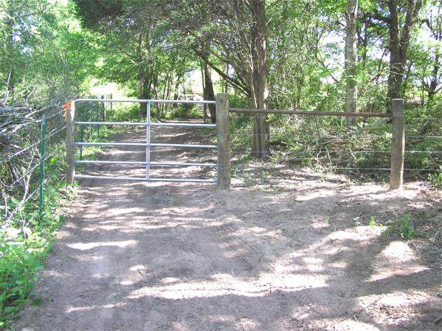

Apr 3, 2005 / FEL - installing wider gate Thread Starter #5 OP txdon Super Star Member Joined Jul 23, 2003 Messages 17,137 Location Central Texas Tractor Kubota M6H-101 I then put the barbed wires back on and installed the new gate. The FEL made this a quick half morning job. /forums/images/graemlins/smile.gif Attachments 619928-hfinish.jpg 97.4 KB · Views: 345
