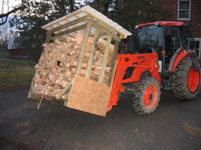

dont know how much this oak firewood weighs but from the looks of the front tires it is very heavy. Had to rev up the engine for the hydraulics to even lift it
i think that's a bit more than a bucket full :D :D
I think I can see a little daylight under those rear wheels. :D
/ FEL hydraulics overload question #15
No the rear tires had good traction so no problem there. They are loaded and now yesterday I mounted a 2000 lbs ballast box on the three point. That is just so amazing how much that helps. Pushed over a large tree yesterday with no wheel spin at all.
