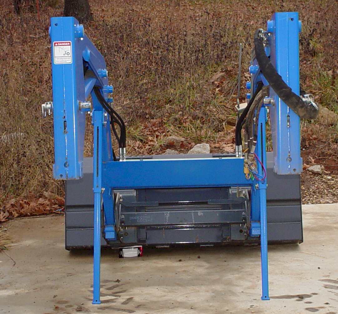

Jim,
Here is a shot of my loader removed so I can run the blade.
Note no controls on the loader.
Also here is a link to thread about the same type of setup on a compact tractor.
<A target="_blank" HREF=http://www.tractorbynet.com/cgi-bin/compact/showflat.pl?Cat=&Board=nhown&Number=221755&page=0&view=collapsed&sb=5&o=&fpart=1#Post227946>http://www.tractorbynet.com/cgi-bin/compact/showflat.pl?Cat=&Board=nhown&Number=221755&page=0&view=collapsed&sb=5&o=&fpart=1#Post227946</A>
