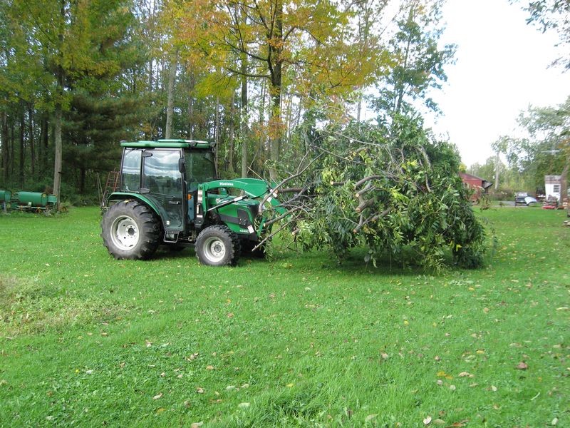

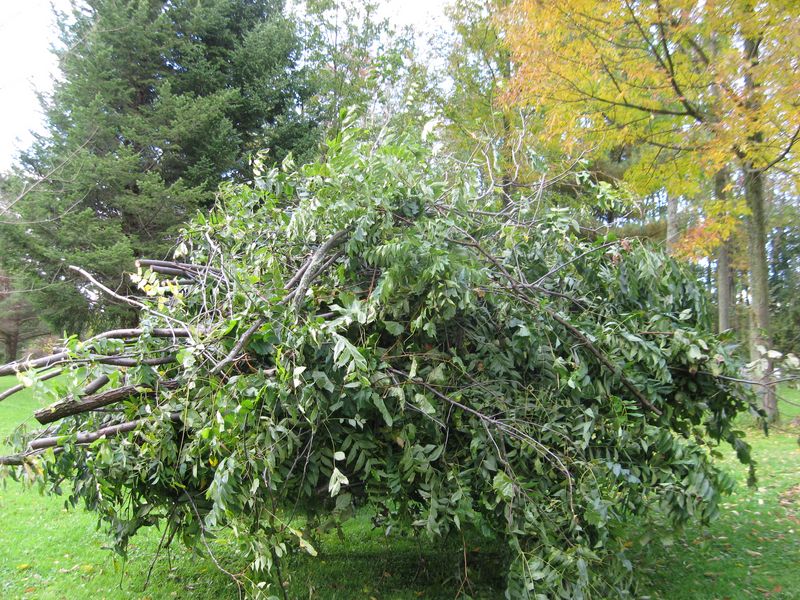

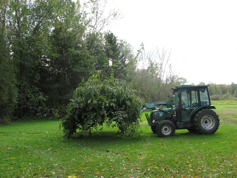

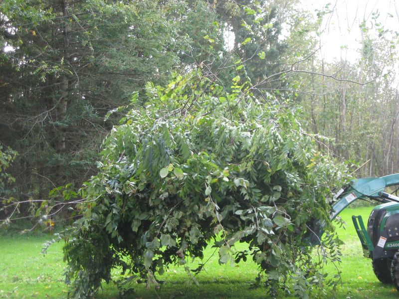

I think I would still get a regular set of forks. I have moved alot of brush and other things with my forks. They are more versitile than manure forks.
In the pictures I did not stack the brush on the forks, I just drove into the pile and picked it up. As much as I want a grapple I can get by with just the forks.
