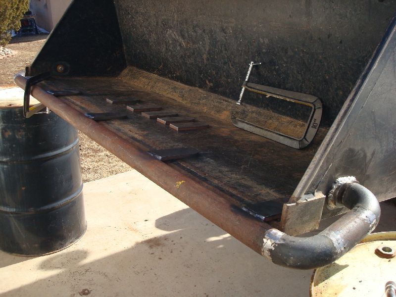

Not sure what the correct technical term for this thing is, but I've been wanting one for a while and finally built one.
It's purpose is to keep the cutting edge from digging in and tearing things up when using the FEL bucket as a snow plow. I've seen a few here on TBN and was inspired by this thread: Phil's Cutting Edge thingie
My impression is the ones made of PVC or ABS can self destruct within seconds or wear out in less than a season. I like the ones made of steel pipe and decided to use 1.5" schedule 40 black pipe, mostly because that's what I had in my scrap pile to work with. :D
I found some weld on 90* black pipe elbows from a pipe shop. The elbows are chamfered on the ends for welding sections together. I made some re-enforcement connectors to use between the sections of pipe for added strength. The slugs were cut from 3/8" plate with a hole saw. The slugs for mounting the ends were drilled and taped for 1/2" - 13 bolts.
I cut the tabs that keep the pipe centered on the cutting edge using a CNC plasma cutter. The centering tabs were evenly spaced, five on top and four on the bottom.
In Phill's thread that I linked to above, T_Man chimed in with his design which I adapted with one improvement:
Wrap the pipe ends 180* to attach to the bucket using the same holes for attaching the tooth bar. I think this in an improved design as there is less chance of snagging some object buried in the snow or when not paying attention working near fence lines.
A little bit of gold paint and some touch up for the grapple and BLING BLING! Two bolts and the whole thing effortlessly slides on and off.
I had a chance to use it pushing and back dragging some crusty snow on the north sides of my barn and it works better than expected.
Larry

Nice build, I didn't believe in the pipe on the bucket idea , but have been coming around since trying it a little.
No worries of plastic pipe breaking with yours, I like how it locks on the edge, with that way I think you could just have some type of quick pin to keep it in place. I would use that, but would want to be able to remove it quickly once I got out of the soft ground.

Thanks for the comeback guys, much appreciated. This was a simple weekend build which gave me an excuse to get my welding "fix" this winter. Next snow perhaps I should post a few action shots? and a few to see how it holds up.

Good fabrication and as usual for you great documentation of the project. Just today I looked through you dump trailer build thread. That grapple turned out good too.

Wow- gives us "would-be" ("wanna-be"?) welders something to aspire to!
So that entire thing comes off/goes on with just two bolts? Very slick design!
I really like the way you've got those built-in reinforcements on the sides of the bucket. (I've wondered if drilling & bolting into bucket sheetmetal wasn't asking for stress/bending trouble later on....)

Nice job! I new when I posted my design someone would improve on it.When you said "it works better than expected".Thats exactly what I said the first time I used it.I'm on my second season using it,and there is no sign of wear on the pipe yet. Tim
