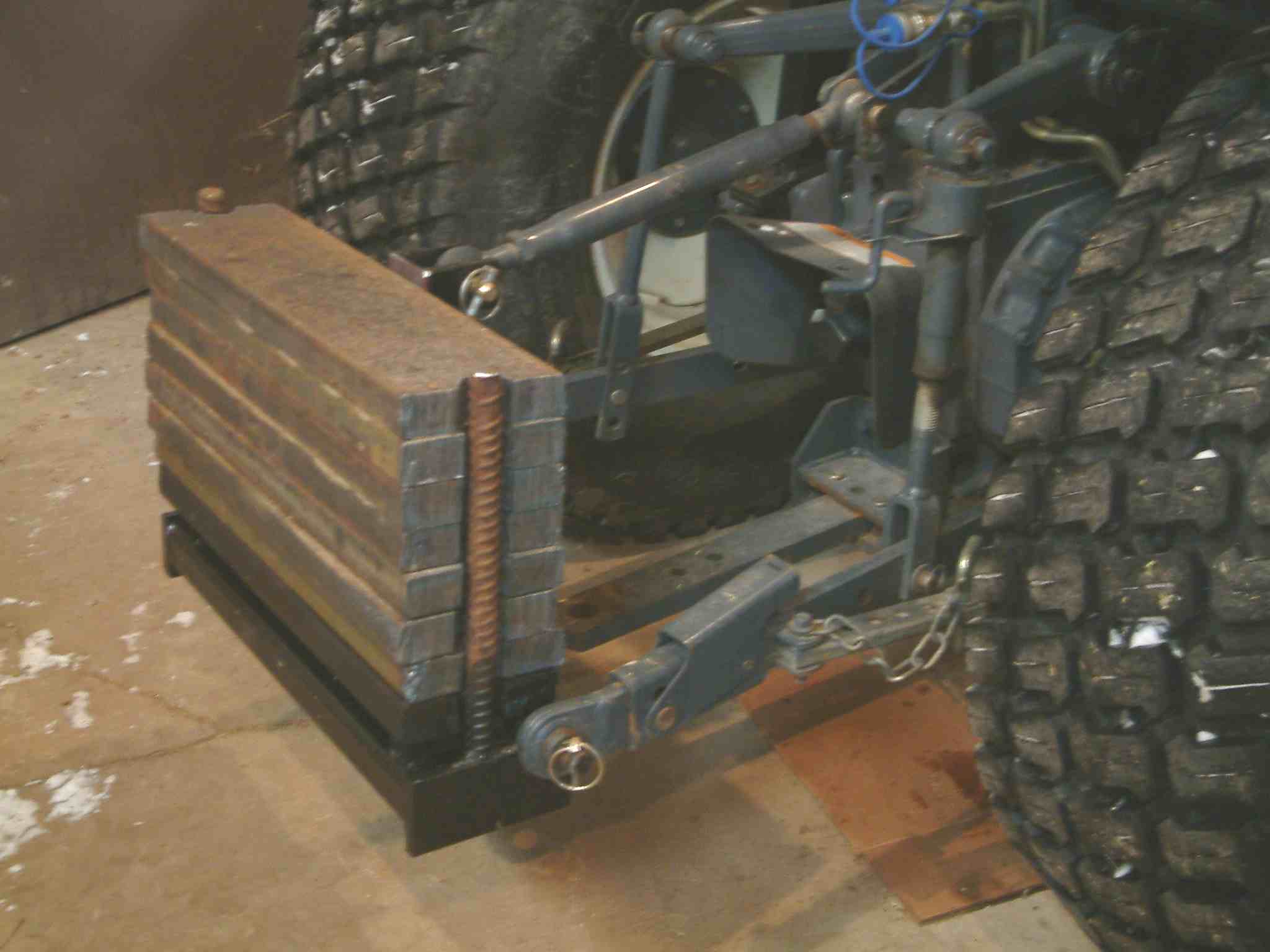

Find attached home-made weights to provide some ballast when doing FEL work. It was high time seeing I have had the tractor now for 11 months. Boy does it make a difference. FEL operation is much smoother & now I can push / plow the snow. I was hoping to go with wheel weights but the wheels for NH turf tires do not accept weights. As much as I would like to take credit for fabing this weight system up it was done by a retired tractor mechanic. My hats off to him for doing a great job & making my tractoring that much more enjoyable.

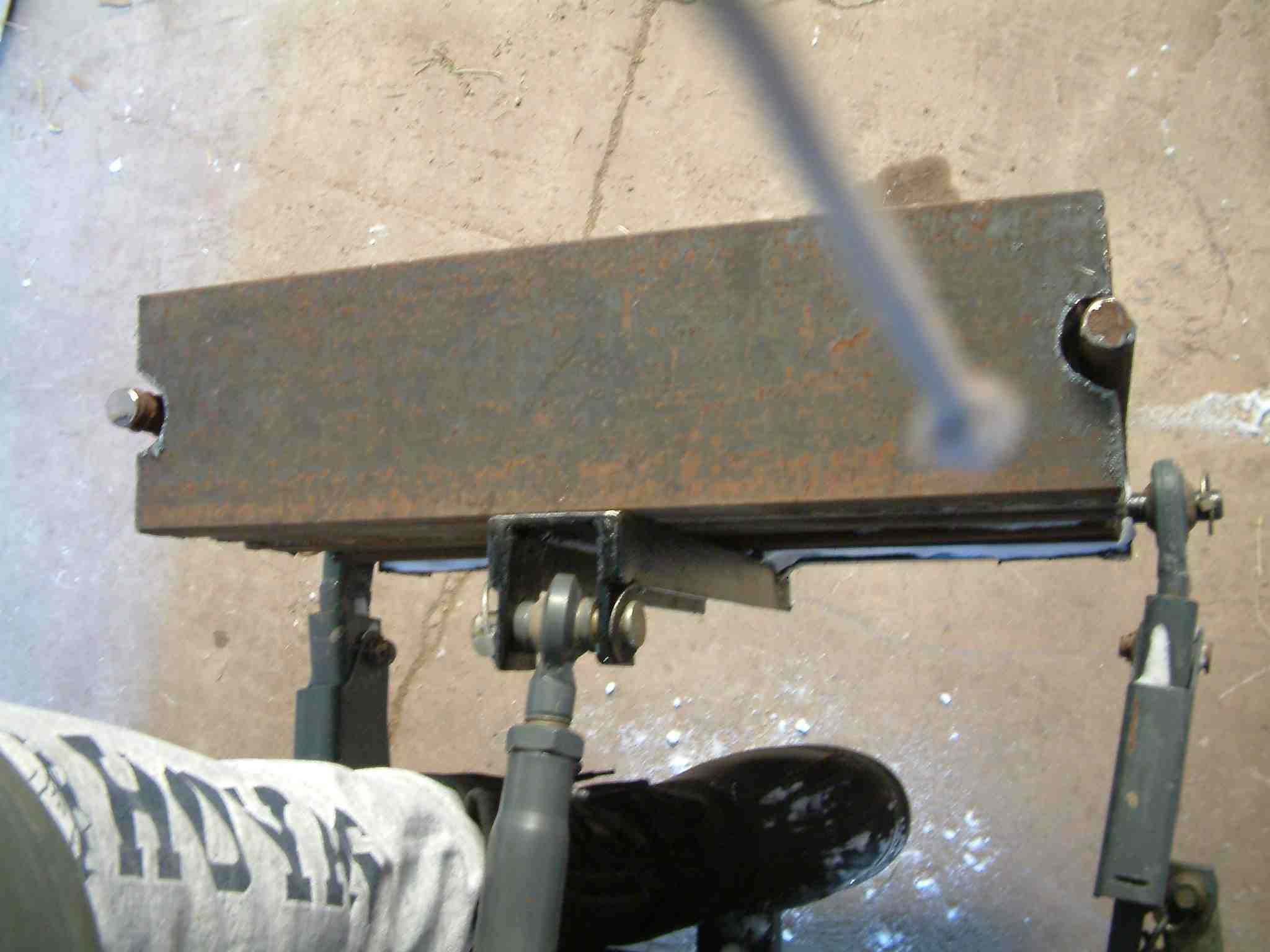

Following are the specs.
- 8 removable plates weighing approx. 50 lbs each, 22-5/8" L x 6"W x 1-1/2" thick.
- Bottom holding plate 24"L x 6"W x 2-1/2" thick
- 3"W x 1-1/2" C-Channel 16-1/4"L x 1/4" thick
- 7/8" diameter x 29"L rod for attaching bottom two hitch arms
- Two 3"L x 2"W (5/16" thick) plates welded to top inside of C-Channel for attaching top hitch arm
- 4"L x 3/4" dia. pin to attach top arm to plates on C-Channel
- 1/2" rebar to keep plates in place. Steel plates are notched to allow rebar to support & keep plates in place.

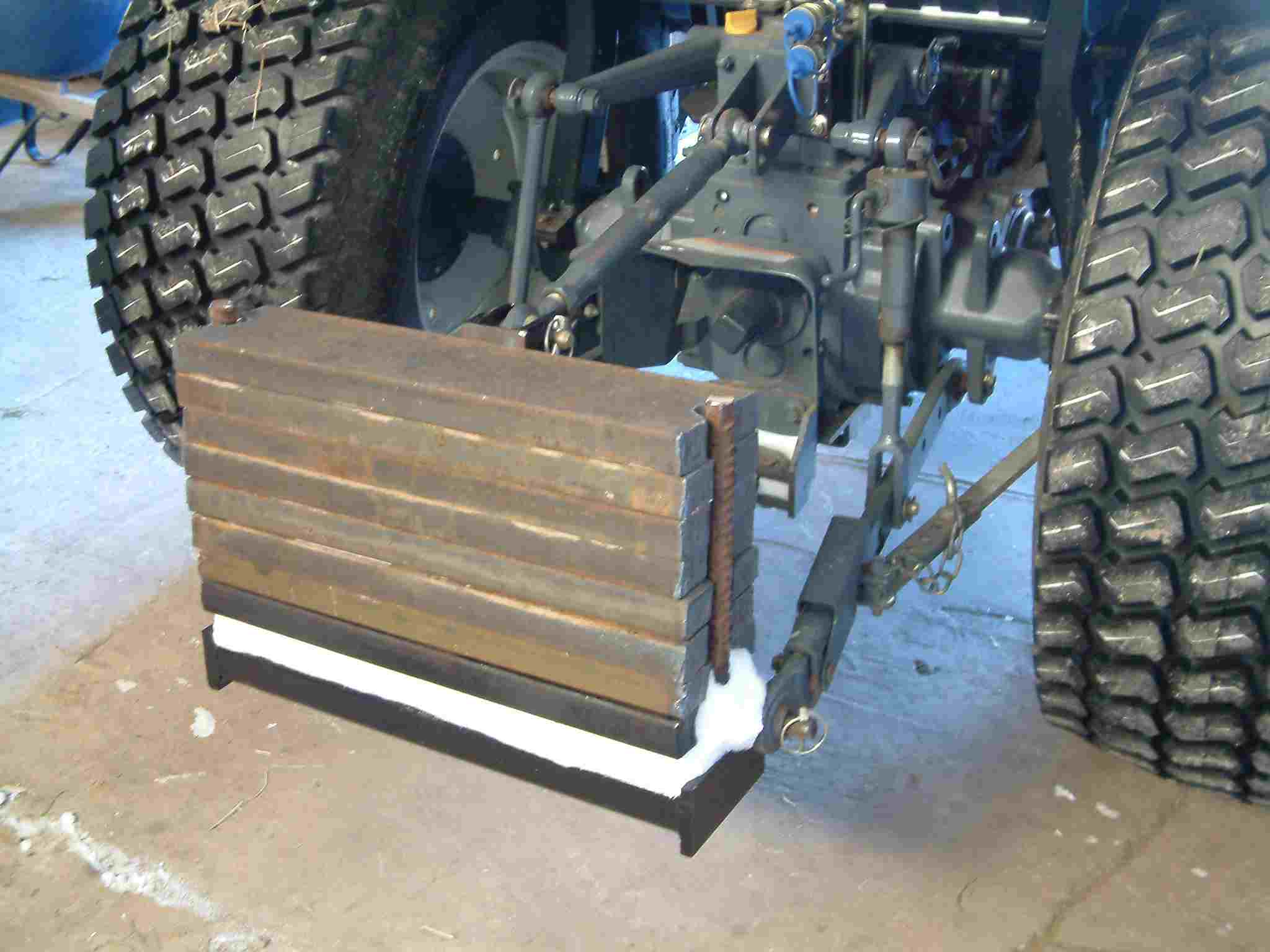

When I first saw this design I liked it since I can add weight or remove it as needed. The total weight is approximately 510 Lbs. It almost seems as I gave the tractor a HP boost. JUst goes through anything now with TURF tires.

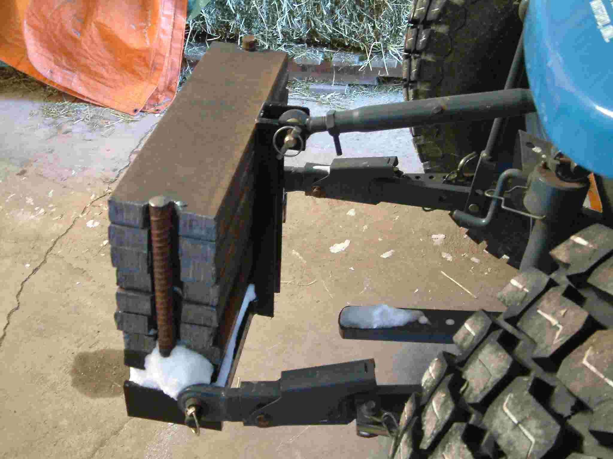

One last pic.
Going to paint it up this summer. Should look nice painted black.

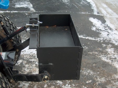

Nice job and I know the need to have weight in the rear.
This is the one I made for mine
