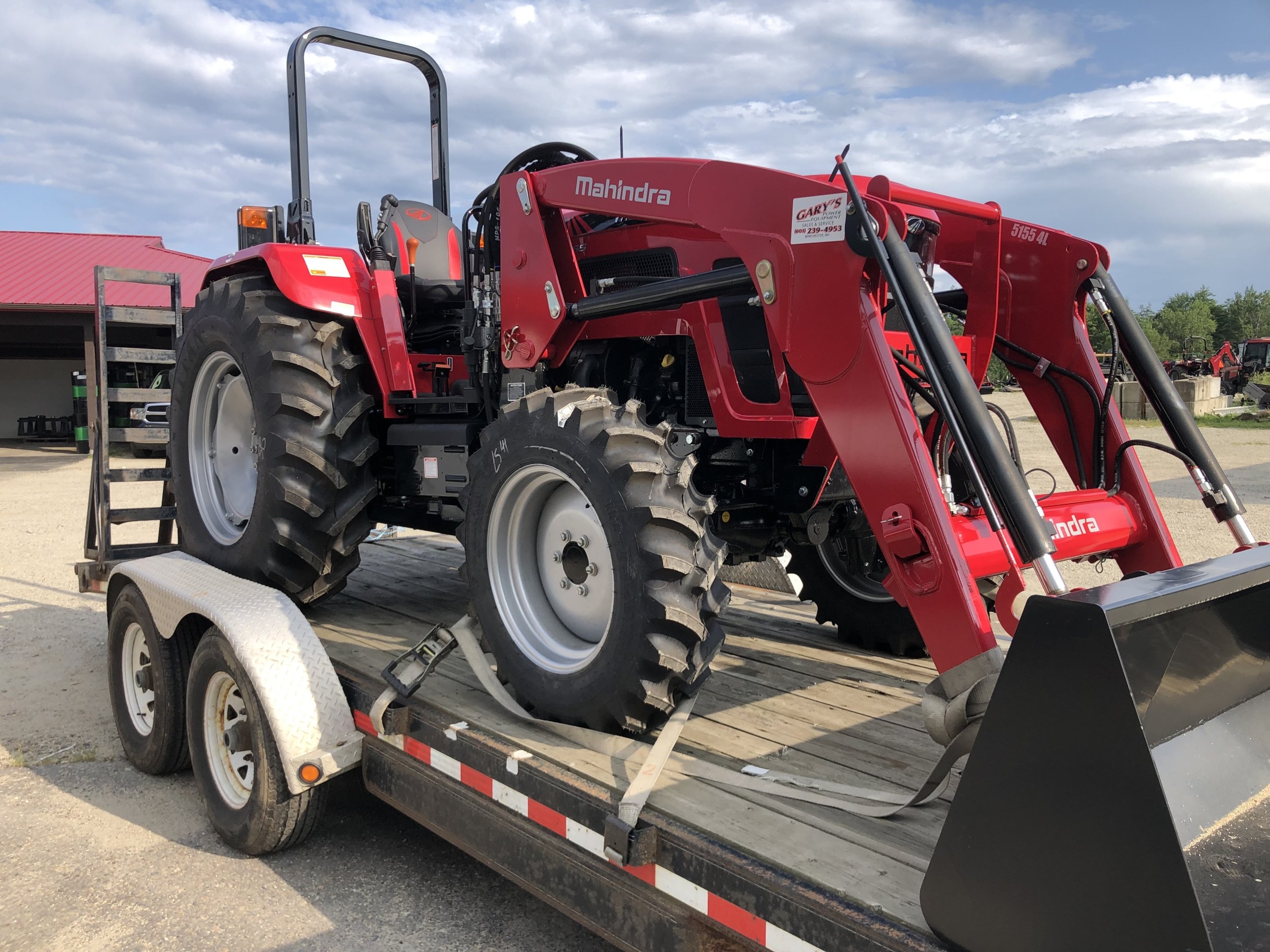

I just got my 5155 about 5 weeks ago 7/31/23. The diverter valve was installed and at pick up the tech told me it was the first of the new style controls where buttons are forward and back vs top and bottom. That really takes some getting used to because I’ve also have a cab Kubota 6040HDC I bought in 09 and the 3rd fx buttons are top and bottom. I have to be really cautious of that when unloading and feeding out 1100 lb silage bales. Hate to drop one on something that doesn’t need to be broken 🤷🏻‍♂️
