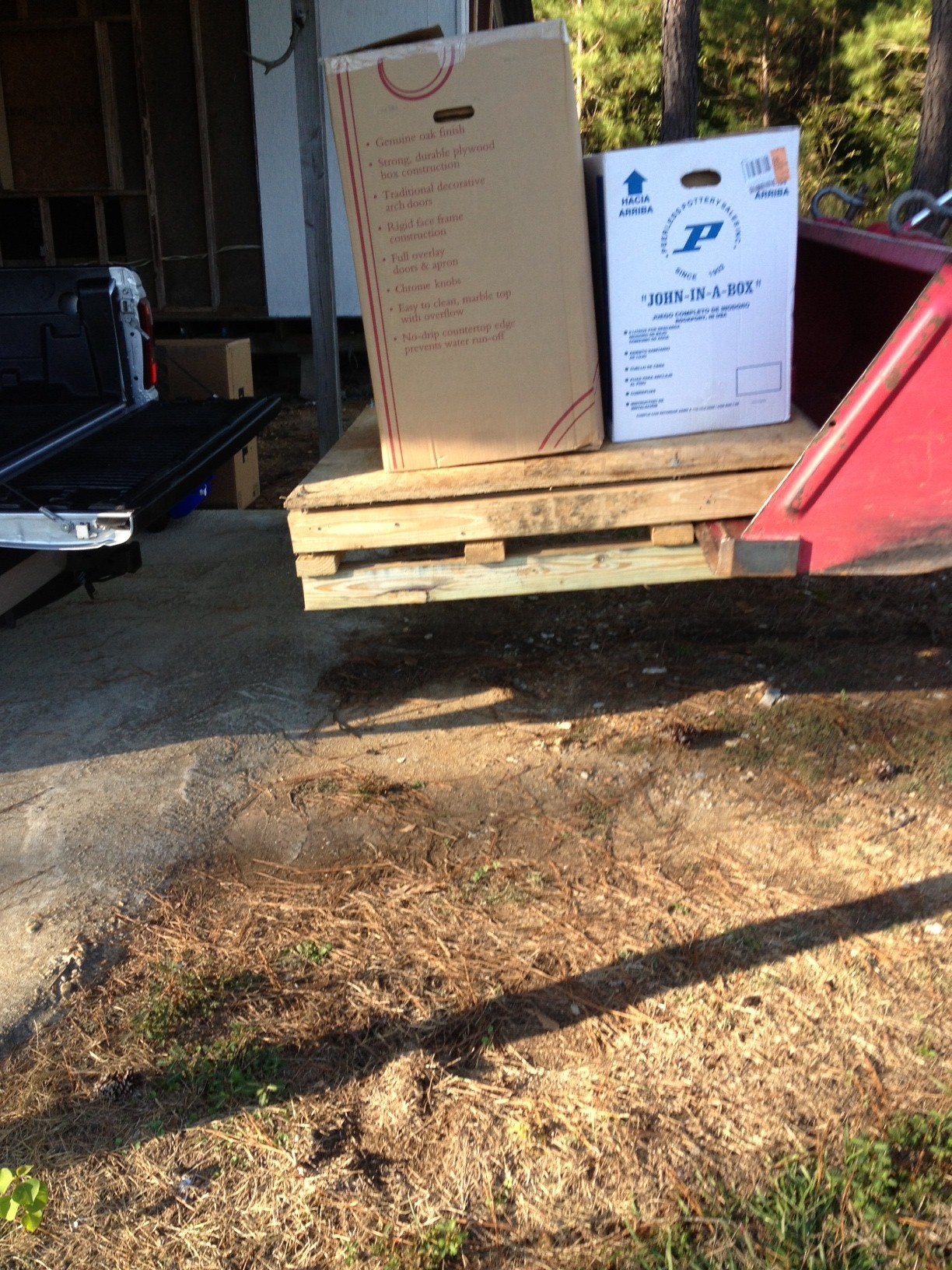

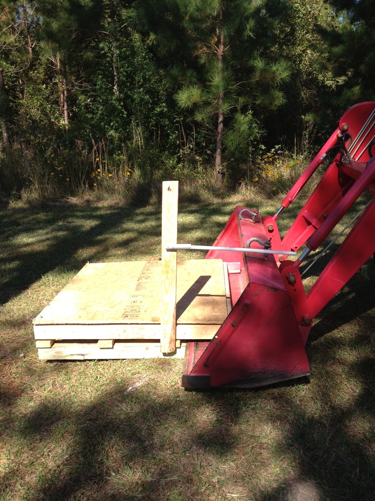

I wanted to repost the link with the Fel Carryall plans that red dirt posted in 2008. I had touble pasting
the link (don't know why) . Anyway if you do a search on Fel Carryall it should pop up. I just finished mine
a couple of weeks ago and just love it. I used his plans with only minor modifications. However, If I had it to do over I would not even use a pallet as a base (too many nails - I broke a bit). I think taking some 2X4's and just using the 3/4 inch osb would make a better platform. THen add the spacers and skids. I could not find any metal for shoes but will keep looking. However, with the addition of the "feeler arm" (pvc) I have not had any problems picking it up.
