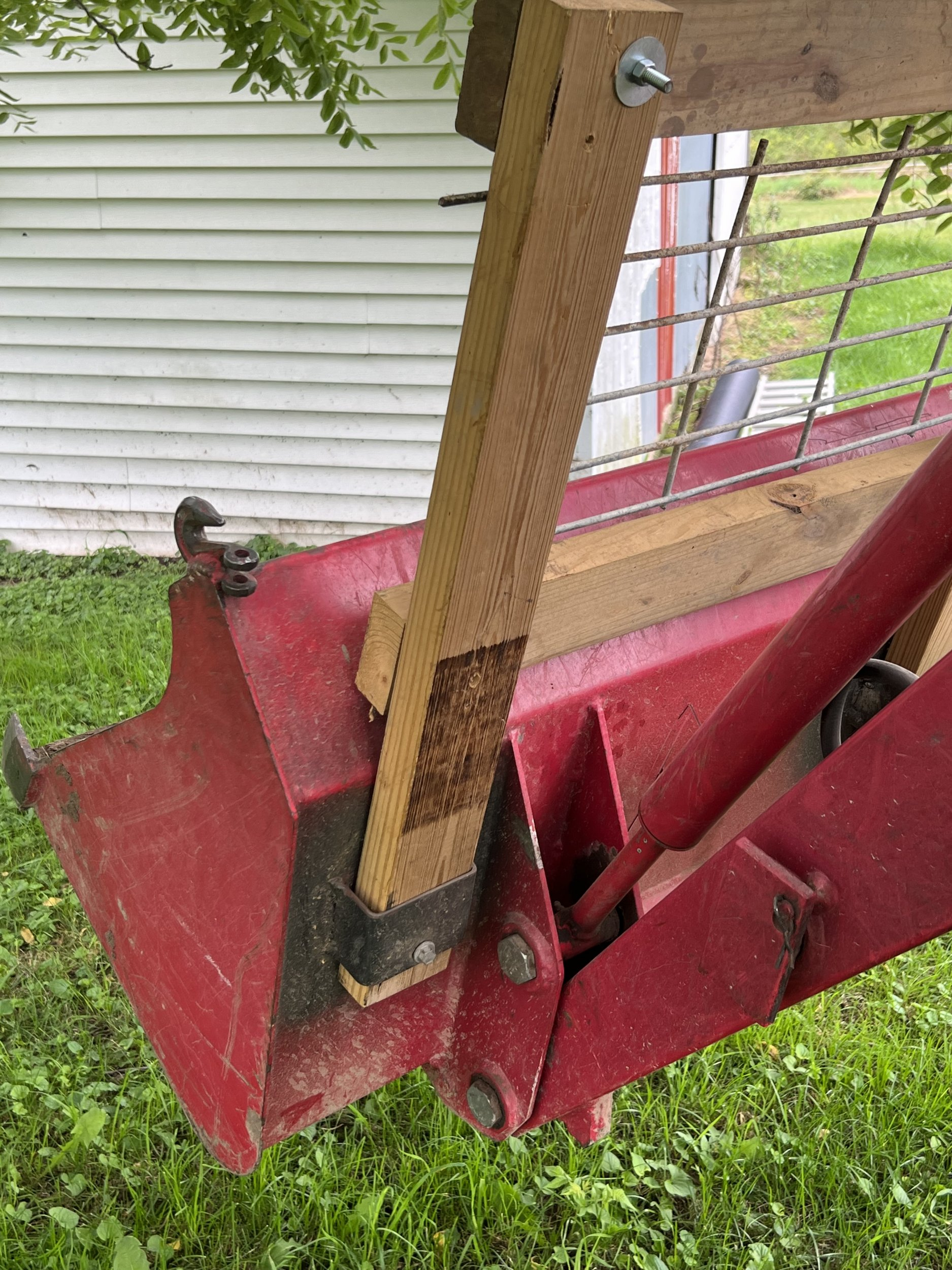

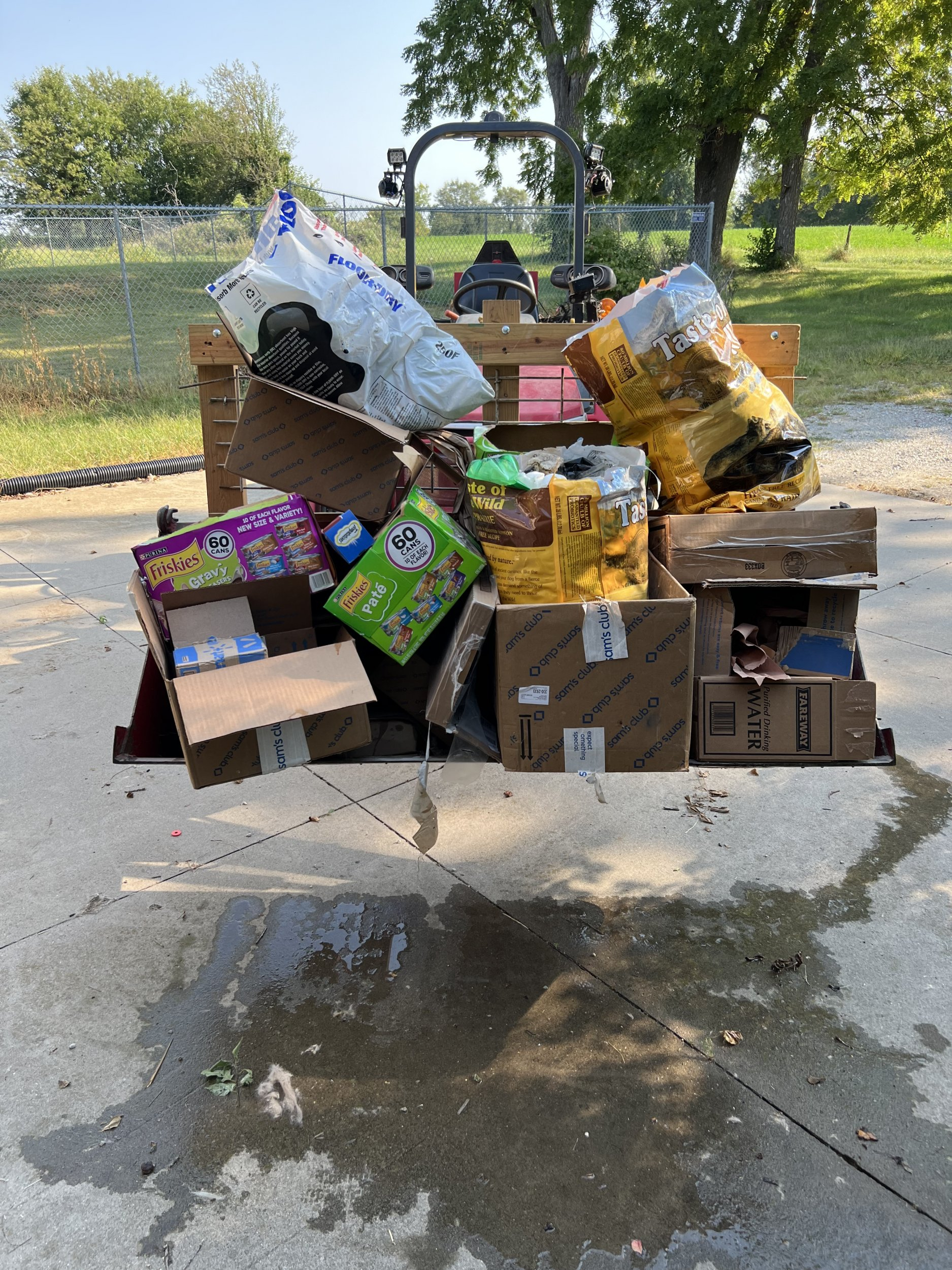

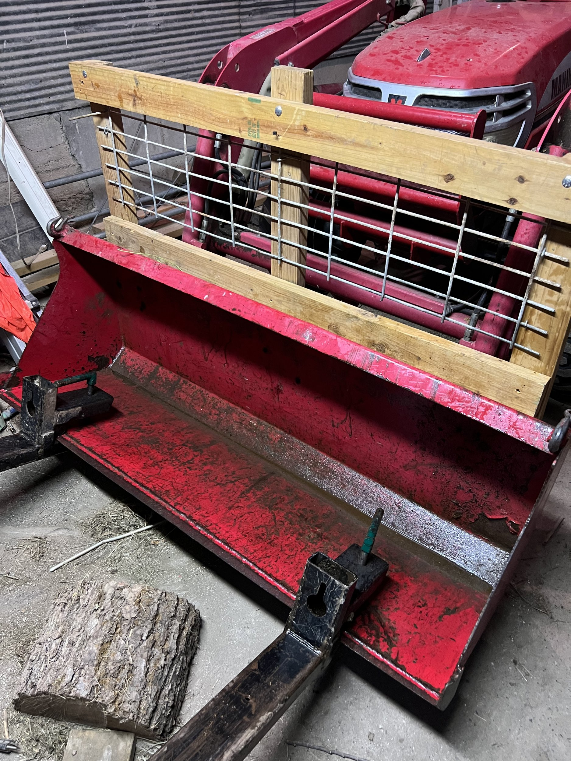

Always had issue with size of bucket and what I could load into it and also protect the hood. So I when online at Home Depot and ordered three Curt weld on stale pockets and welded them to the backside of the bucket. Fabricating a guard that can be removed when not needed out of 2x4’s and some old cattle fence. Going to add some brackets and straps to the back side so I can carry tools.View attachment 765787
Now that's Just super spiffy~!!
