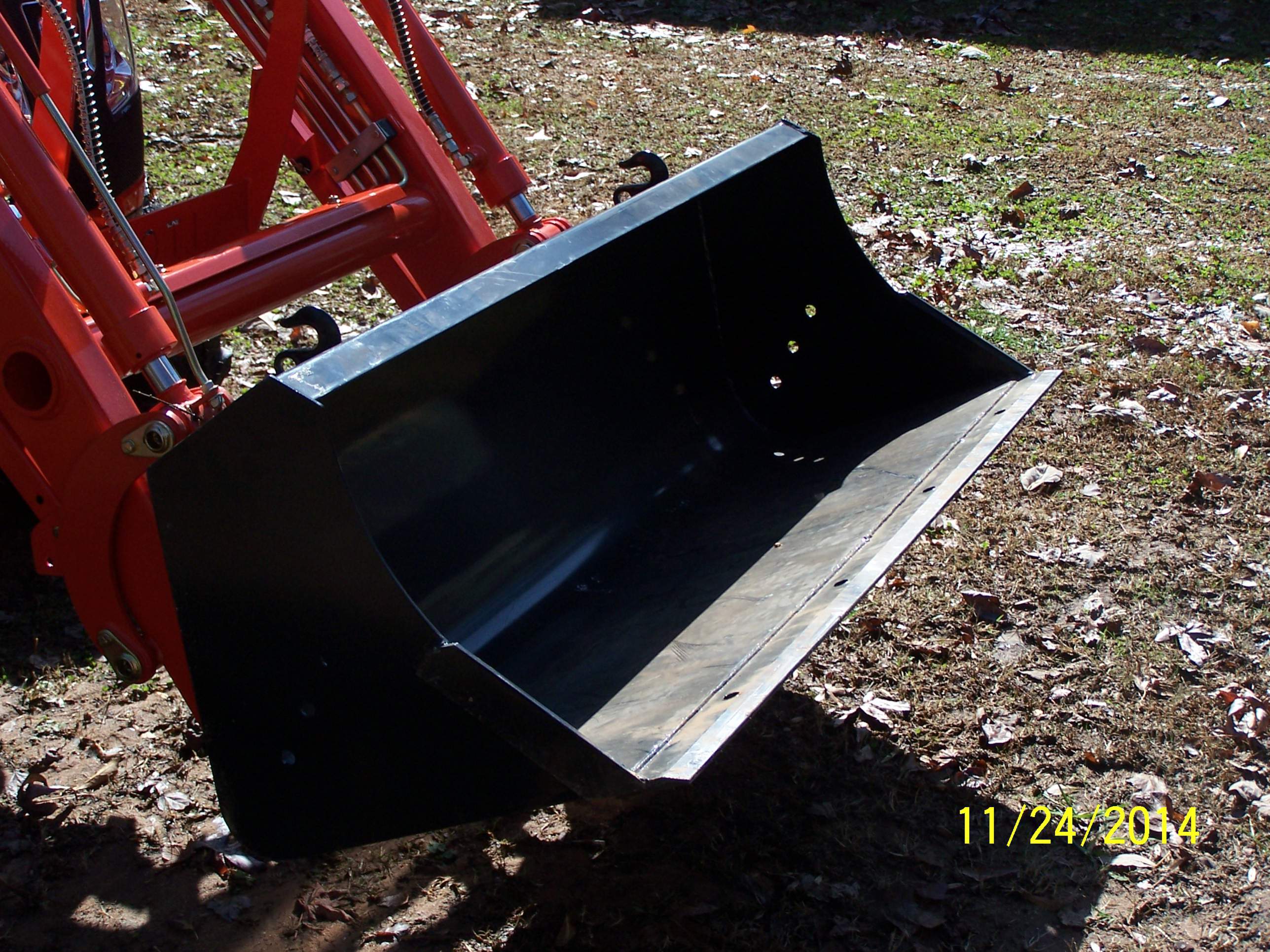

You'll have to judge for yourself what combo that you think you'd like. In reviewing bucket hooks, you'll find every possible combination of weld on, bolt on and placement of 5/16, 3/8 hooks, and clevises. I just have the two 5/16'' bolt on that are placed in line with the cylinders. But using rope or straps could make clevises more handy at times. The decision could involved the size of your tractor and the work that you anticipate doing.

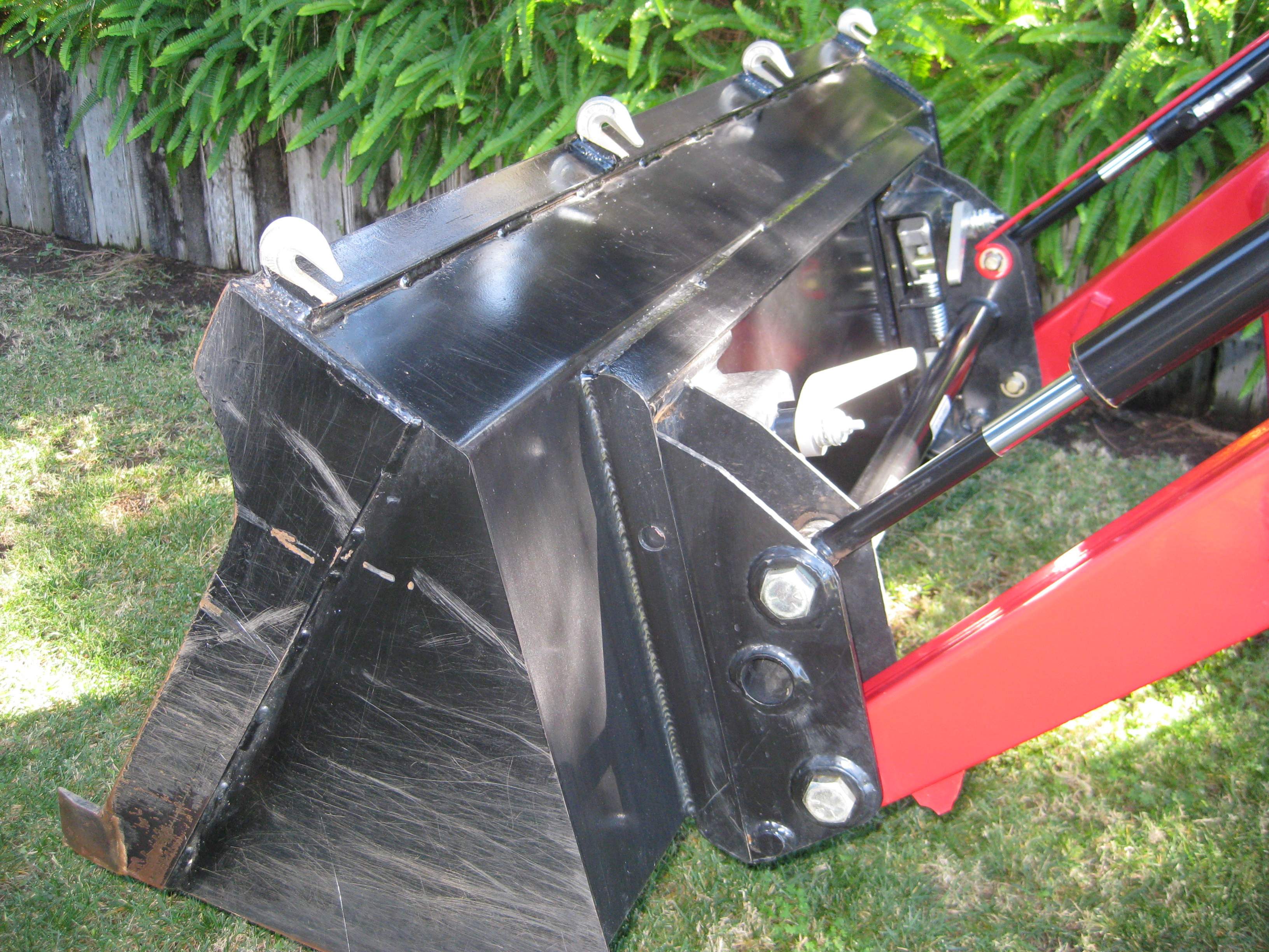

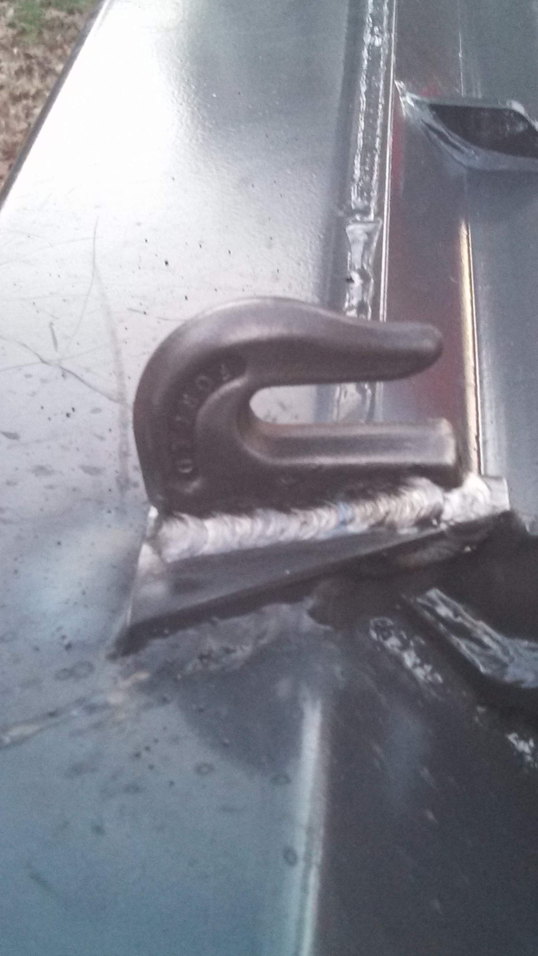

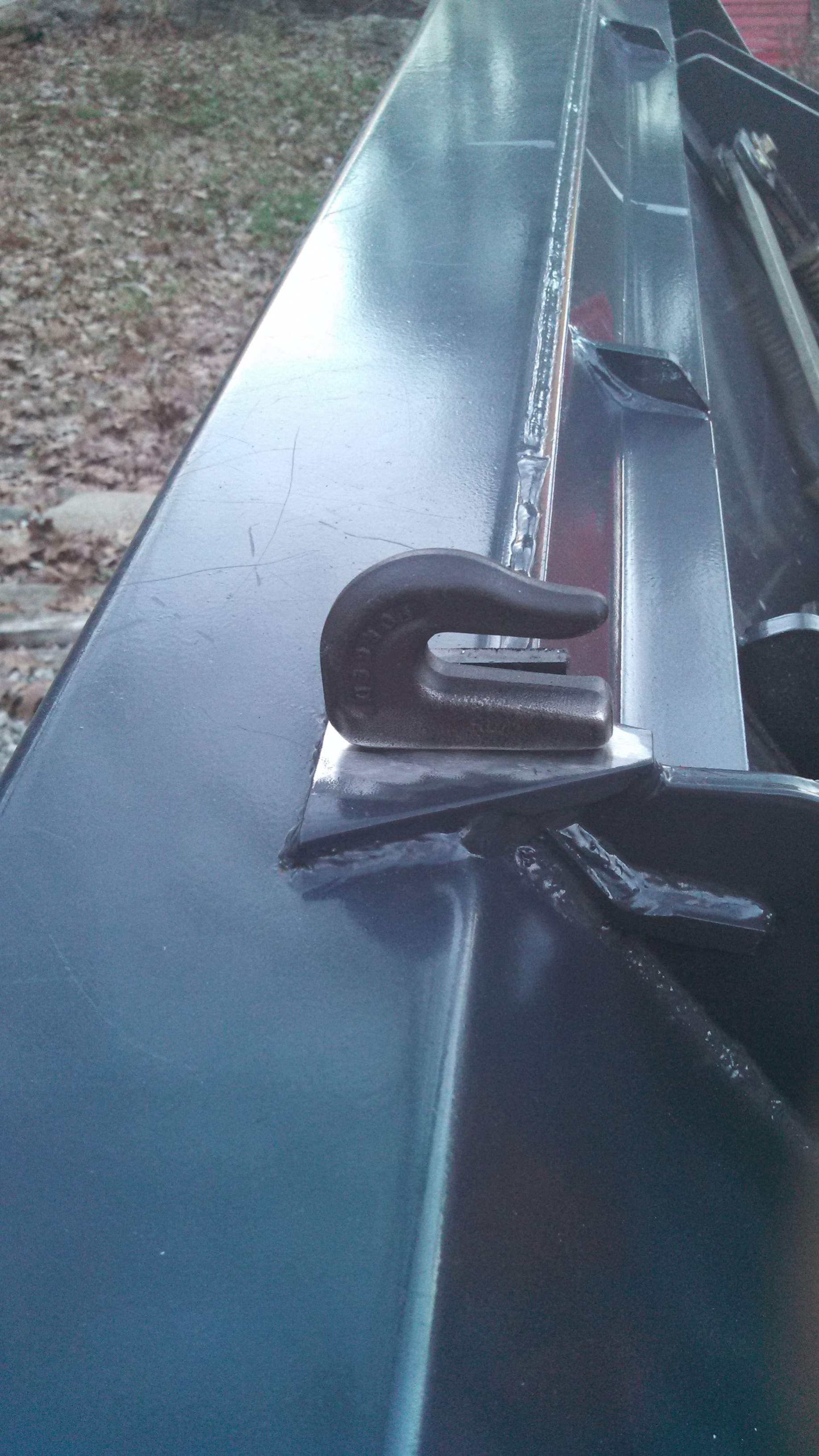

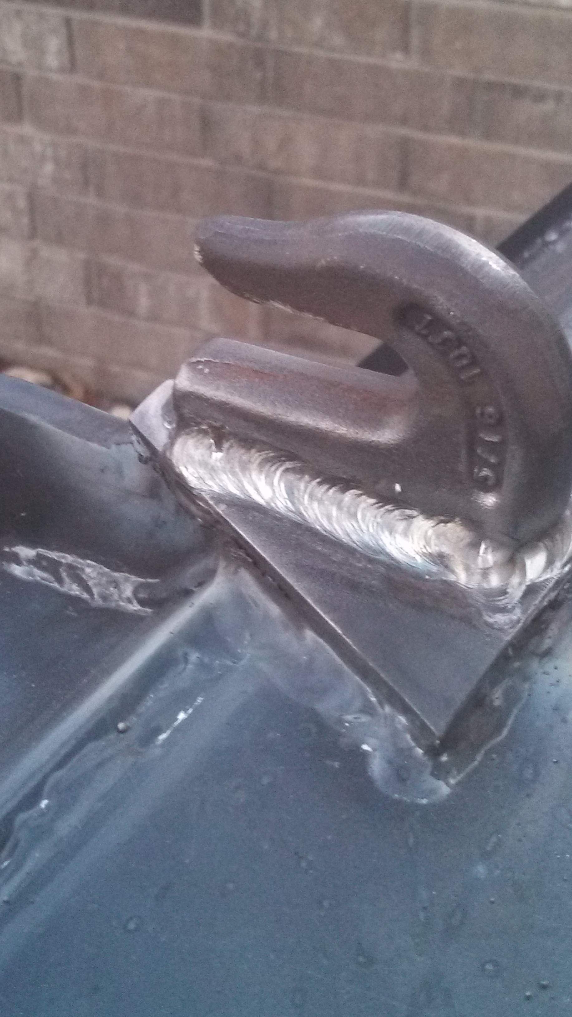

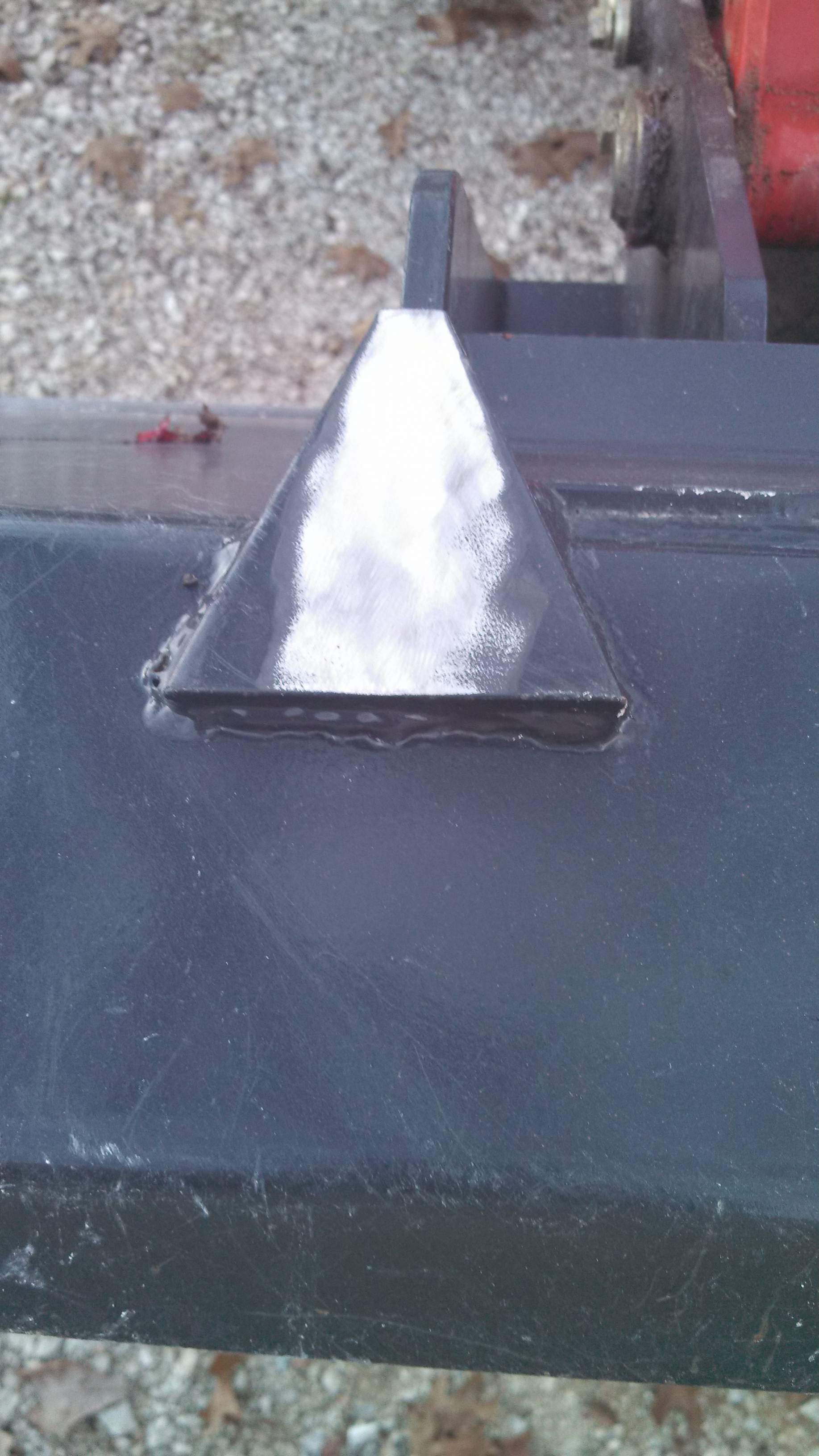

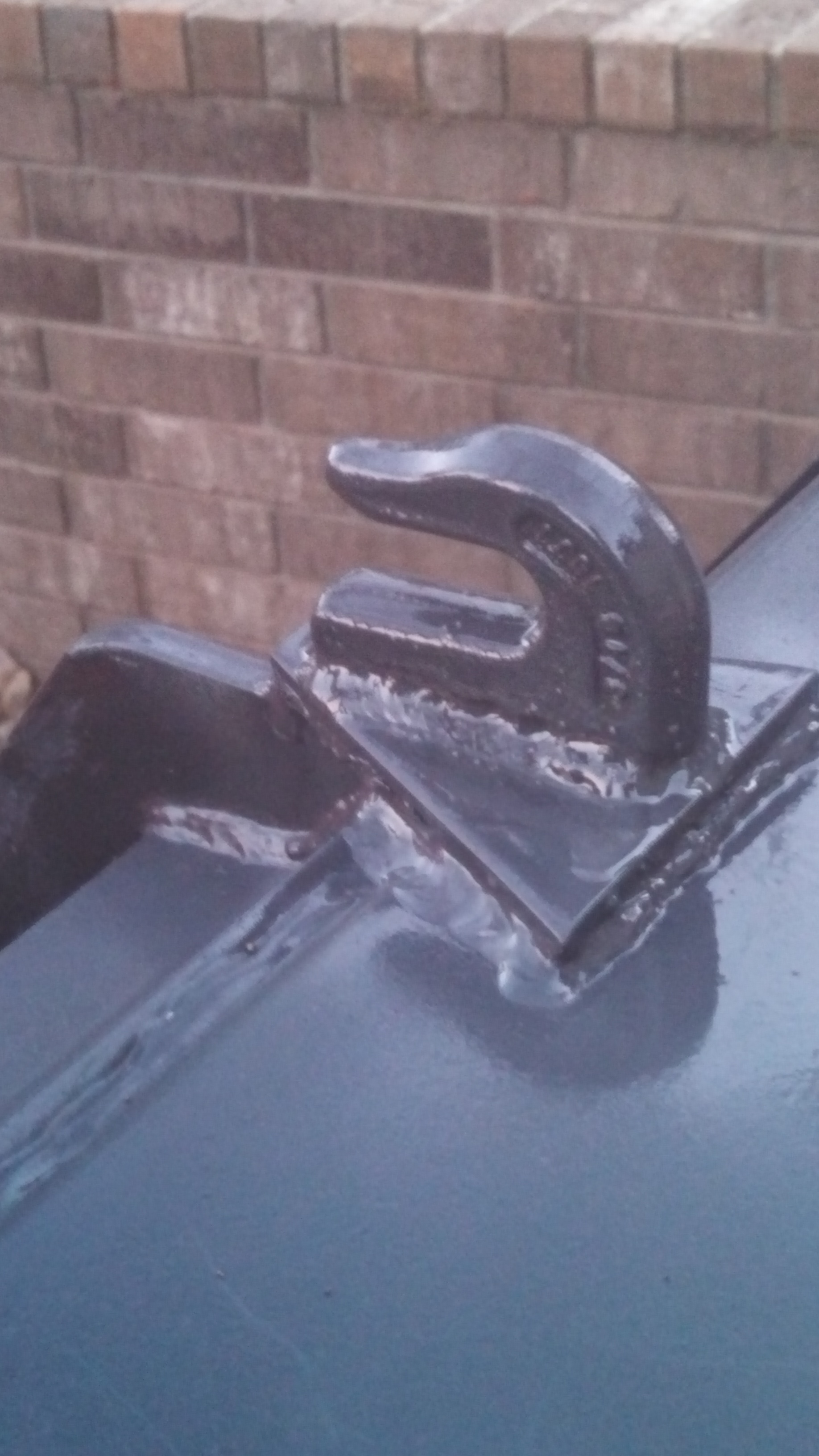

This pretty sums up what I have except my 2 hooks are 5/16 weld on in line with the cylinders. I have thought about putting a 2 inch receiver hitch in the center and beef up under it. But I havent done it yet. This way you could stick what ever you want in the 2 inch receiver, including a boom pole etc.
IMG_20121117_170314_242.jpgIMG_20121117_165314_192.jpgIMG_20121117_165303_772.jpgIMG_20121117_164305_653.jpgIMG_20121117_162438_547.jpgIMG_20121117_162424_854.jpg

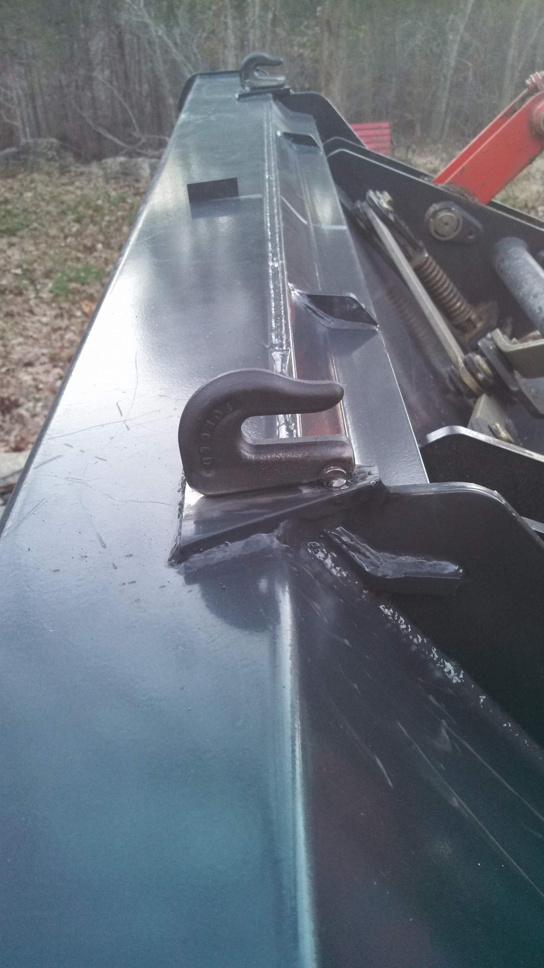

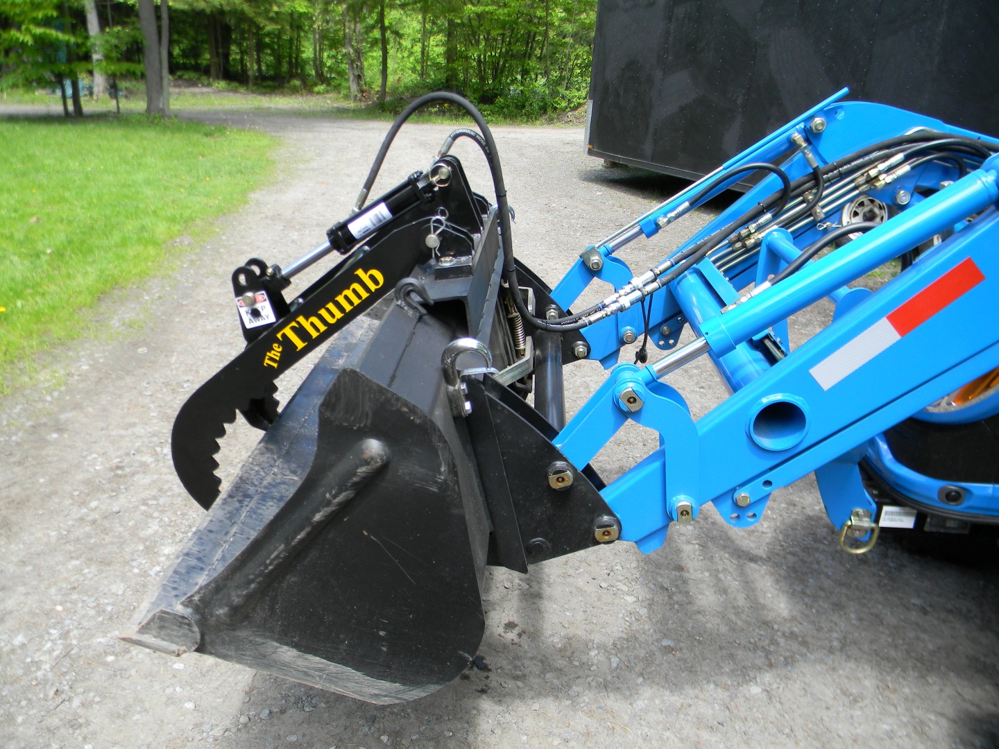

I started by adding a 2"x2" angle to the top edge for additional strength. Then welded on 2 hooks in line with the cylinders.
I bolted on a couple hooks that can be used with rope or chain. Then added a hydraulic thumb.
A receiver hitch in the middle would be nice if you need to move trailers around or put a clevis hitch into.

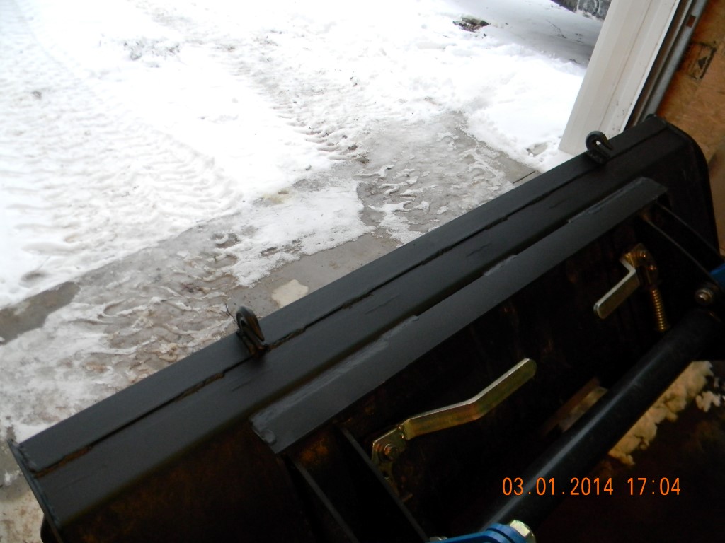

100_9659.jpg The dealer put this style hooks on my tractor.When I went to get the tractor I was expecting grab hooks, but with this style I can use straps,ratchet straps, rope & chains!

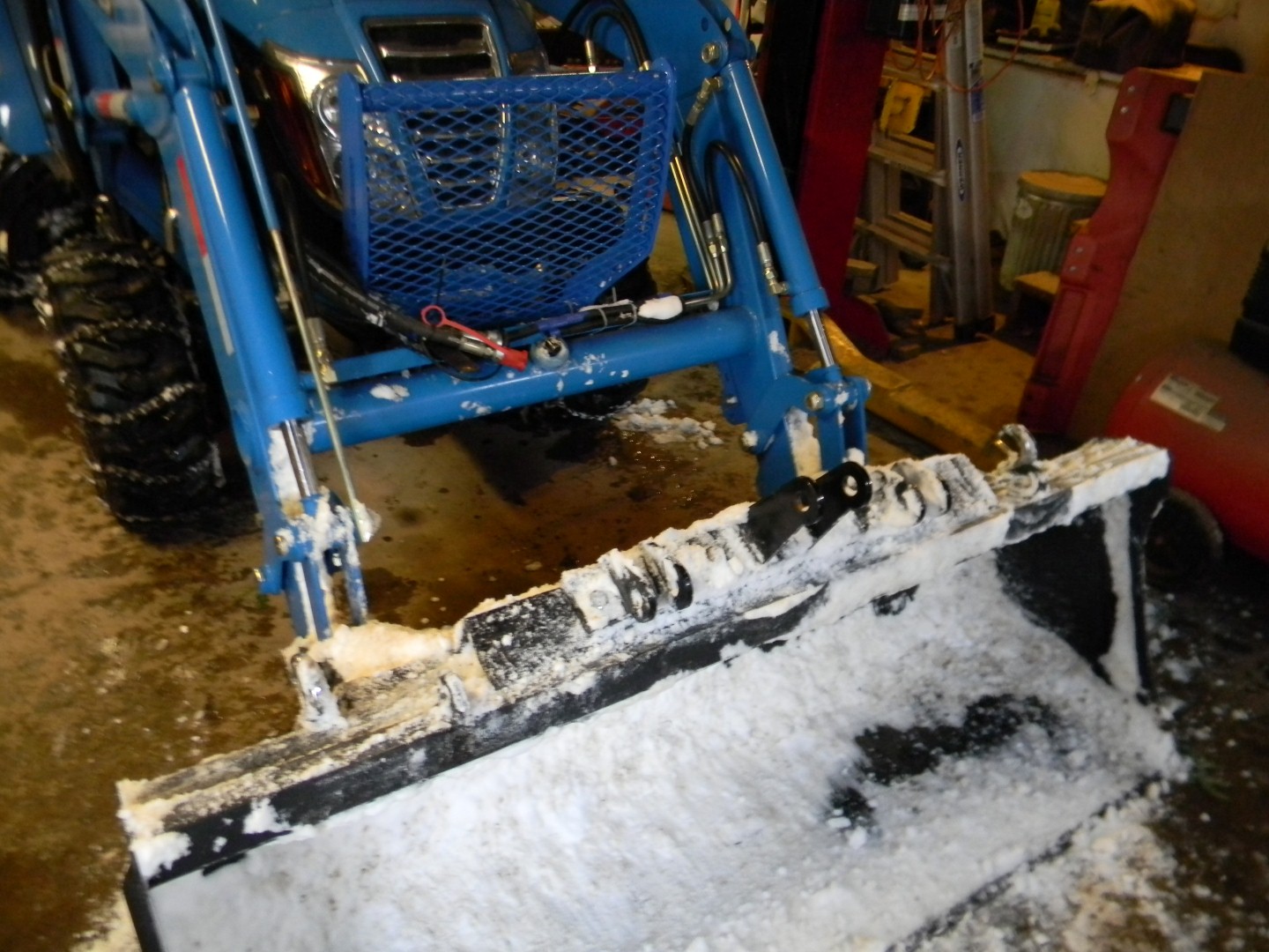

Lots of variables, but having the chain lined up properly with what you are lifting sure helps from things moving around. I also added full length 3/8" angle at the tops of both of my buckets as well as 3/8" flat bar on the sides.

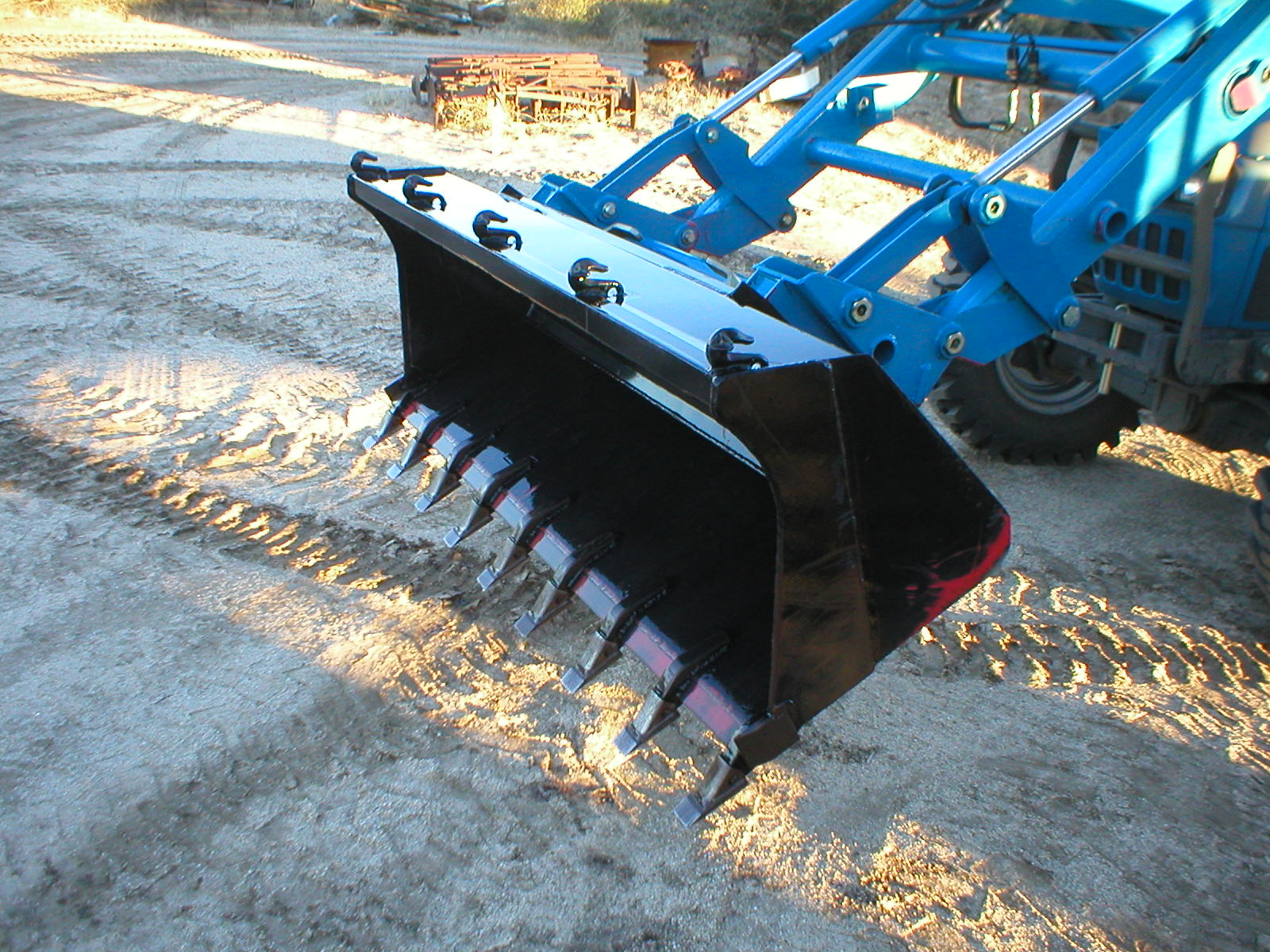

I prefer chain slots because you can use the chain front or back.
Over the back of the bucket gives more lifting power. If you put the middle of the chain in the slot you get two chains hanging down, one in front, one over the back, to attach to whatever you are picking up.
