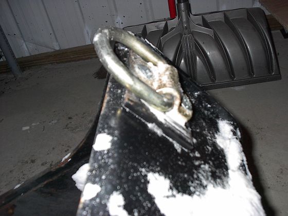

There really isn't any rule of thumb as to what and where you attach something to your FEL. I used D-Rings and am very satisfied with the performance.

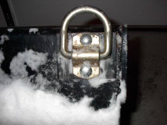

   / FEL Bucket Hook Questions... #3
2

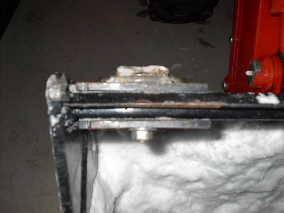

   / FEL Bucket Hook Questions... #4
3

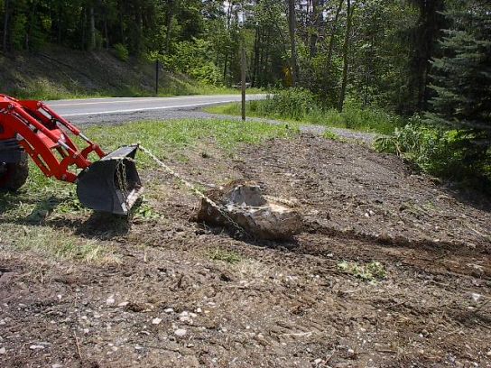

   / FEL Bucket Hook Questions... #5
In action.
