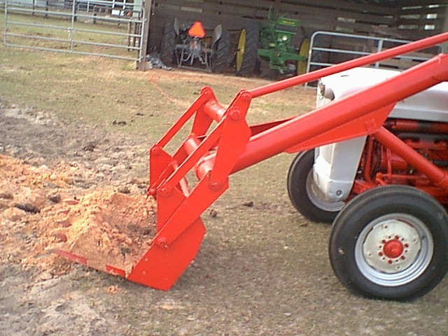

If by 'few years'.. you mean about 50.. then yeah.. here is a pic of my 55 ford 660 with ford 722 1-arm loader...

not EXACTLY the same FEL design ;)
/ FEL bucket attachment #7
Not the same fel design.. however.. since we were talking about the method of curling, that is.. direct bucket attachment.. or attached thru scissor bars.. well then.. As you can see.. back in the 50's the scissor bar setup was used.. so it's not like it was some 'new' idea in the last few years..
That's what i was trying to illustrate.
Soundguy
