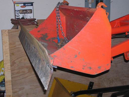

Before the snow flies, I want to build a blade to attach to my fel. It seems to me that about a year ago someone here had a series of post that showed the progression of his blade building project. I cannot seem to find it and am wondering if anyone knows remembers that and can point me in the right direction.
   / FEL Blade Building #2
Not sure this is the one you mentioned, but I built one to smooth out some dirt. Pic shows how it attaches, which is two 1/2 inch bolts.
The blade is 6 feet of 3/8 x 4" strap, so it is about 8" tall. So far, it has held up well. If we some snow this winter, I'll probably use it for the driveways. (we usually don't get much snow). Mine doesn't have a way to swivel, which would make it better to push snow.
Hope this helps.
Ron

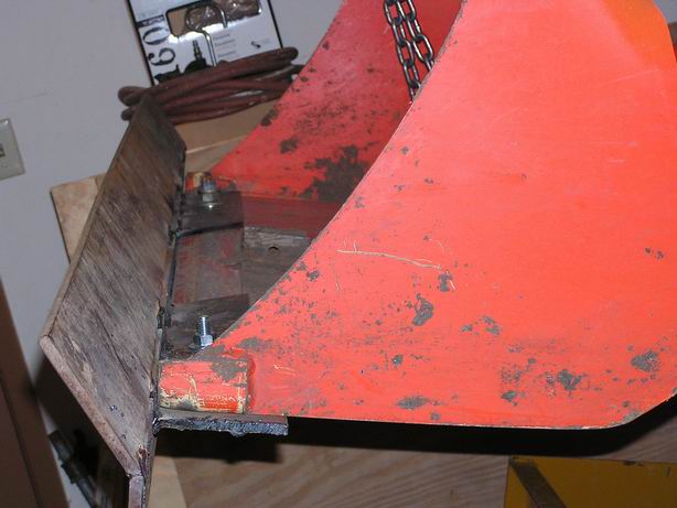

A better pic of how it attaches.
ron
