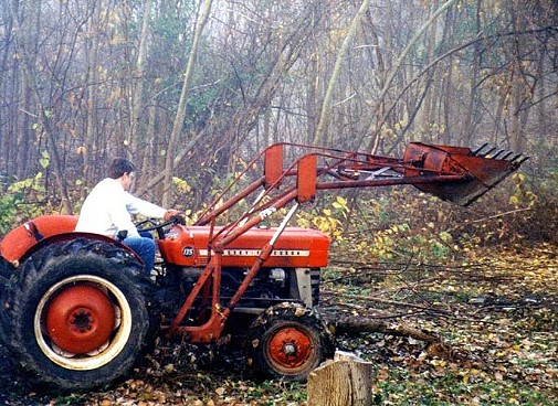

The good news - You can pick up a trip-loader at most auctions very cheap… ~~$50- couple hundred dollars… complete!
The bad news – the TO20 and most older tractors weren’t designed for real loader usage with 1) very weak front axles and spindles, 2) no hydraulic horsepower to properly run externally hydraulic devices (most ~ 4 ½ gpm & < 1500-1900 psi)
Now, with that said, if used properly, the trip-loader can be very useful if you realize all the limitations… excellent for brush hogging purposes & giant portable wheel barrel type carry of loads…
(a picture of my MF135 with very similar front-end and trip-loader)

</font><font color="blue" class="small">( 1) very weak front axles and spindles, )</font>
Actually the front axle's of the N's and fergies were very robust.. very nice thick overlaping cast plates... Spindles are of course the weak link.
</font><font color="blue" class="small">( hydraulic devices (most ~ 4 ½ gpm & < 1500-1900 psi) )</font>
Right on there.. I can't speak for the fergies.. but the N's.. a close relative, develops a massive 2.9 gpm flow rate.... nice huh..

Way back in the fifties, WAGNER built a nice loader for the Henrys and Harrys (Ferds and Fergies /forums/images/graemlins/crazy.gif). The Wagners all had nice hydraulic buckets, and they would load cow crap like mad all day long. The Wagner loaders made it tough to get on and off the tractor as they did not have the step-through design. Later, the DAVIS company made a super loader for the Henrys and Harrys which incorporated the step-through design and was superb in every way. If you do this thing.....do yourself a favor and install a front end pump. It isn't the horror that everyone thinks it is to set one up, and it pays you back every time your former nicotine-stained fingers reach for that control valve to dump the bucket while holding the master clutch down. The loader shown above is an absolute masterpiece of "minimum" design. You should be able to pop one of those together over the weekend. /forums/images/graemlins/smile.gif I've never seen a (removed) or a Fergie break a front spindle. We usually cut the wheels and welded 6.00 X 16 rims on them and used automobile tires in front with the loader tractors. /forums/images/graemlins/tongue.gif
