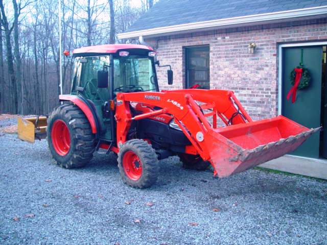

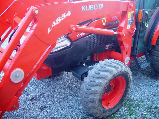

There is quite a bit of extra storage areas on the FEL. Had a set on the old 3430 with 723. The new LA854 pipes were larger, so I made some more.

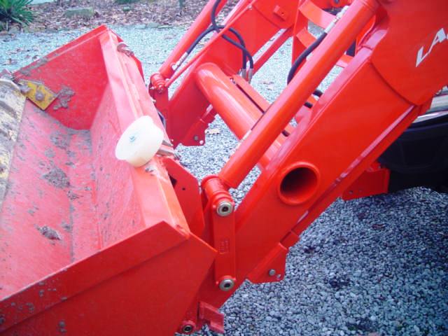

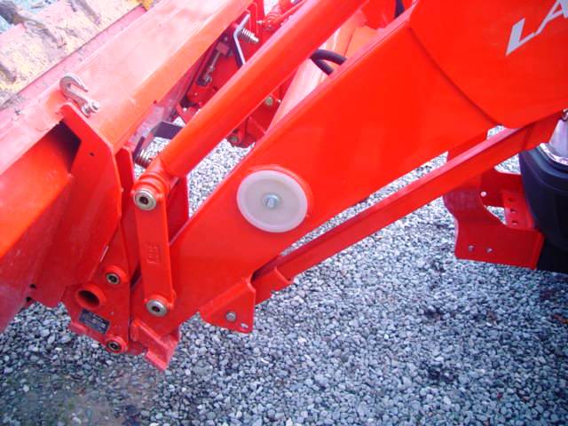

These are made from 6/6 nylon, 4 3/4" x 2" thick, turned down to 4 3/8", then split 4 ways, drilled for a 3/8" bolt, with a tapered nut on the inside. Tighten up the bolt and it swells the nylon inside the tube.
Great place to carry chains/straps and such.
Had them for 2 years on the 3430 and even when pushing brushpiles, never lost one.

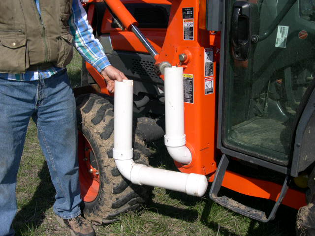

Good idea... I needed to carry chains as well... I used PVC pipe and stuck it into all available orfices of sufficient size.. and bolted some on the rear.. see photos.
