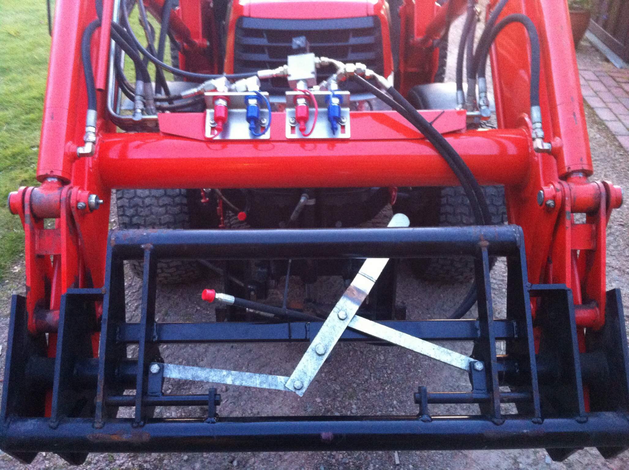

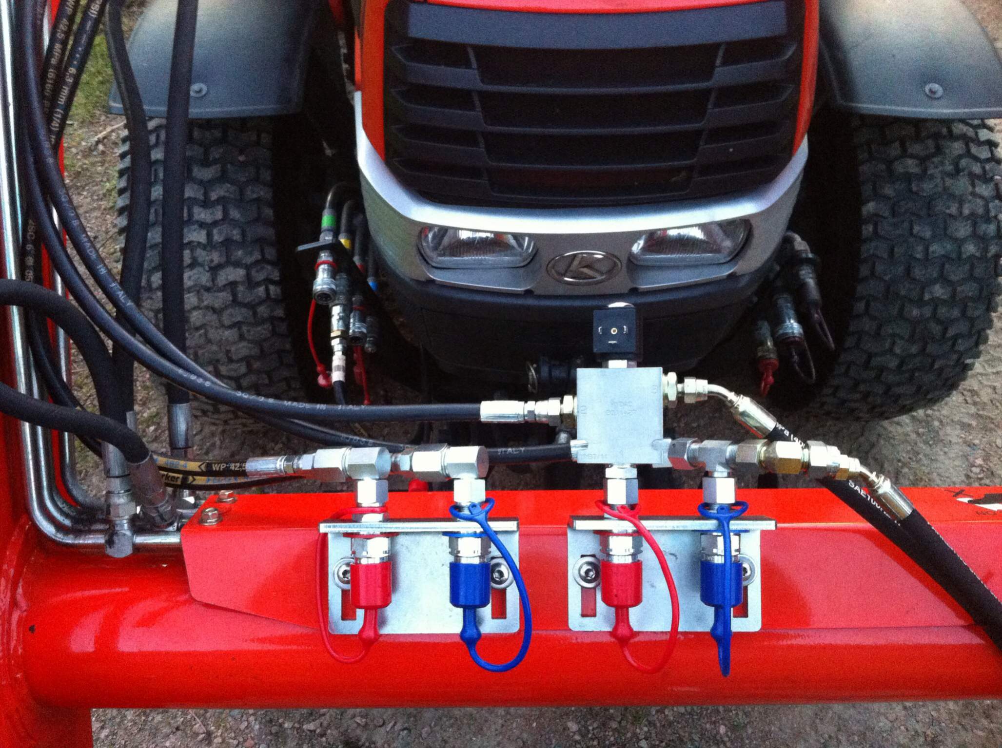

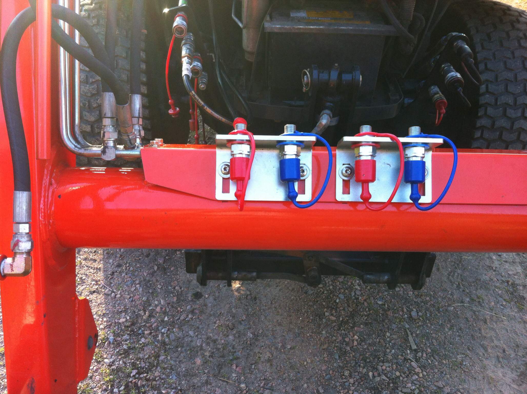

Finally made some progress on the third function today. I'm trying to use parts that I have already got lying around, but the need for different hydraulic adapters is always greater than the supply....
Anyway, 3rd function will be diverted from the curl circuit. The 6/2 diverter will be located on the right FEL frame, and I have just made a bracket to attach it to the existing pipe bracket, pictures tomorrow!
An additional 3/2 diverter will provide "3.5"-function to the Trima QA implement locking cylinder, soon to come: http://www.tractorbynet.com/forums/build-yourself/338095-l5030-trima-sms-quick-attach.html
A 4th function is also implemented by hoses that go down to the front 4pt hydraulics, normally used for the V-plow. As there is already a 12/2 diverter between the FEL and front hitch, i can activate this by a selector switch.
This is related to my other projects listed here: http://www.tractorbynet.com/forums/...bought-l5030hstc-post4148023.html#post4148023
Br / Marcus

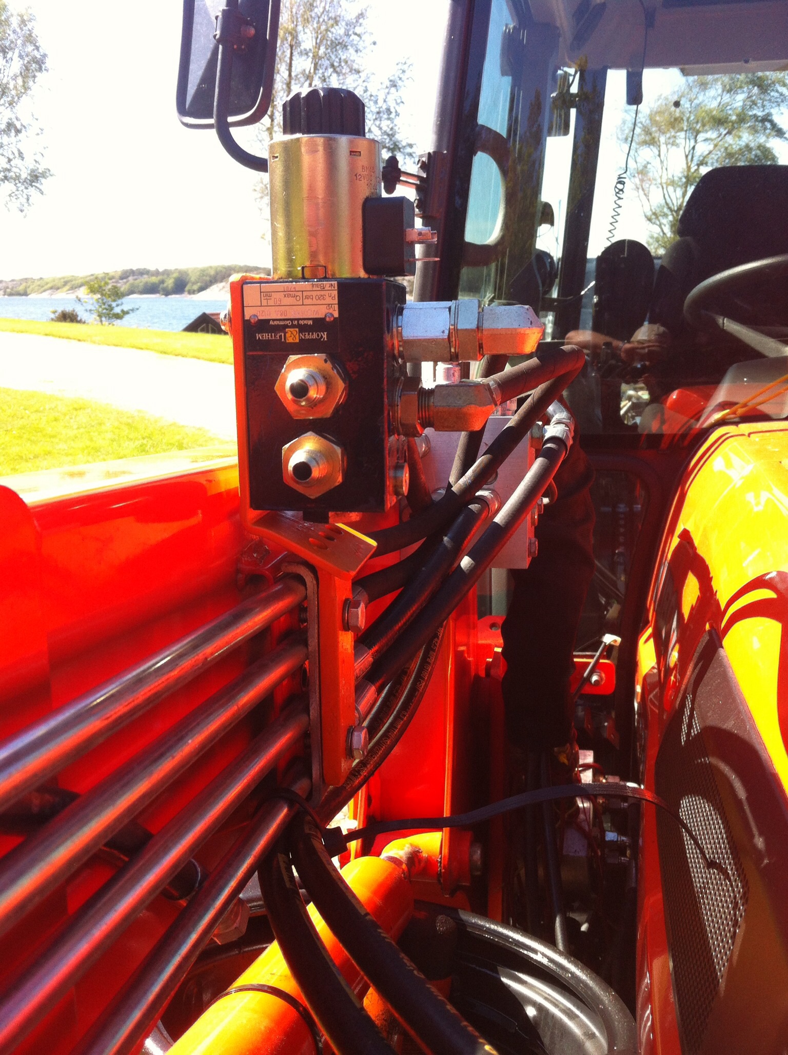

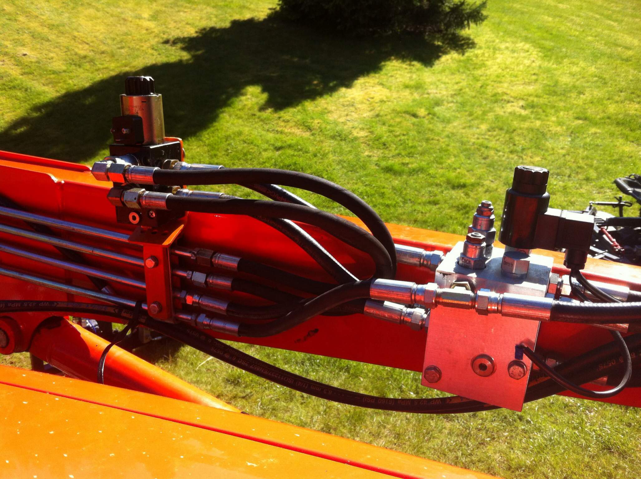

   / FEL 3rd function using diverter, QA lock and 4th function on Kubota L5030HSTC
#2
Added a 6/2-diverter ( to the left in picture) in the curl circuit, after the self-leveling valve.
/Marcus
