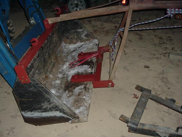

I got tired of removing one implement and hooking up another to move it so I made this. After I made it I saw my boom pole and thought it might not lift a lot but sure does reach high for something.

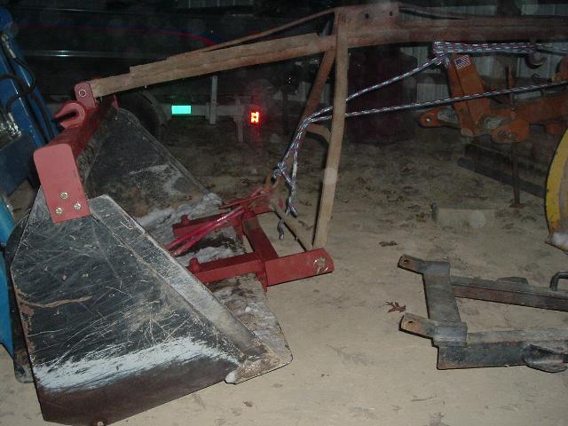

Looks good, that's one of the advantages to the 3 pt QH's just jockeying stuff around, I don't even have to get out of the seat :)
With that front mount looks like you could slide a rod through the mounting hole on the snow plow and have a loader mounted plow, it would be a little far out front but would work.
Another suggestion is try and mount a 2 inch receiver tube to that custom bucket top structure you made, they come in real handy.

Thanks JB4310 my problem is that not all of my implements are compatible with a QH and I have a mount in the bucket for my plow.
