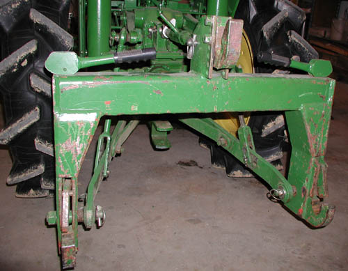

   / FEL/3 Pt Hitch Size #8
Here is a soloution for the narrow spread. This is a quick hitch from Tractor Supply. The draft arms are mounted inside of the adapter on pins instead of where they are supposed to be. The adapter has the 26 inch spread so most of the standard cat 1 stuff fits. The tiller has brackets welded on it so it fits the adapter. A side benefit is most things can be hooked up without leaving the seat.
