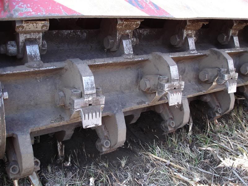

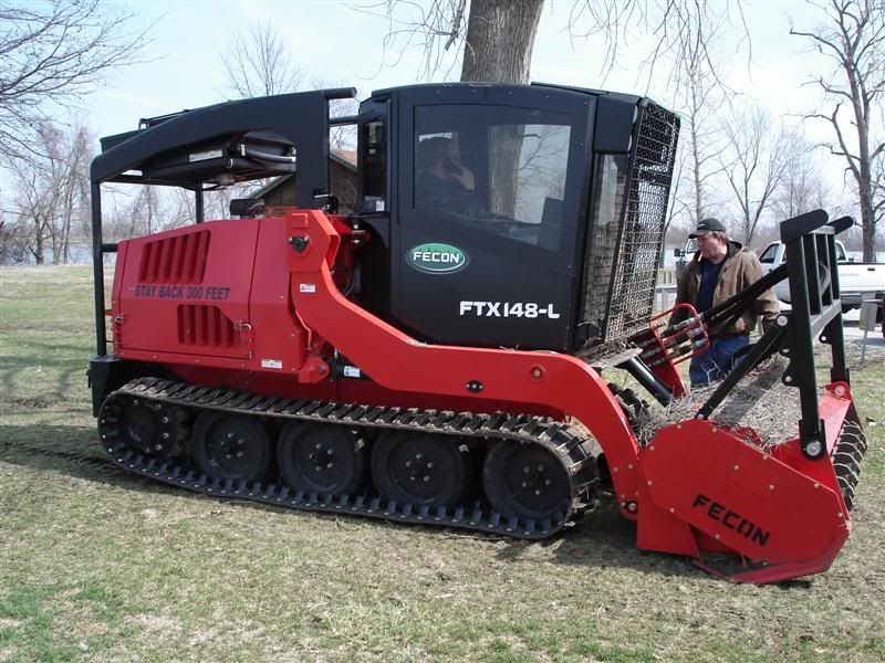

I attended a demo today for the new Fecon FTX148-L and I was pretty impressed (although I'm no expert on mulching machines). It had a Fecon BullHog BH85 head with carbide teeth. I took lots of pictures and video too that I'll post here and on YouTube.

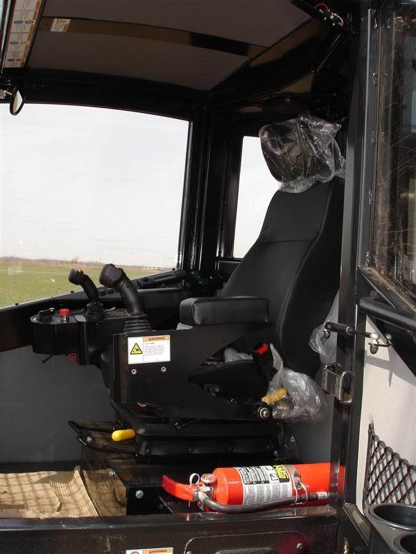

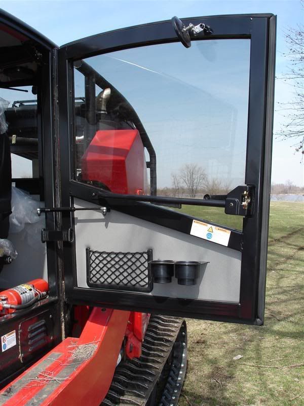

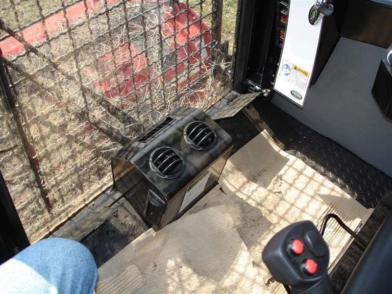

I actually got to operate it for at least half an hour and it was awesome! The operators cab is very quite and very comfortable while at full throttle and mulching, it was no problem at all to listen to the built in stereo. I thought the cab was pretty darn spacious actually, and the pressurization and filter system worked great. Visibility was somewhat hindered by the metal brush guard in front of the windshield though. My eyes kept wanting to focus on it and not further out in front of it where I should have been. I think eventually I'd of gotten use to it though.
I really liked the fact that with the loader arms you could raise the mulching head up higher than the top of the cab to cut off a tree top and then grind what's left of the tree down vertically while it's still standing in place so you don't have to chase it around on the ground.
One thing that I was surprised about was it's weight. It only weighs 16,300 lbs. with the BullHog head mounted on it. That's only 2,000 lbs. more than an ASV PT100 with the smaller BH74 head on it.
One note: In the videos you'll see the FTX148-L taking on a tree and it's stump, and while doing so you'll see the rotor in the head stall out numerous times. It was pretty obvious that it was due to the person operating the machine and not the actual equipment causing the stalling. He was at times just jamming the head into the stump and that rotor would stop.
So on to the pictures and videos. The videos are sometimes hard to look at, my camera had something funky going on with it today. I think because I didn't have the sun behind me that it was messing with the metering in my camera and causing the video to be too bright.

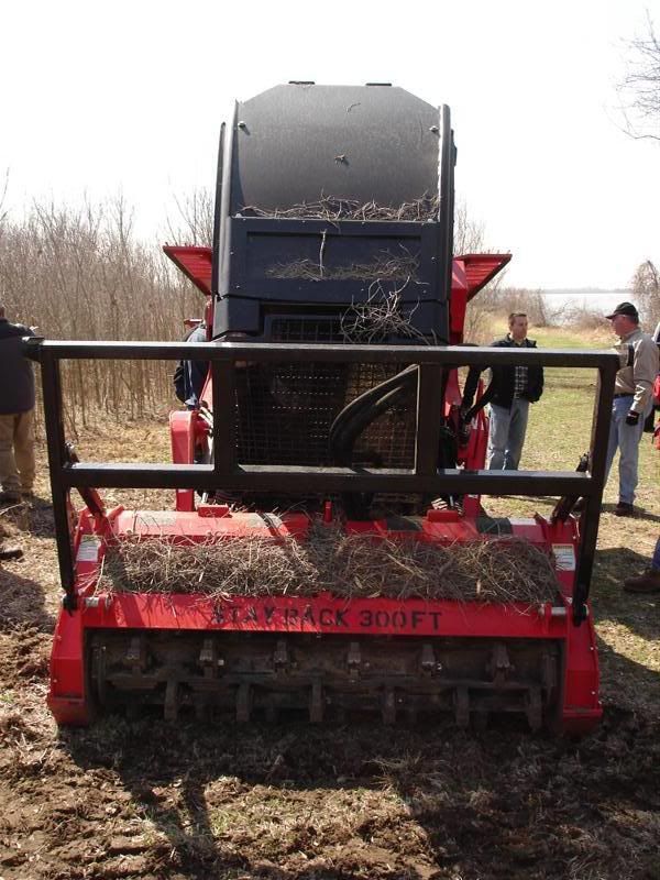

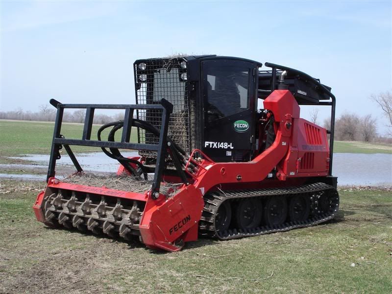

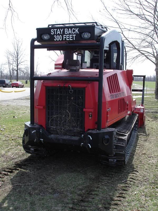

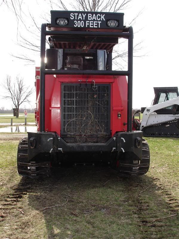

Some exterior shots follow:

Here's a few of inside the cab:

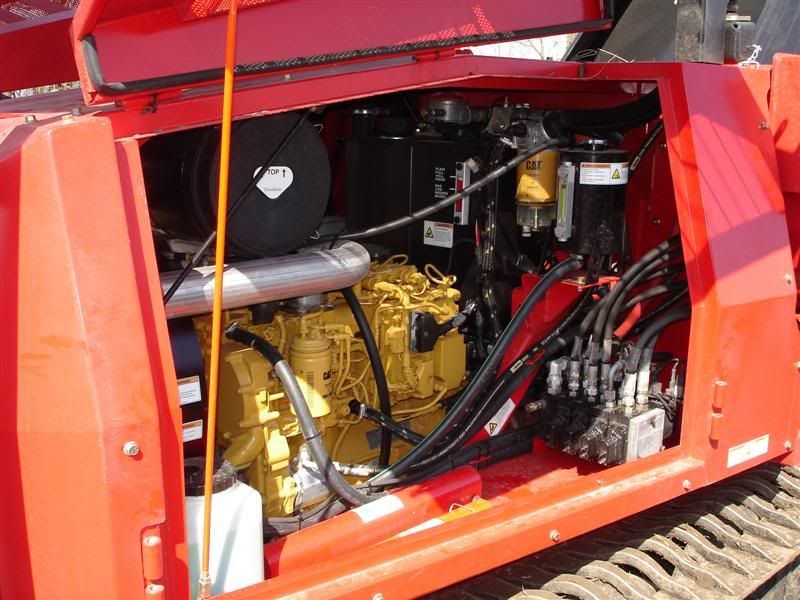

Here's some shots with the cab tilted forward and the engine compartment open:

Great pictures!! It looks like an extremely well thought out tractor. I watched a video of it run on the fecon website and it seemed to suffer some of the gyrotrac similarities. It pitched forward when suddenly stopped or if the head was over a foot or two off the ground. Did you encounter any of that? Also what was there reply to the track repair, cost, and longjevity? Just it looks alot like the gyro setup and that was a complaint from there larger tractors.
   / Fecon FTX148-L demo
Robbie,
It did look very well thought out, especially under the cab where the pumps were and inside the engine compartment. Such a huge difference compared to a skidsteer based mulching machine.
Yes, it did pitch forward when stopping suddenly or when moving the head up/down quickly. You can actually see it do this in one of the videos that I have to post still. Isn't this quite common though on skidsteer based mulchers? There is afterall a 2,000+ pound mulching head hanging several feet in front of it.
I myself didn't hear anything related to track repairs or cost. They did tell us that they will be coming out with an optional steel track system this summer for the machine.
They also pointed out that they use an all metal drive sprocket instead of a plastic toothed sprocket. Also something about how the metal brackets on the track that are used for guiding the rubber wheels, have a vertical inner face instead of an angled face like GyroTrac uses??? This helps keep the track from beind 'walked' off the wheels by sticks and rocks???
Yep, I've always thought that the track system looks very similar to GyroTrac.

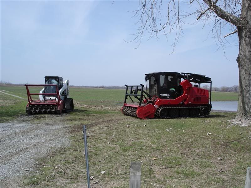

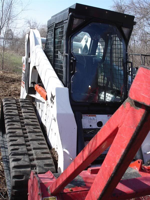

Thought I'd post some pictures of the Bobcat T320 that they brought out there too with a BH74 head on it that they'd installed the knives on. I didn't take them up on their offer to operate the T320, it had foot controls and I've never used them before.

There were several times that he jammed the head down so fast that it tore the wood to pieces instantly, & instantly stopped the rotor. After the chips and dust would clear, you could see huge chunks of wood wedged in the head that were keeping the rotor from spinning back up. Of course the operator couldn't see that the rotor wasn't spinning and he'd try to re-engage the wood and then he'd figure it out. He was smart enough to roll the rotor against the log or ground in order to spin the stuck pieces or wood out.
