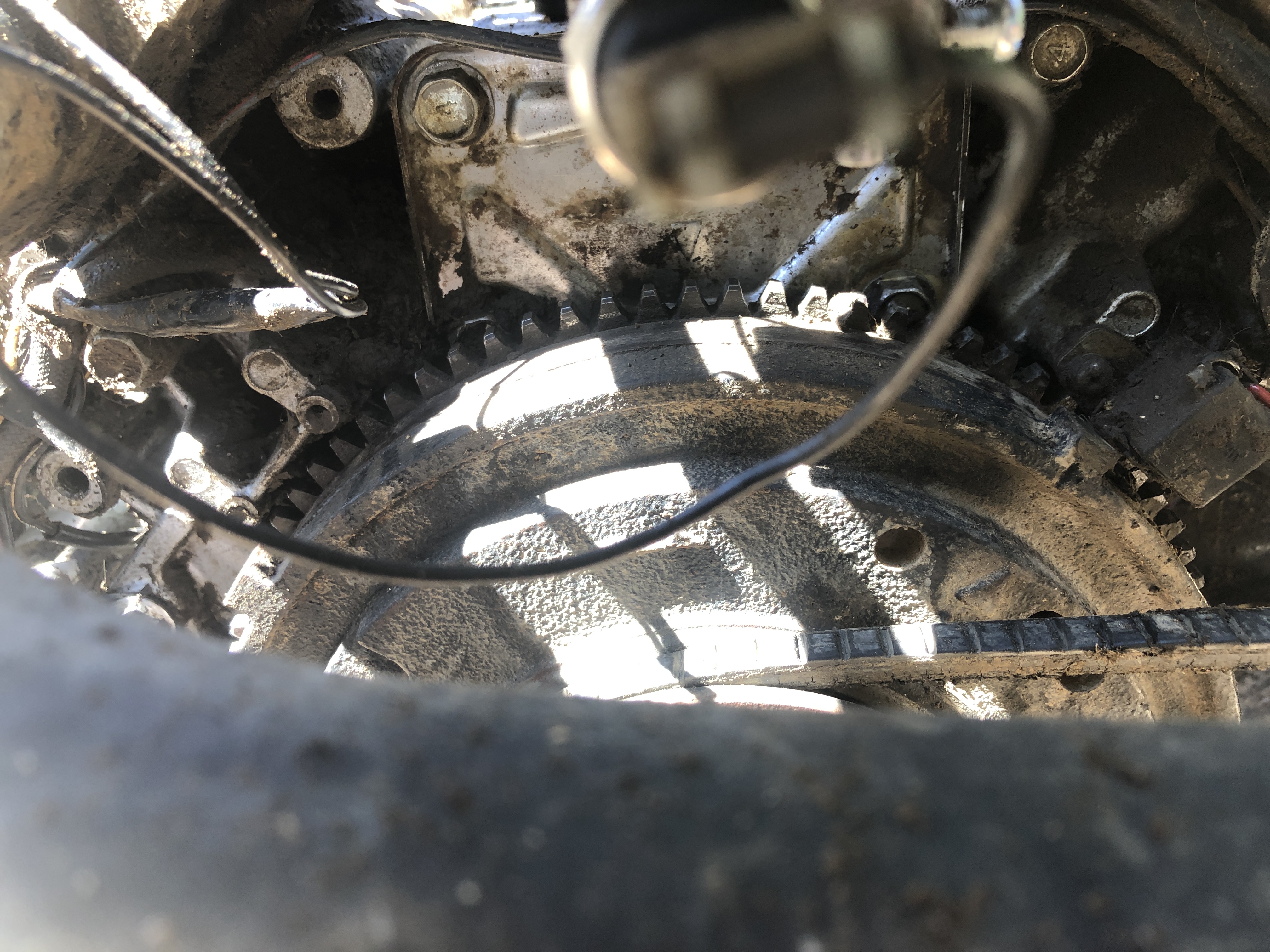

Decided to go to ignition and removed blower housing. Anything look interesting in this picture?😂😂
   / fd620D not reaching high idle rpm #6
A lot of dirt built up in the front of the trigger coil, but unless it has some magnetic partials in it, it should effect the timing.
What did I miss?
Richard
   / fd620D not reaching high idle rpm #7
One pulser coil missing, appears?

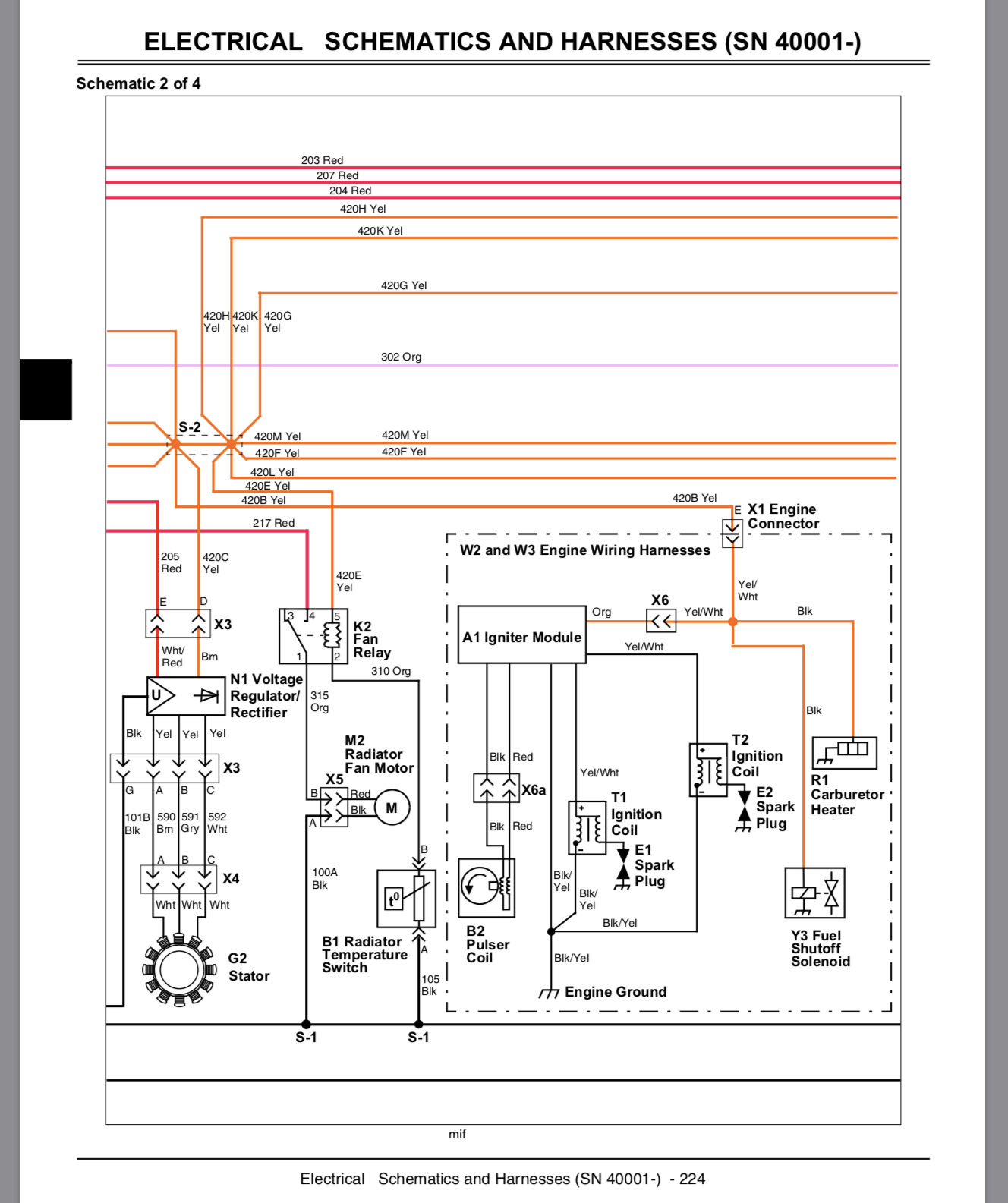

An ignition module missing?
Yes, that痴 what i thought when i posted, but it seem there is only one pulser coil on this setup. My mistake! and it drove me crazy because there was no other connector. I almost bought a new coil too. I thought i had found my problem but not yet.

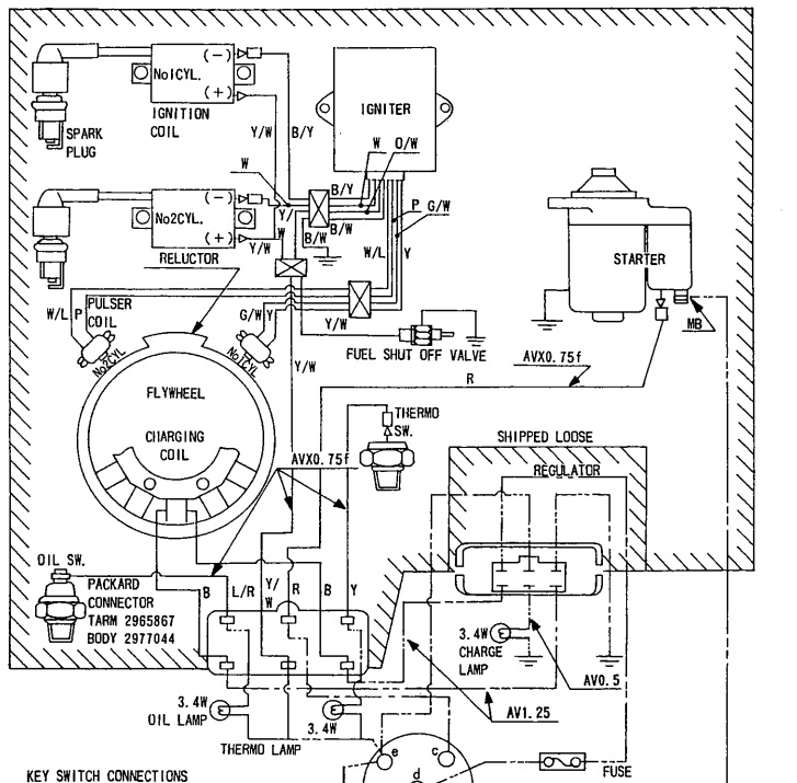

   / fd620D not reaching high idle rpm #9
Causes me to wonder.. being a two-cyl engine.. here is schematic showing one ign module and a pulser for each cyl. From the FD620D manual.
Yes, i saw that and that’s when i figured i was home free. However, the absence of a connector for the second coil, and this schematic seemed enough for me to accept that there is only one. It seems curious though. Take a look.
