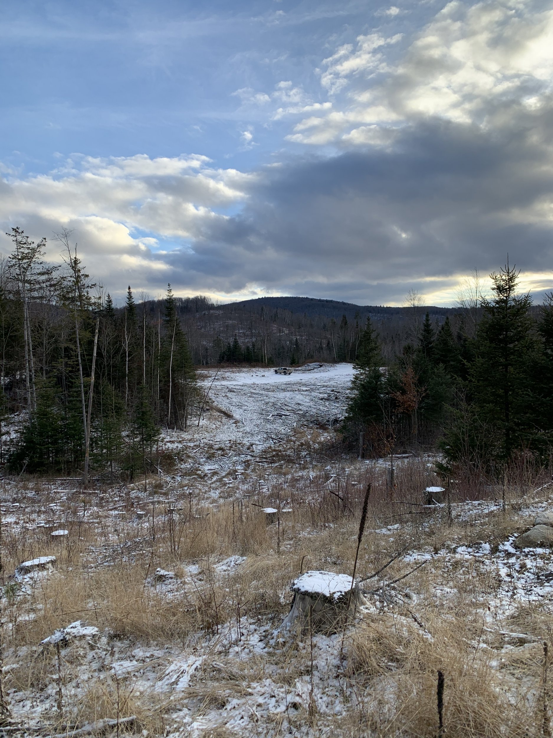

I mentioned this in an earlier thread that I recently bought 224 acres that I’m trying to do some land clearing on, and taking a previous red pine plantation (7-10 acres) and converting to pasture/something mowable (at least for now) because if I dont get to it soon it’ll become an usable mess of thick beech saplings and brambles.
I looked at a PTO forestry mulcher have decided against it. Can’t justify the $20k price tag and it still isn’t quite the right tool for the job. Instead I’m hiring it out (right now five days of work) to a guy who offers a very reasonable $1,430/day and one-time $200 setup fee and should obviously do a much better job than I ever could.
However, I still want something that can take care of stumps and will make full use is of my tractor‘s 64 PTO horsepower. I’m looking at the Baumalight 3P34 (3 Point Hitch PTO Stump Grinders|3P34 - Baumalight). This is the biggest one I can find, with a 100hp gearbox. It requires 2 remotes, but works with one and I could jerry-rig a solution (I’m getting a tractor with only one set of remotes, but if I wanted to wait another week or two they can install a second for about another $1k). Does anyone have experience with this unit?
Anyone with experience tackling a lot of stumps; how fast can you chew through a 12-16” pine stump? under the right conditions, can you get it down to only a couple minutes where you can just go down the line, one after another?
At about $7,300 it’s kinda pricey, but I’m willing to pay if it means performance, efficiency and time savings.

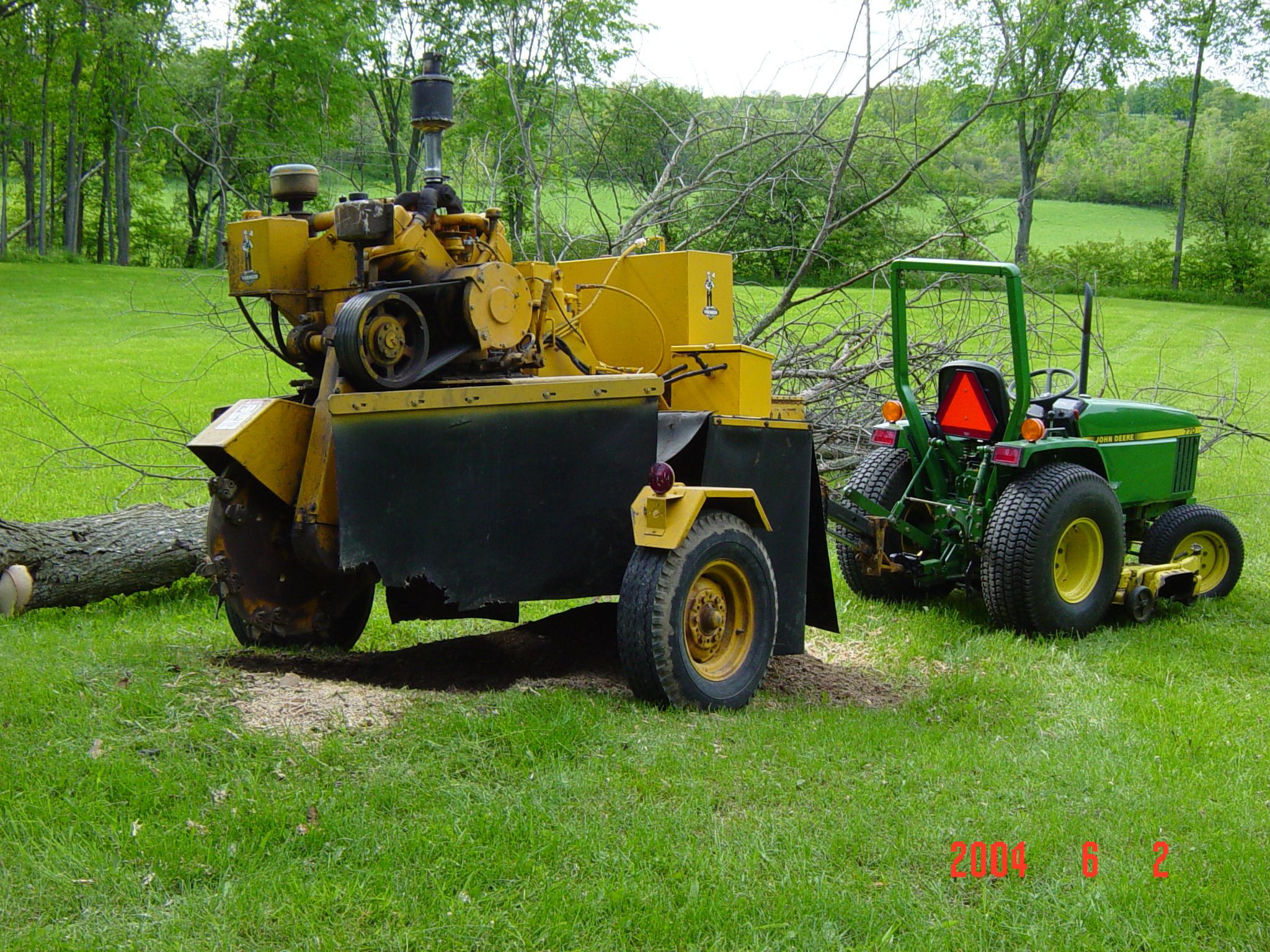

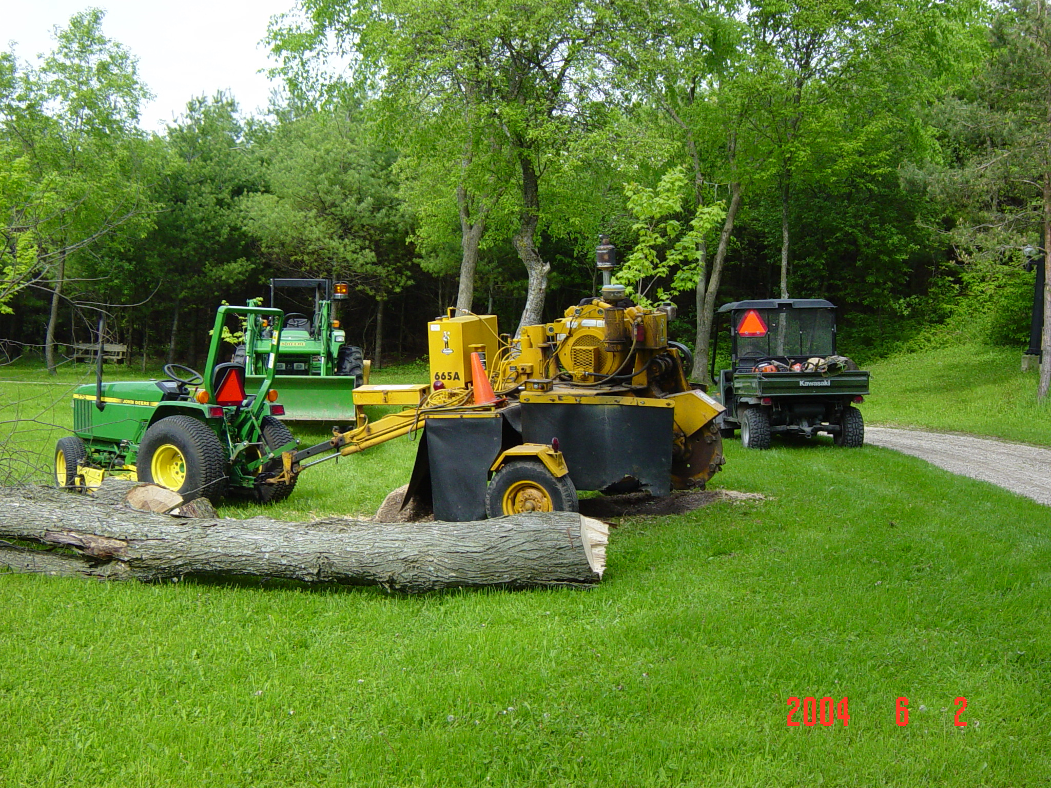

   / Fastest PTO Stump Grinder on the market? #4
If you demand performance. Why not buy a used high performance (dedicated) machine? Dedicated machines are ALWAYS the most efficient.
I once bought this Municipal machine (cheap) that could do a six foot stump without repositioning the entire machine. Chewed a ton of stumps and sold it at a nice profit. Maybe twenty years later.
It was also just a really cool machine to operate!
My biggest obstacle to speed here was stones, and why I bought this machine with a corded remote control, so you can see EXACTLY what your cutter is doing.

This is very interesting. Much like the baumalight I was looking at, albeit a slightly smaller rotor. I saw this in the land pride brochure but I think I’ll purchase the stump grinder as a later add-on addition.
About how fast are you able to grind a 12-16” stump, or how many stumps could you grind in about 4 hours or so of working? The stumps I’m looking were all cut by a feller buncher, so theyre fairly low to the ground (some as low as 4-6”).
Much of this large clearing I’ll be hiring out. I’m looking for something that will allow me to slowly whack away at other (smaller) areas over the next 3-5 years--small enough that it doesn’t make financial sense to hire out. I know there will be a lot of this. not just for land clearing either, but removing stumps for trails and such throughout the property. I’m also trying to figure out how successful a good PTO stump grinder could be (under ideal conditions), and as such is it worth paying $5-7k for the larger model compared to the entry-level $2k models that’s basically just a rotor off the 3pt hitch.
