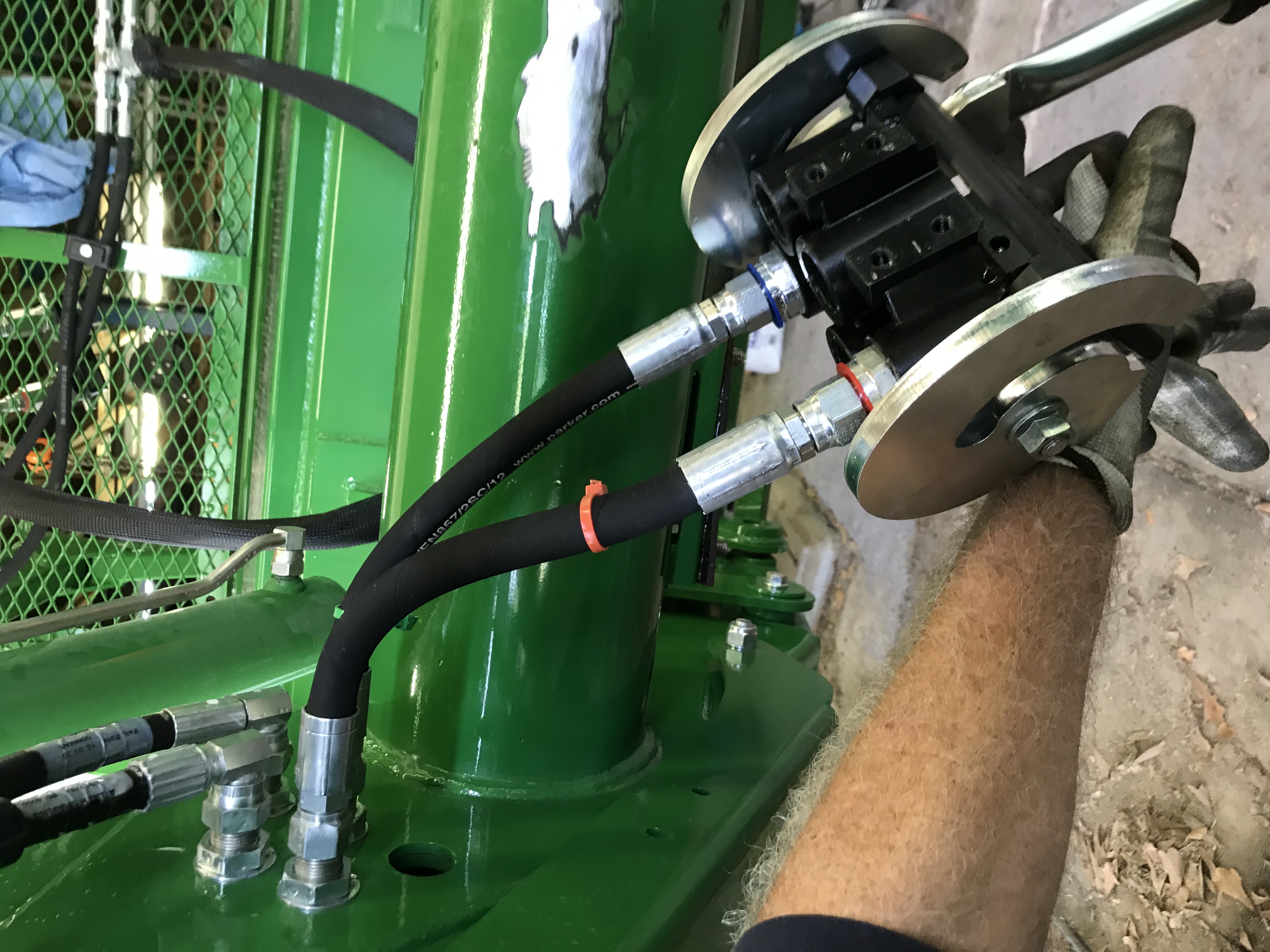

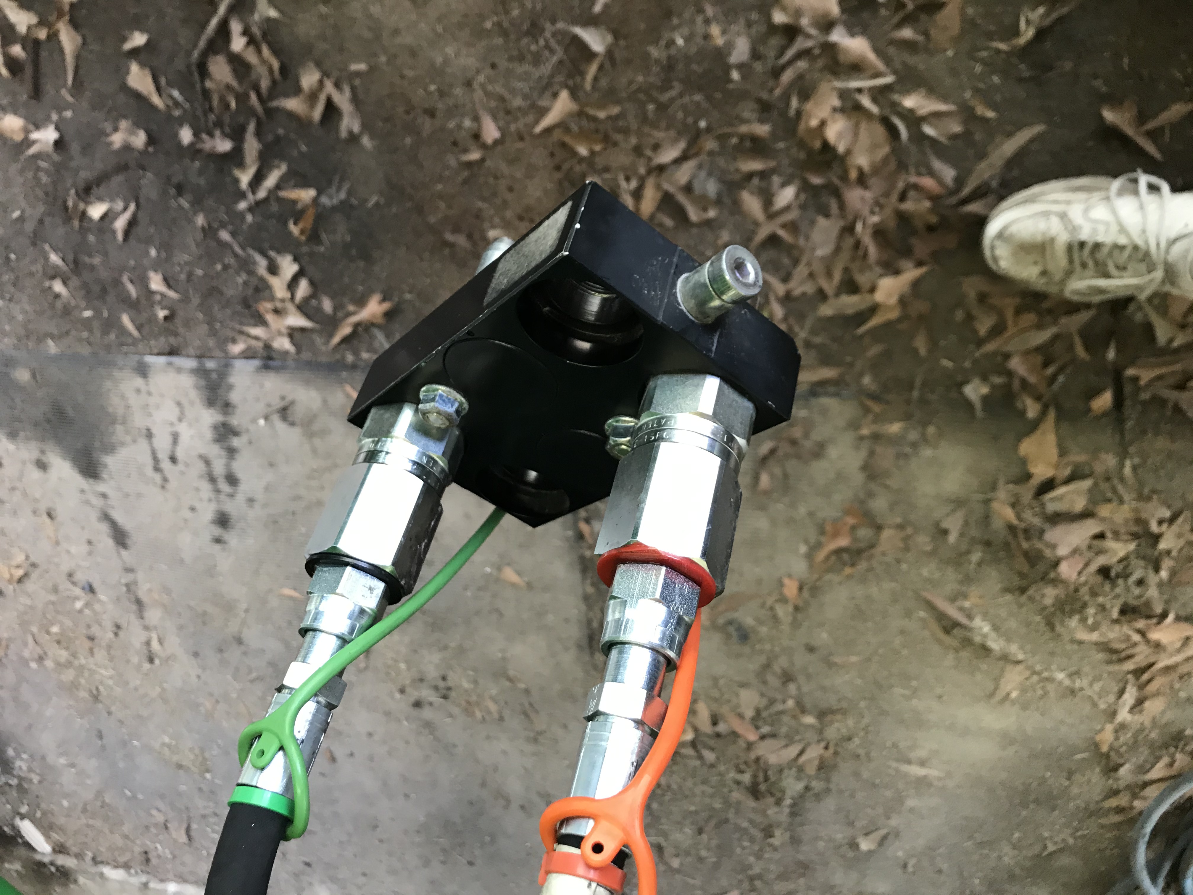

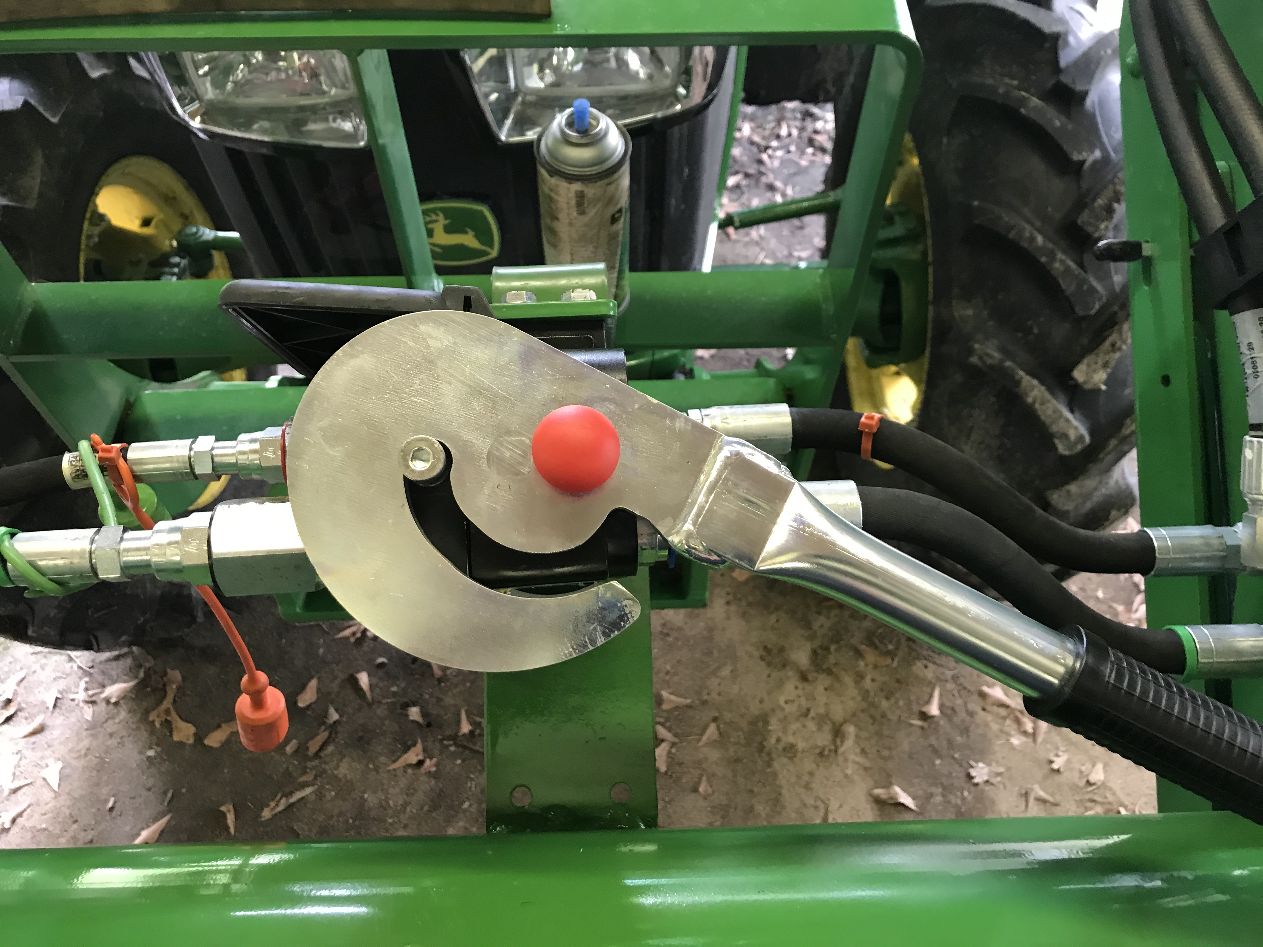

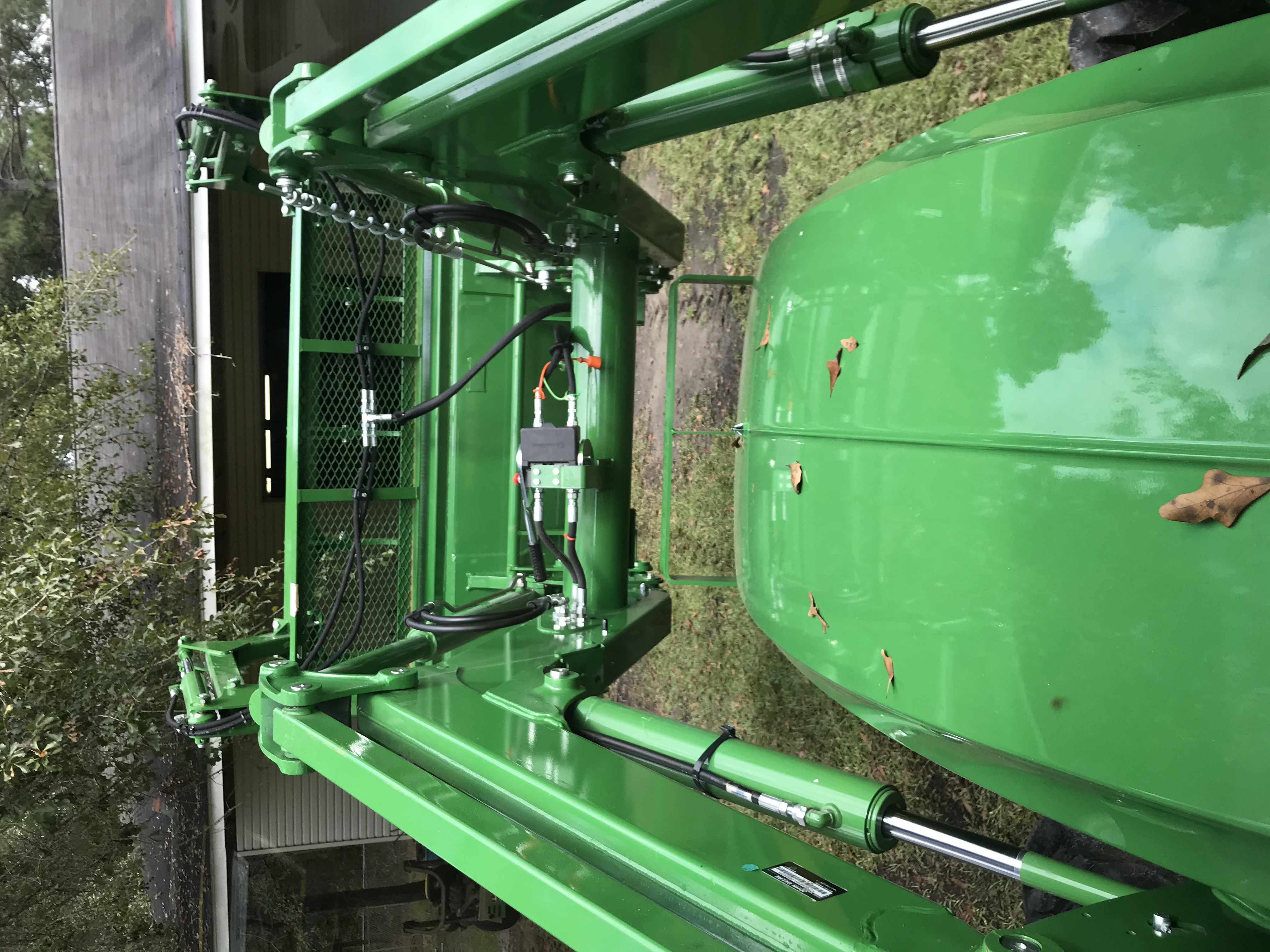

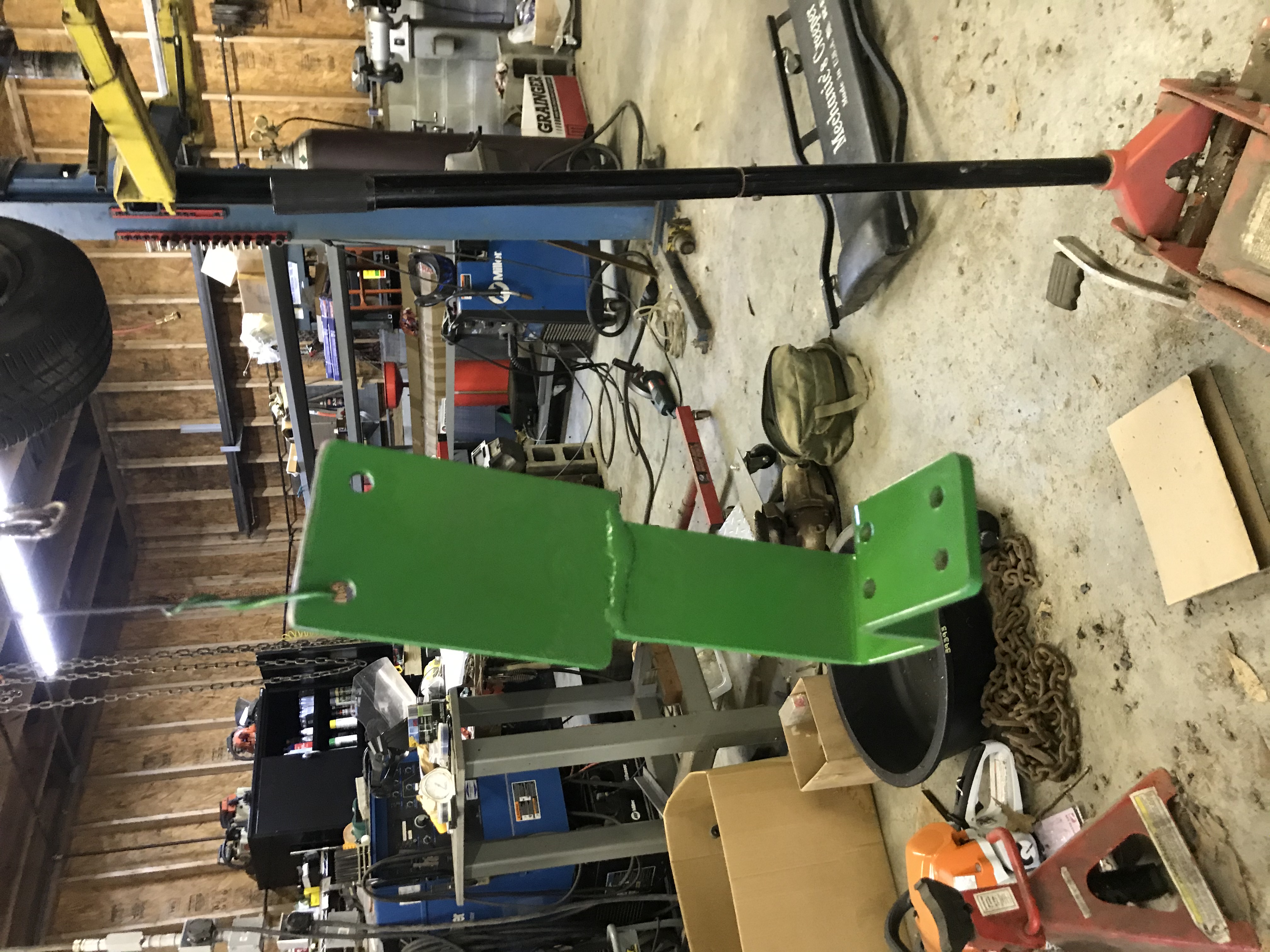

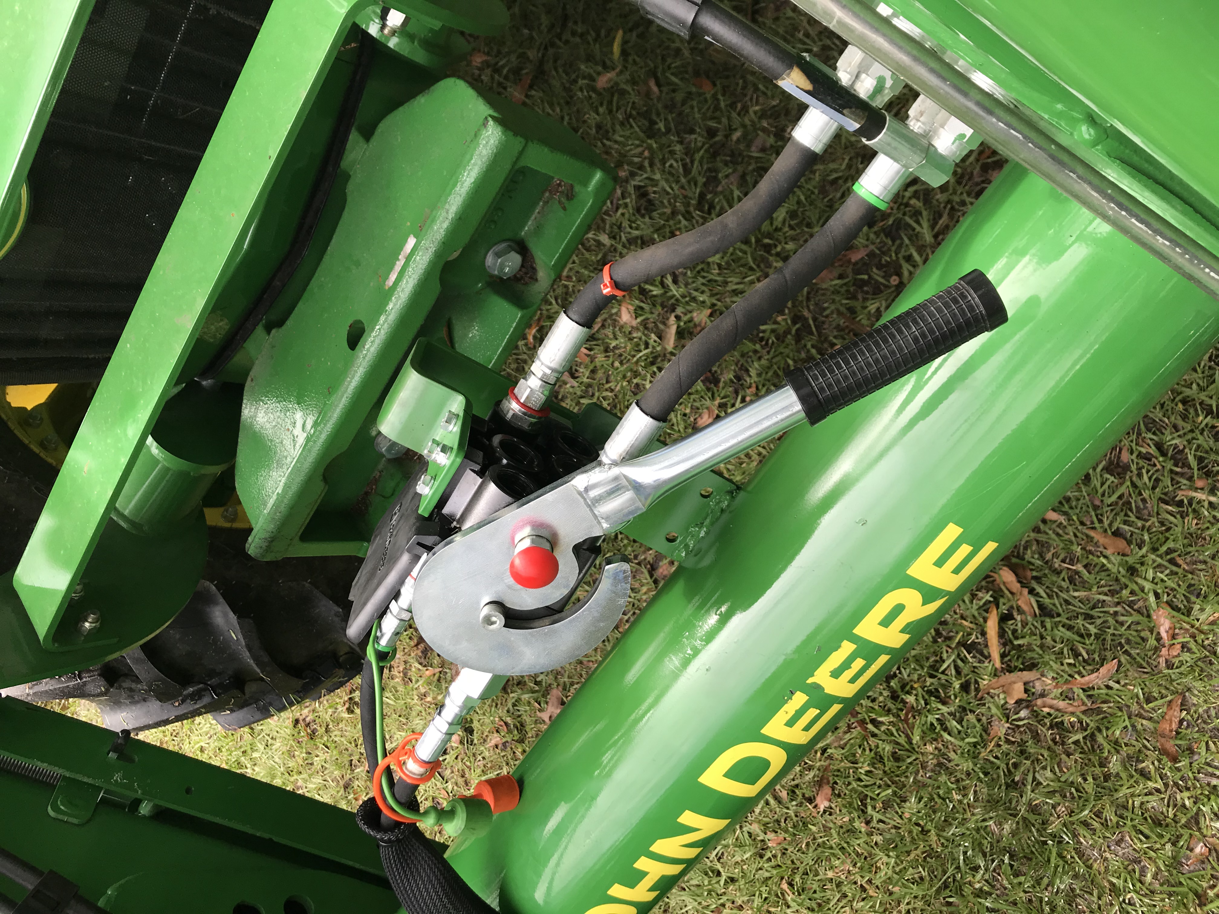

Sep 29, 2020 / Faster Attachment for 3rd Function #1 workinonit Elite Member Joined Sep 13, 2020 Messages 3,125 Location Scranton, SC Tractor JD 5090E I got this from my dealer's bone yard a few days ago. Had to fab the mount from a mount they had and get some new fittings on the two tractor hoses. Thais is what I ended up with.
Sep 29, 2020 / Faster Attachment for 3rd Function #2 kneedeep Veteran Member Joined Apr 16, 2012 Messages 1,567 Location AL Gulf Coast & MS Delta Tractor Mahindra 3510 & 8560 What does that do?
Sep 29, 2020 / Faster Attachment for 3rd Function Thread Starter #3 OP workinonit Elite Member Joined Sep 13, 2020 Messages 3,125 Location Scranton, SC Tractor JD 5090E It's the one touch hook up for the 3rd function implements on the front of the loader. Pull the handle and it disconnects. No oil.
