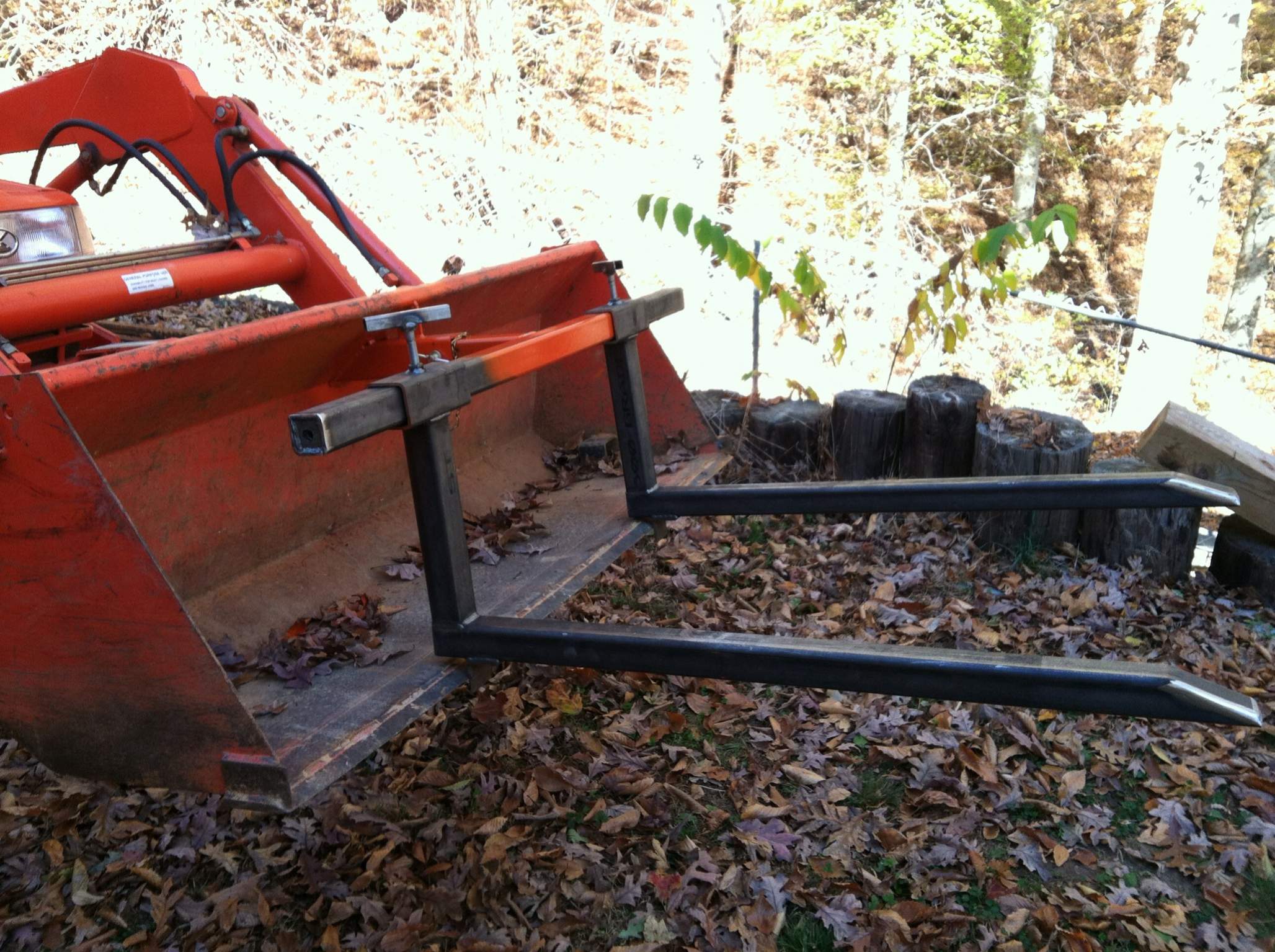

Took this idea from another member her and wanted to post it up for all to see. Special thanks to BX 24 for the idea.

Here's the butter that holds the bread together........

I like 'em, just use your head and don't push them too hard.
   / Fast and dirty FEL forks/receiver #4
Should work good for most applications, putting a Log or pallet full of weights might be too much but for most part would work good for the average brush pile...
I have similar plan, though using 3 or 5 receiver tubes welded onto my bucket w a heavy plate. Then use some 2"x1/4 wall tubing to extend the forks to the bucket like you did. I have a set of compact forks from company I worked for that was tossing a old FL. only wish I took the entire mast! lol.

Great welds. Just a little concerned with just one point of contact for the top. Won't it bend if you just lift with one fork? Maybe I am missing another support in the picture.
When I built mine, I ran the tubing all the way to the side of the bucket and welded plate to the edge of the bucket. I also have my forks resting against the leading edge of the bucket. Takes all the torque out of the equation.
Or welding a short piece of angle to the back of the fork forming a "v" so that it rests on the edge of the blade of the bucket.
