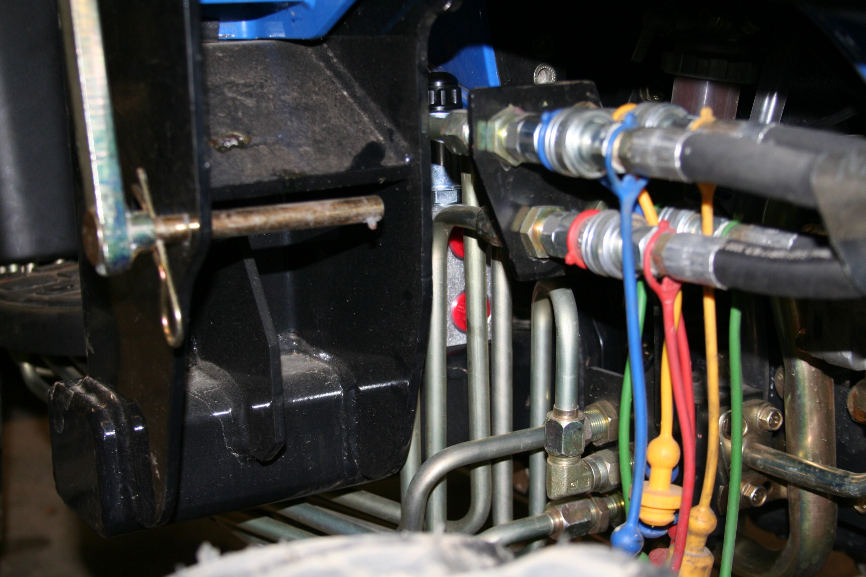

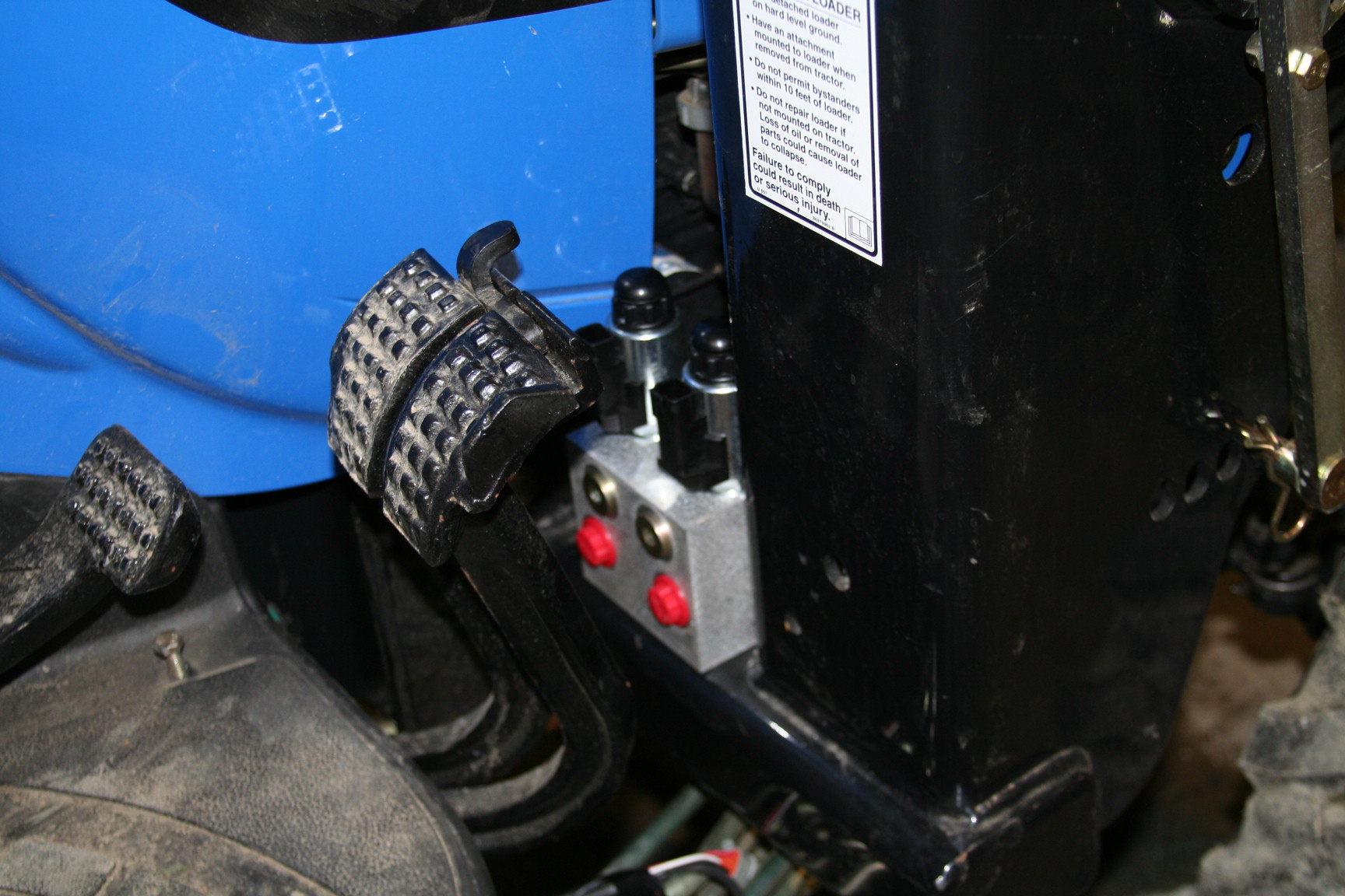

Just got a Fasse 757-1550 kit to alternate the curl control with other things.
Nice unit but does not fit quite right. Space is too small and hard pipes in the way. Need new mounting on back of the main post. Drill the post. Or put the valve up front on the loader cross bar. Probably better protected up there but probably needs a cover.
Then Quick Disconnects are wrong. Don't know what they are but NH front is ISO A 3/8. on the TC34DA. IF I am wrong here and someones else knows for sure speak up, please. Will try to get replacements from Frasse.
Pictures show impossible spot and possible spot on post.
Opinions?
