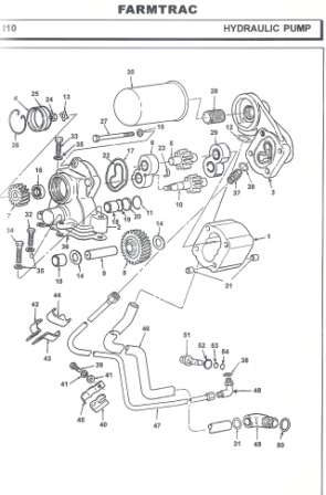

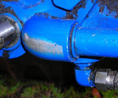

Thanks for the tips. Just to make sure we are talking about the same thing I took a picture (T1) of the elbow for the lowpressure line to the hydraulic pump.
Additionally I added a picture from my parts manual (T2) which seems to indicate the threading that was mentioned in one of the replies. The elbow is depicted in the lower right hand side of the page from the parts manual.

   / Farmtrac 60 Low Pressure Hydro Return Line Leak #5
We all thought you were talking about the line up from the bottom. It gives more trouble. I believe you would have to drain the hydraulic reservoir, remove the hydraulic pump and clamps that hold the line. Then you should be able to pull the line forward out of the fitting. replace the oring. Elbow 47 appears to thread into the rear center housing and also has an oring. You will probably be able to get the oring from an auto parts house or Farm and fleet type store. Just take the orings with you to get the correct size.
A few days ago I completed my repair on the leak. As you can see in the earlier post the low pressure line leaves the axle housing in a 90 degree elbow.
I removed the fender, brake pedals, foot throttle, and foot rest. I also removed the hydraulic pump to allow removal of the metal pipe which connects the elbow to the pump.
I declined to remove the clutch and brake mechanisms from the left side of the tractor. Doing so, I believe, would have allowed the pedal shaft to be moved out of the way to allow full rotation of the hydraulic line elbow.
Instead I decided to use RTV sealant. I was able to back the elbow out about a quarter turn. I liberally coated the gap with RTV, rotated the elbow to the appropriate position and allowed it to cure for 24 hours. This "fix" transformed a constant drip into a very minor drip.
We'll see how it hold up over time...I put a couple hours on the tractor bushogging...no problems.
