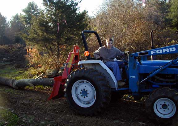

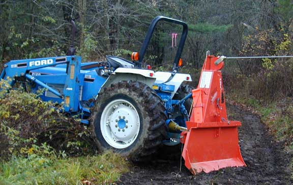

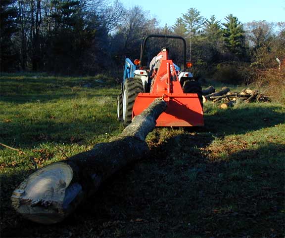

Just thought I'd post a few pictures of our Farmi 501 winch in action. It is mounted on a Ford / NH 2120. We are only pulling one or 2 large oaks at a time since my son Jim was doing the pulling. Normally I would be pulling 6-8 of the tree size shown. The Farmi winch pulls at over 11,000 # and has 165 feet of cable. The blade digs in well to hold the tractor and also is used as a plow to fill in ruts and move snow.
Note the plastic chain saw bar guard that slips into the slot on either side of the winch to carry a chain saw.

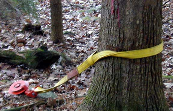

This attachment is the self releasing snatch block from Farmi. It allows you to pull at an angle toward a tree and then when the chain hook hits the snatch block it "falls" off and the log changes direction toward the tractor. Very useful as many times you can't get a straight pull toward the tractor.
