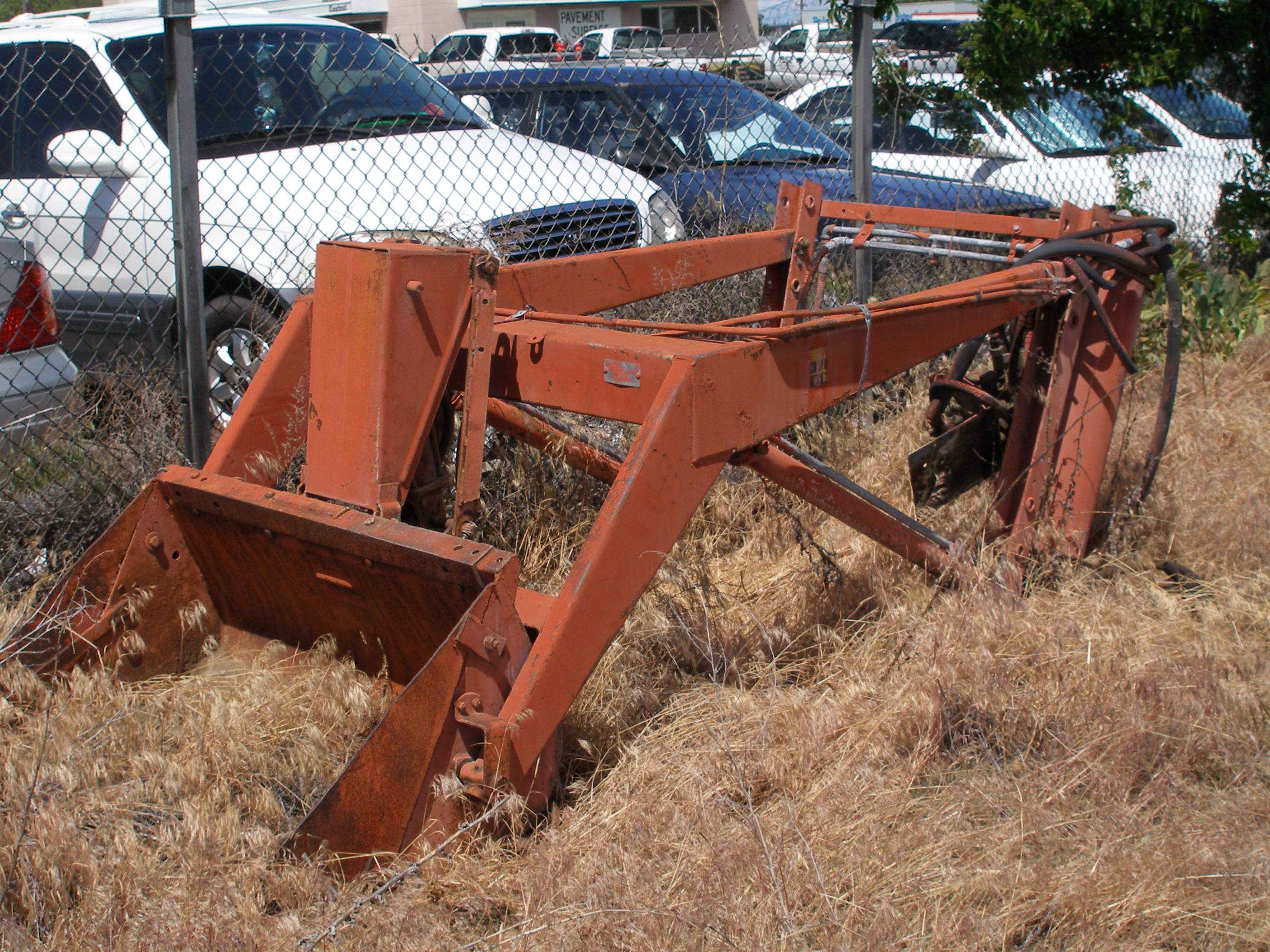

I have a superior Farmhand F-16 loader. Does anyone know what tractors it will fit or how I would find out? and any idea on a value would be appreciated!

Value varies from $300 to $1500 depending on condition of controls, clyinders, bucket, and welds/cracks in the frame. They were mostly farmall loaders for H, M, 300 and 400 series, But can be modified easily to fit other brands in the same size range. You can also run them on larger 600 and 700 series but that is pushing the load ratings

You definitely hit this one on the head. Much larger than an M or 450 and you will have loader issues unless you are very careful.
