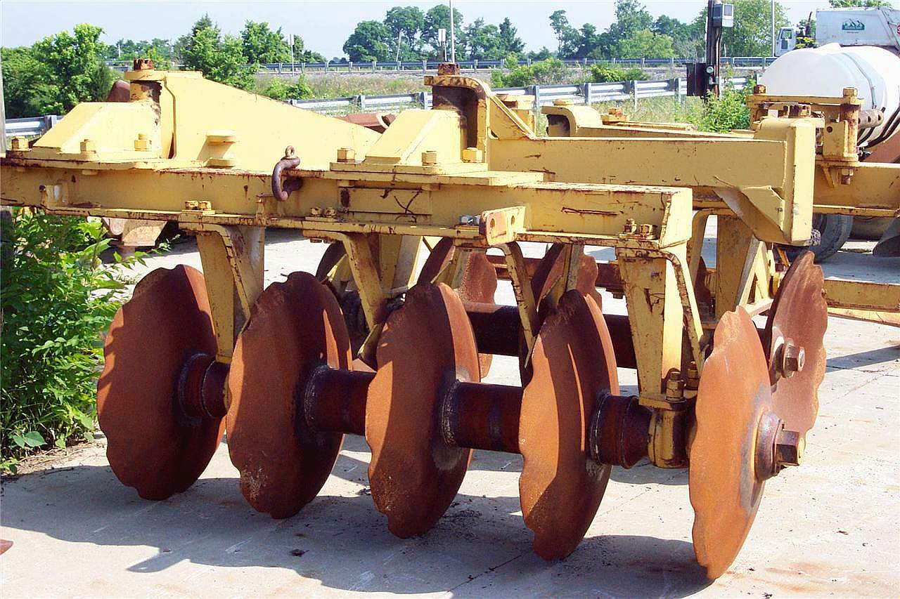

all disk's are not created equally and some may require a bit more HP per foot to pull than others.
34" diameter disc's, 20" spacing, 5 disc's per gang
Some specifications for the disk pictured.
Not very wide but A thirty HP tractor may have trouble moving it. :D
Granted, this is not the normal disk, but it does show that they come in different categories and for different uses and a general category really does not apply.:D
