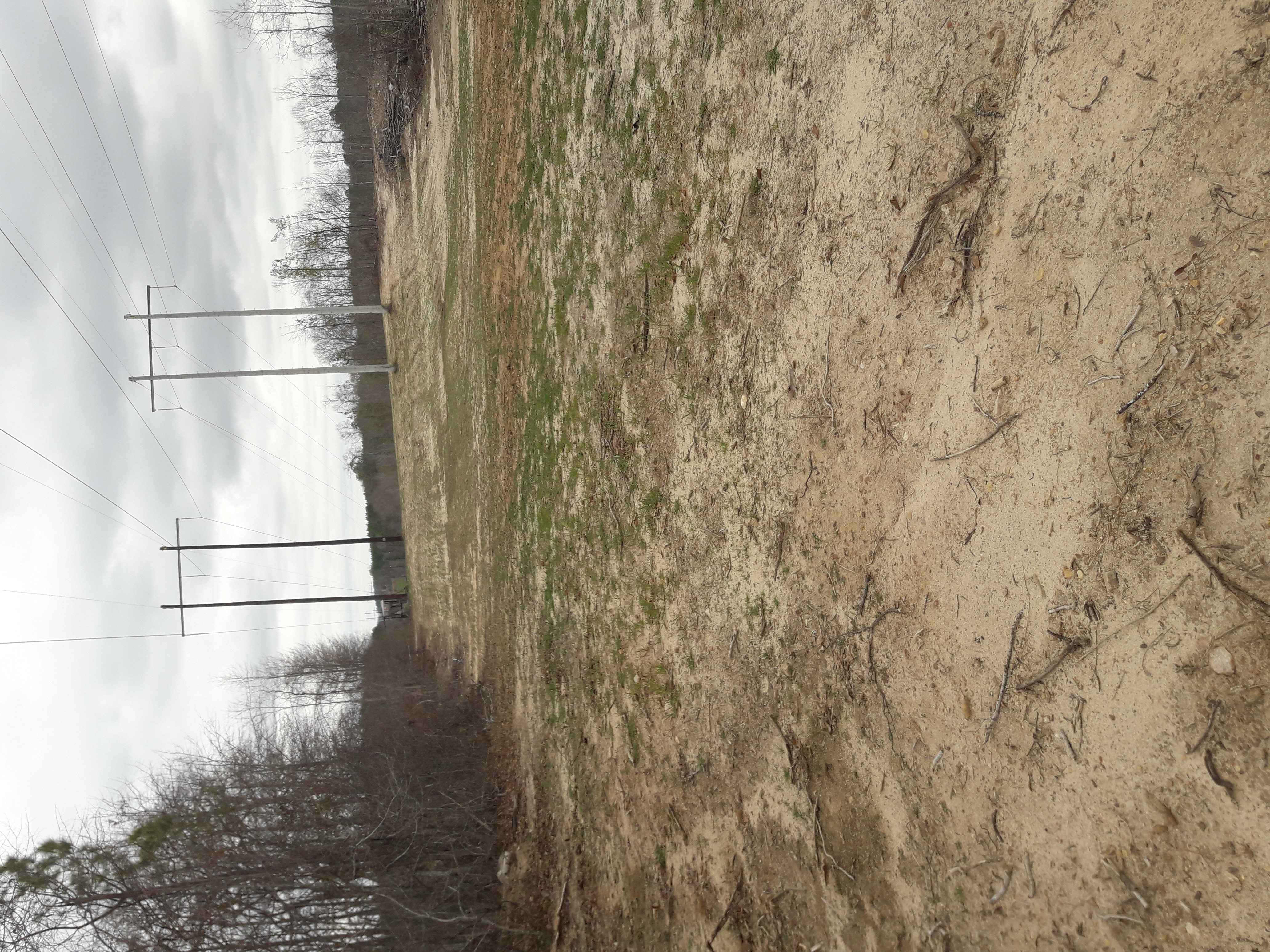

Last year I had my property clear cut of timber and area where trucks were staged was hard as concrete. I plowed the area, disced it and planted winter rye for the upcoming winter. Unfortunately in Alabama we were in extreme drought and so the area did not receive enough water to germinate before the cold weather set in.
Now that we are in the 70's the area is becoming green. I am faced with decisions for upcoming months. First, do I need to plow and seed for spring. Come May and June it will be driving and so I know I will have to plant a different foliage. I do not know the pH of the area. If I need to add lime do I broadcast it and then disc, seed and then fertilizer? Can i lime and fertilizer at same time then disc then seed? What is proper process for spring seeding?

Main reason for planting something is to prevent erosion. The area staged was power line easement. During winter time wanted to give the deer something to come in and feed on. All I plan on doing in this area year round is provide something for the animals to forage on.

I would plant clover. You could easily get by with dragging, broadcasting seed and cultipacking. Clover is a good "green manure" that adds nitrogen to your soil every time you cut it. Also deer love it.
In real steep areas you could add in some annual and perennial grasses. Search erosion control grasses for a mix that would be good for your region.

This is a good idea. If you have access to a "ripper", even a single shank, you could rip down about 12 inches every couple months and that would control erosion and let water into the ground. Keep weeds down over the summer.
Come late summer in September or so, put on a "balanced" fertilizer (equal amounts of N-P-K, like 19-19-19) disc the area to smooth and broadcast seed. A seeder is better as is a soil test but for a small area not so important. If you had evergreens you could use some lime. Pelleted is easier to apply but you could live without lime for now. Fertilizer helps the seed get a start
I suspect part of your poor seeding came more from hard ground, which gives poor soil-to-seed contact rather than lack of water. You need water, yes, but I have planted on properly prepped ground and got good results even thought not much rain for a month or more.
As a final thought, I have often planted oats to hold a slope while waiting for fall seeding. Quick to germinate, easy to spread and cheap in price. Grows faster than a weed.
