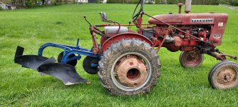

My super a has 11.2x12.4x24 rear tires and needs a new rim on left side. I found a super a I can cannibalize but it has 8" rims. My 11.2 tire says on it that it goes on 10" rims.
Can I put the 8" rim on and still use my 11.2 tire? Would rather spend 75 on an older rim rather than 300 on a new one from steiner.
Thanks
Nick

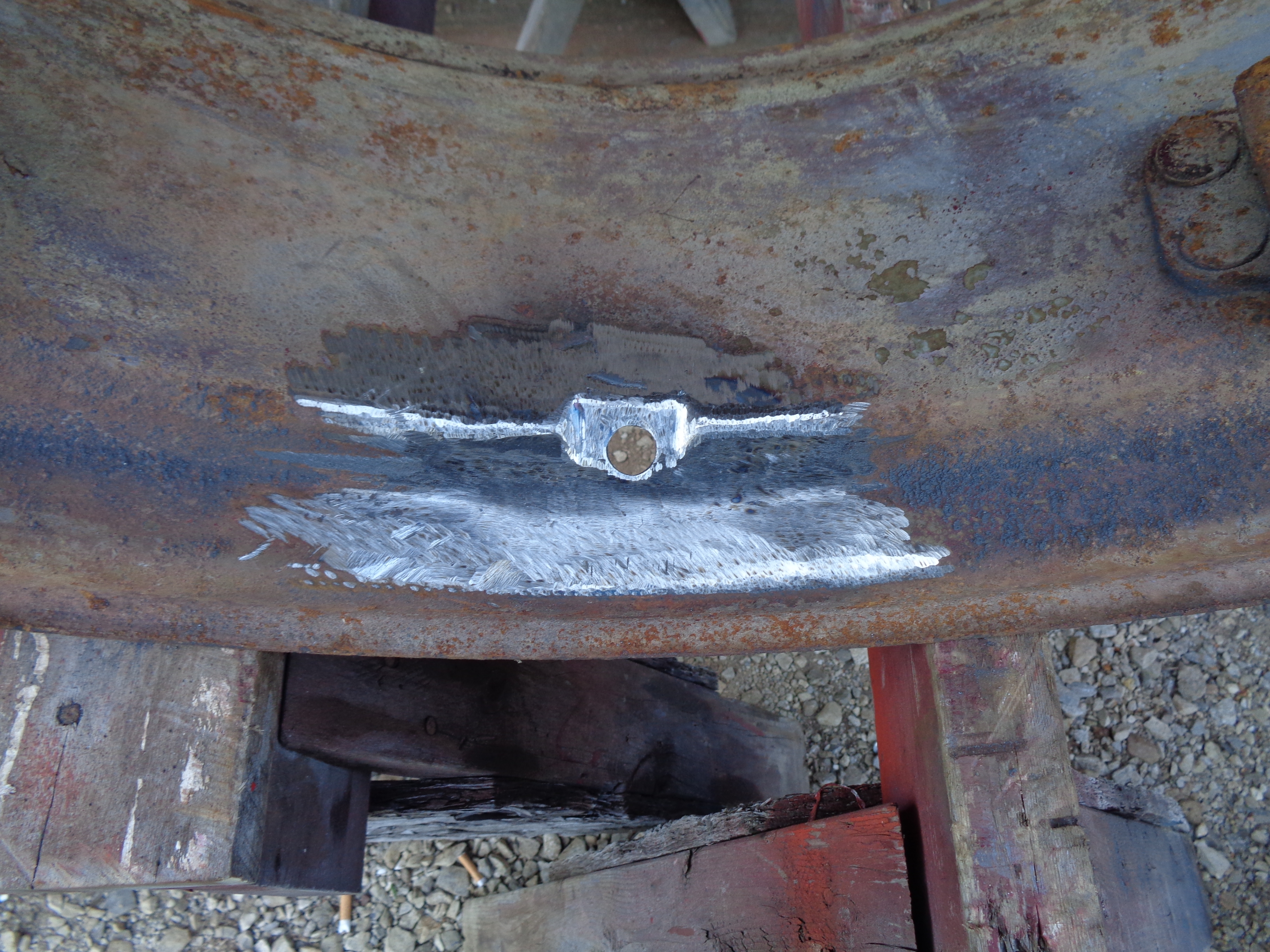

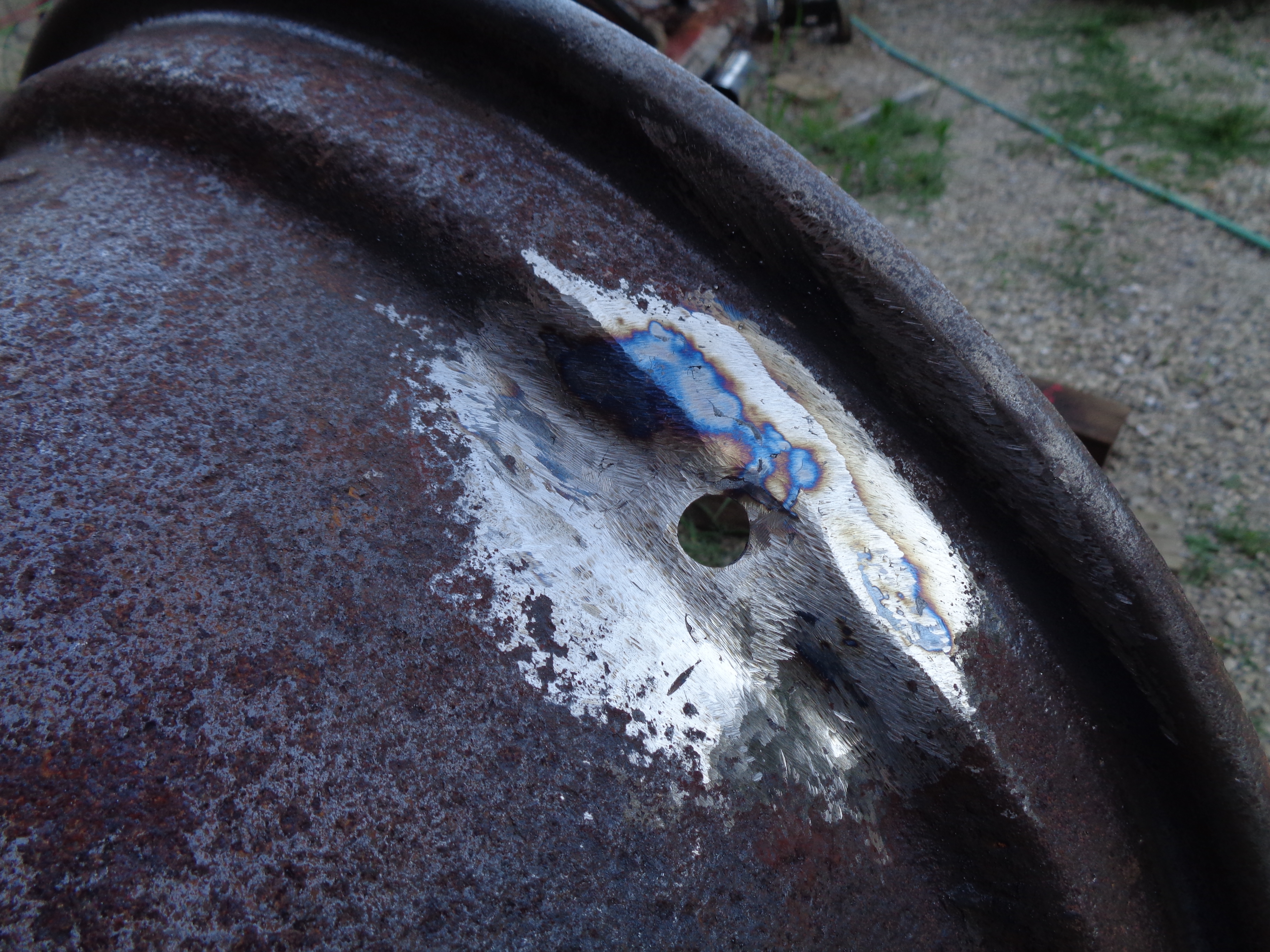

What width rim is on yours now..?? I'll assume 9". You might check some salvage yards for rear rims off a 100,130, or 140 Farmall. Or, if yours isn't too awful bad, have it sectioned by a weld shop or DIY.

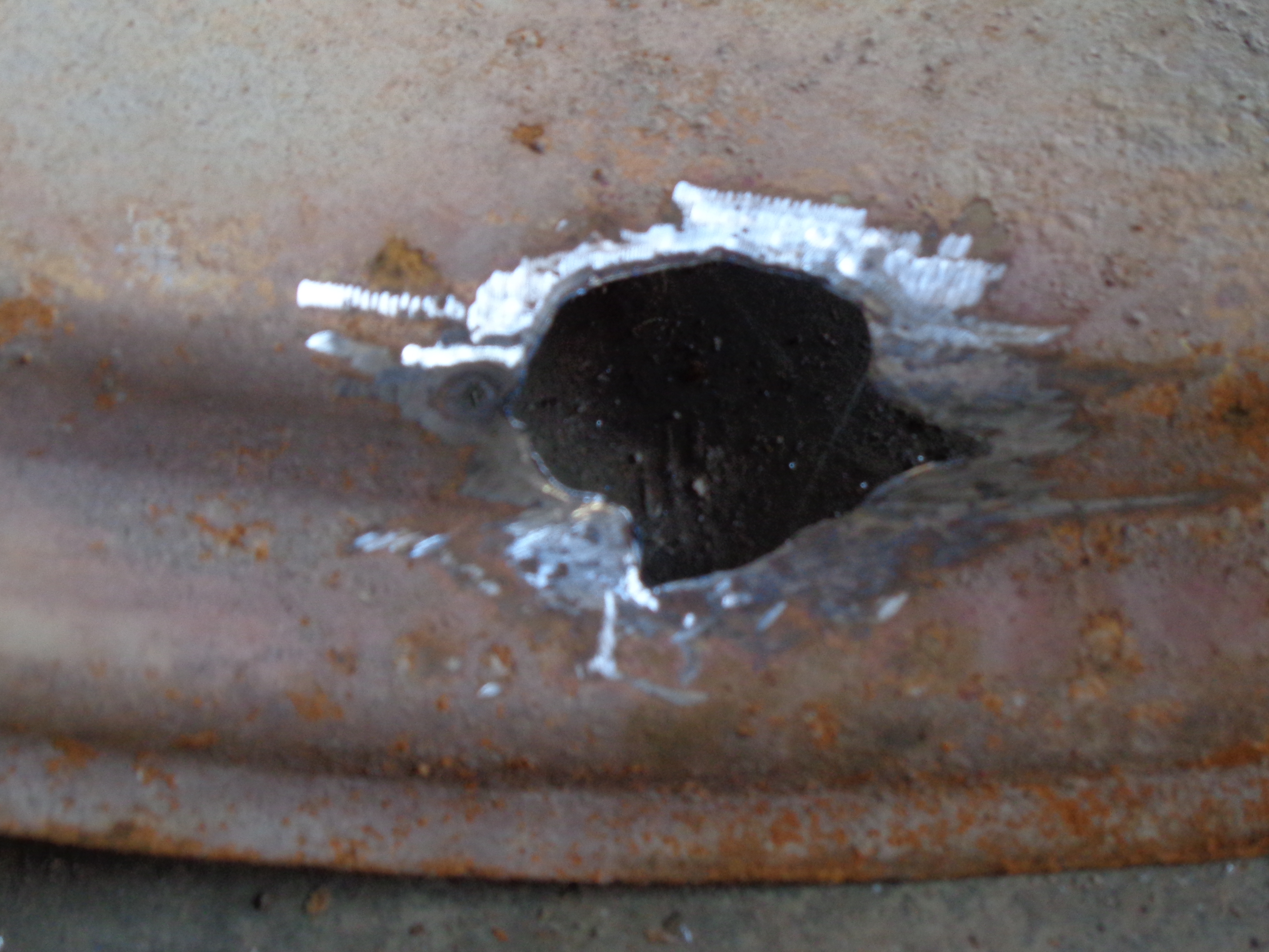

One rim on my 140 had rusted out around the valve stem hole. I cut out the bad and filled in with weld with my MIG welder using multiple passes, then used a heavy 5/8" washer welded in for the valve stem hole.
Yes, it took me 3-4 hours to weld it up, and grind it off, and not perfectly on center on the outside but did not affect it other than looks. Sure beat $250-$300 for a new rim. And I preferred to keep the OEM loops so as to use the square head bolts.

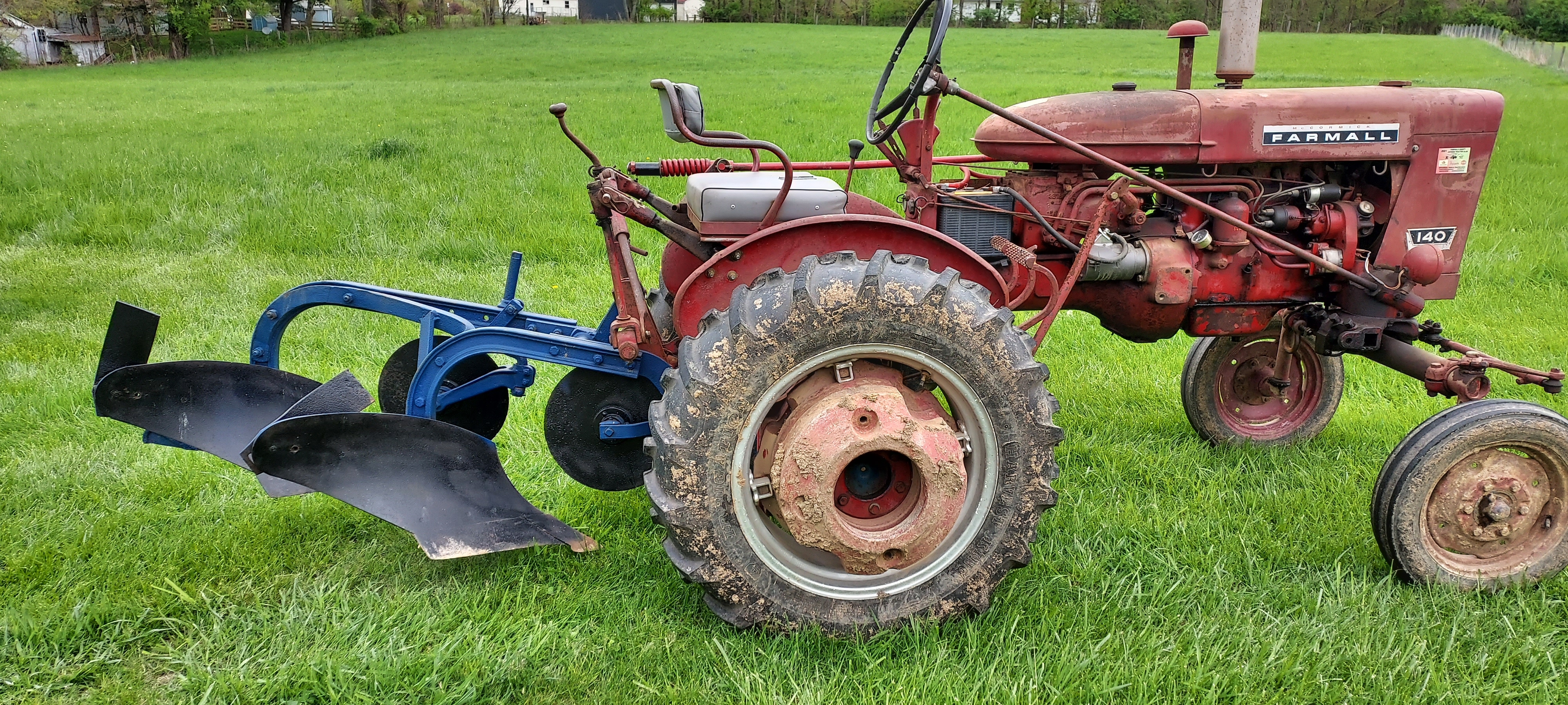

This is the same 9" rim with 12.4-24 tire mounted on my 140.
