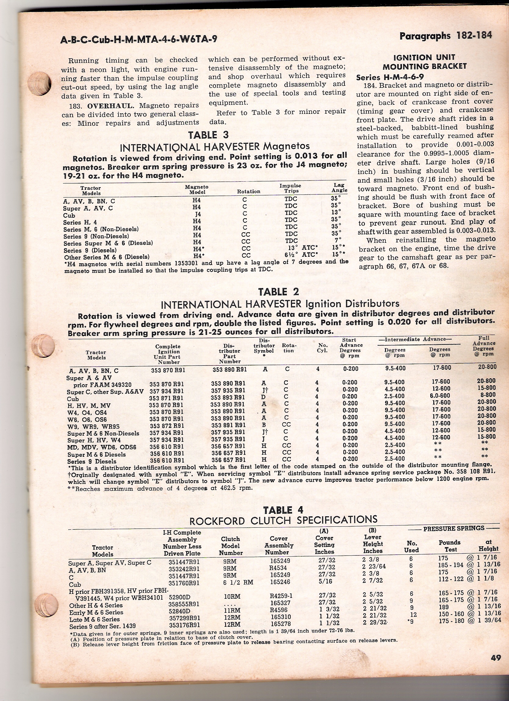

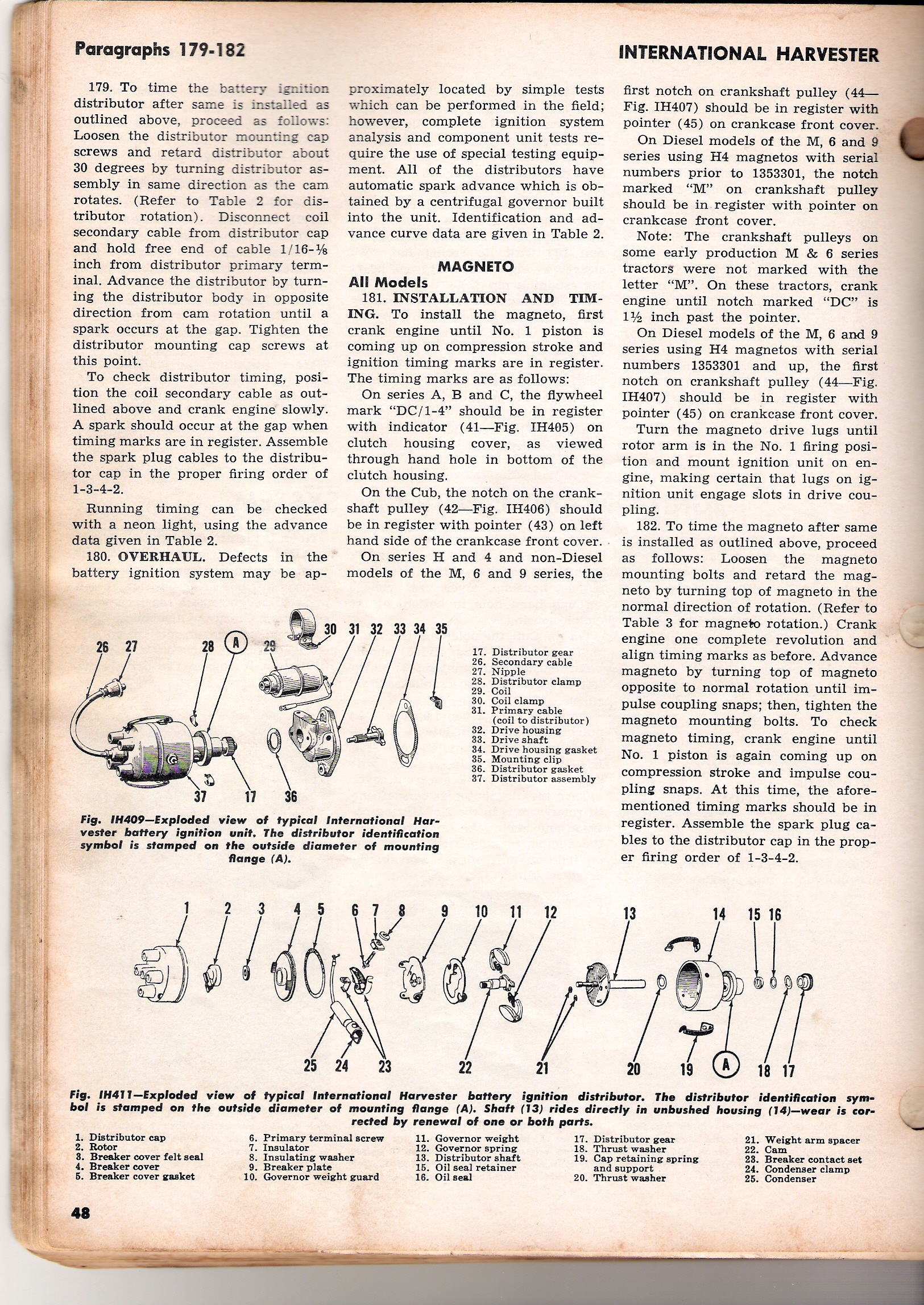

If your not sure on how to time your mag, or want to check it, here are the instructions below per the I&T manual. If you do know, and have it set properly, then maybe someone will run across this, and find use for it.
