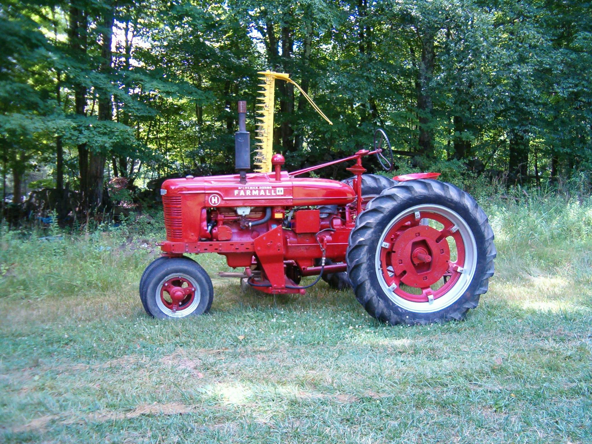

Hello All,
I am hoping that someone with sickle bar mower experience can help me understand what is going wrong.
Background information: The tractor is a 1941 Farmall H that my great grandfather purchased new. The tractor was restored about 5 years ago and looks and runs good. The side sickle bar mower was restored at that time also (not sure of the model number on the mower but I did find this number on it 464077-R1) and seems to run like it should until we try to mow with it. When mowing we open the throttle and run in 1st gear. The problem is that when we mow the fields, the grass gets all jammed up in the mower and doesn't cut good. Unfortunately anyone in my family that might have been able to help is no longer with us.
Questions: What do you think is going wrong? Any suggestions as to what to try. We think but do not know for sure that the blades are sharp. We also think that we are running at 540 PTO speed. Any thoughts as to what model number the mower is or where id of the mower might be located?
One other thing that I should say is that I am not very experienced with this tractor and this style mower so the problem may be very obvious to someone with experience. All I can say is that I can not wait to learn. Thanks for your help.

The first thing to check is the amount of wear on the rock guard ledger plates. If the serrations are gone, you can replace the ledger plates or the rock guards. The second thing to check is the hold down clamps. These come up from the back usually held on by 2 bolts. They should press the sickle blade down aganist the rock guard ledger plates. To adjust remove or add shims or use a hammer to peck down. I noticed in the picture that the sickle bar looks bowed. It may be a optical illusion, however, if the bar is bowed, it will need to be straightened. Ken Sweet

I know this may sound funny but your knives might be out of time. Basically when the knives are at the end of the stroke they should be lined up with the guards. If you read the cub mower's manual it should give you some good ideas of what to look for and what I mean about timing the knives.

Looks like someone sprayed yellow paint all over that sicklebar. Not a good idea.
I'd take a squirt can with light weight motor oil and spray it all over the sickle sections (the triangular parts) and the guards (the pointy things). Then just run the mower for 15-20 minutes with the tractor stationary. After that try to cut with the mower. If it still jams, then you will have to check the alignment of the sickle sections and the guards (assuming the cutting edges aren't worn down too much).

The mower items seem to have all been covered. If this is to be used for serious mowing I'd suggest replacing all the ledger plates and the bar knives. Take plenty of tine to get everything shimmed up proper. :thumbsup:
We used to sharpen the knives daily when mowing hay.:D
