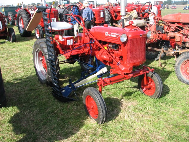

Engine will be built by International Harvester Company. It will be a C60 .These are a 59.5 cubic inch four cylinder engine.This is a sleeveless engine.
The Cub was built from 1947 and continued until 1979 in one form or another,so parts are not too hard to find.
Steiner tractor parts or OEM tractor parts have lots of parts avaliable for the Farmall Cubs. Some parts are still avaliable through Case IH dealers.
Below is a 1950 Farmall Cub.
Hope this is of some help.
