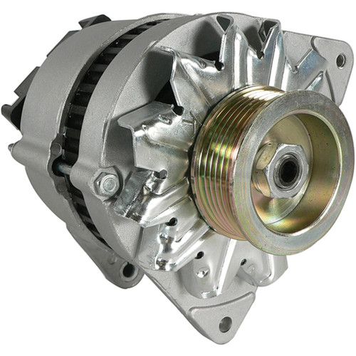

I ran into that problem a few years ago with a Workmaster 75. Same Iskra alternators that didn't last two days. I ended up putting one of these on it.
Same frame style, fit right on. I think I had to swap pulleys, one had one more groove than the other. Also had to add a circuit with 250 ohm resister to compensate for lack of a battery temp sensor.
Tractor has running with it ever since.

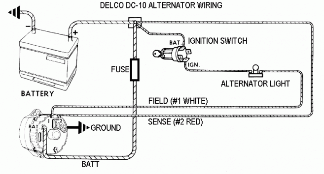

IF alternator in "Internally regulated", one of the two smaller wires is a +12volt supply to initiate the charging cycle of alternator, and second wire generally goes to the "ALT" lamp on dash panel... Generally the alternator puts out a ground on "ALT" lamp lead ( key on but engine off) as other side of bulb is supplied with 12 volts... As alternator spins up it applies 12 volts on "ALT" lamp terminal and once voltage from alternator reaches same as battery voltage on other side of lamp, current flow stops and lamp goes dark indicating alternator is charging.......
Wiring is pretty similar as
in image below...
