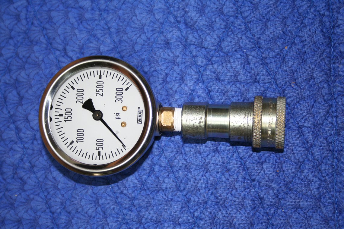

You might try putting a gage on the cyl hose work ports and see if your cyl's are developing the pressure. With the cyl at full extend or retract, you should see the PRV relief pressure.
Gage test set, about $30.
