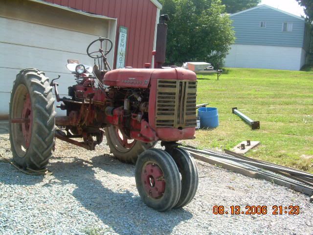

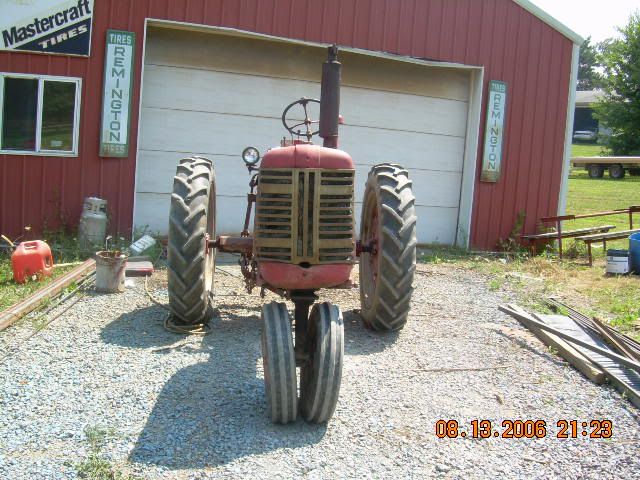

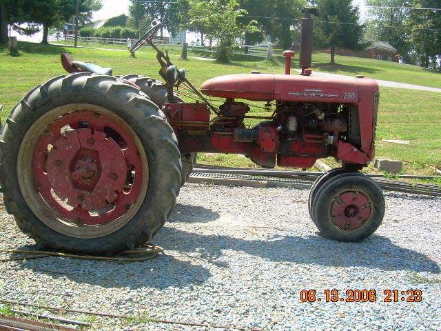

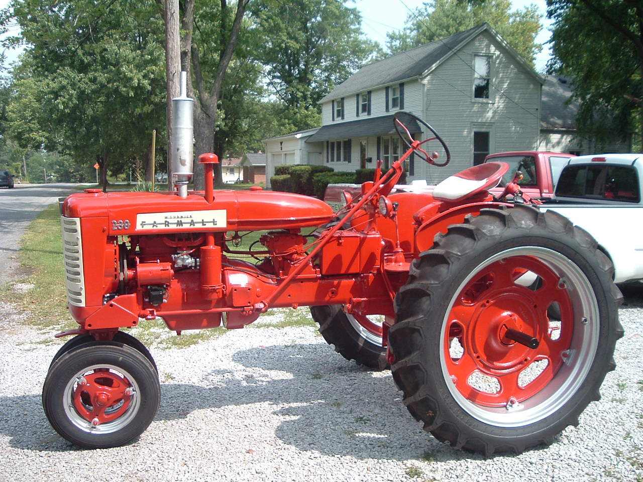

Well, I'm pretty sure I'm gonna restore it this winter. For the past few days I've been gettin all the grease and grime off of the engine which is a PITA. I'd never thought it would be that hard to get off. Last month I put a new clutch plate in and a throw out bearing. Then I found out that that wasn't the problem so had to put a new gear in the tranny.

Welcome to TBN.
That machine looks to be in pretty good shape. I look forward to seeing your progress. I really enjoy watching the restoration process in action.

Thanks. I LOVE it. It runs great and does anything you throw at it. Well, at least for all I do with it. I use it for my boat storage, but some boats have been sittin for 20 years and burried in the ground pretty deep. All ya gotta do is put it in 1st and put it to full throttle and it comes out. I'll be sure to post pics of it during the restoration. I think it looks 10x better just by cleanin it up.

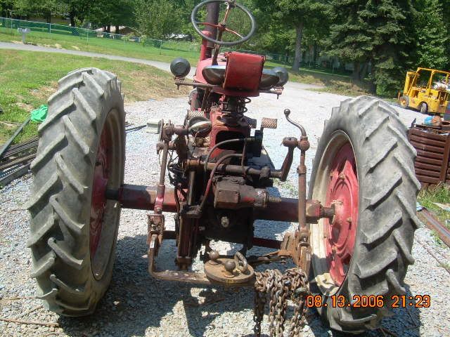

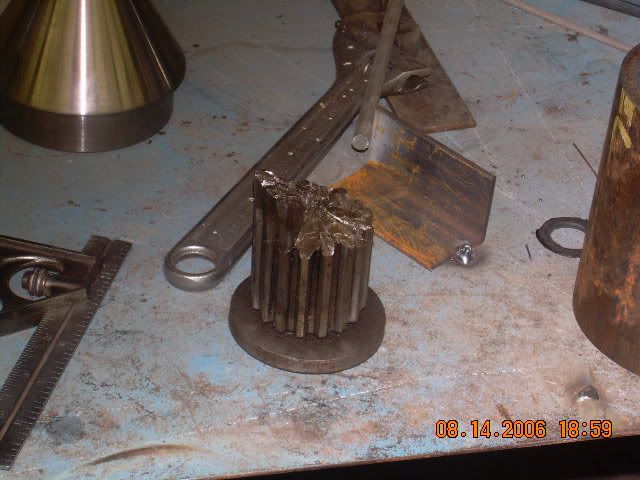

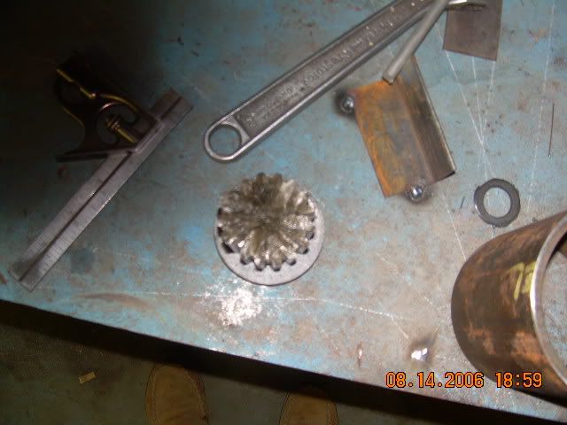

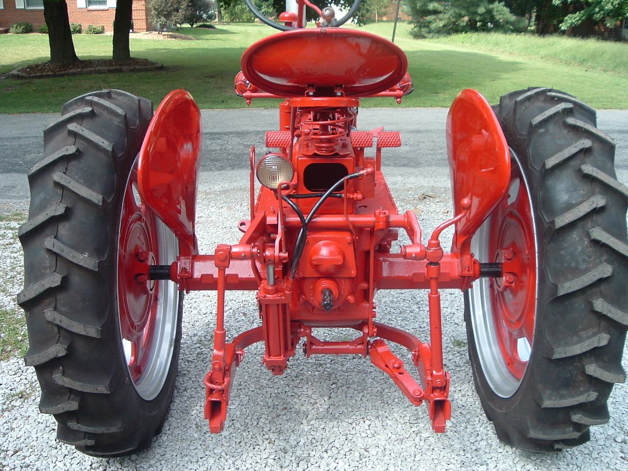

Well, the clutch wasn't too too bad. Just had to take the starter out, support the front and rear for when you split it and the whole clutch was right there. Now the gear, that's a different story. You have to unbolt the seat, and everything around it, take the whole rear off and support it somehow. Then you have to take the brakes off. It's alot of messin around to do it. When I got the gear, the guy said that it was common for those tractors to do that. But I guess I have to remember, that's a whole 20HP to the ground. LOL. Tomorrow, I'll get some pics of the gear that broke.

Oh, I almost forgot about the gear change. I also had to get a new axle cause of the gear that broke.
