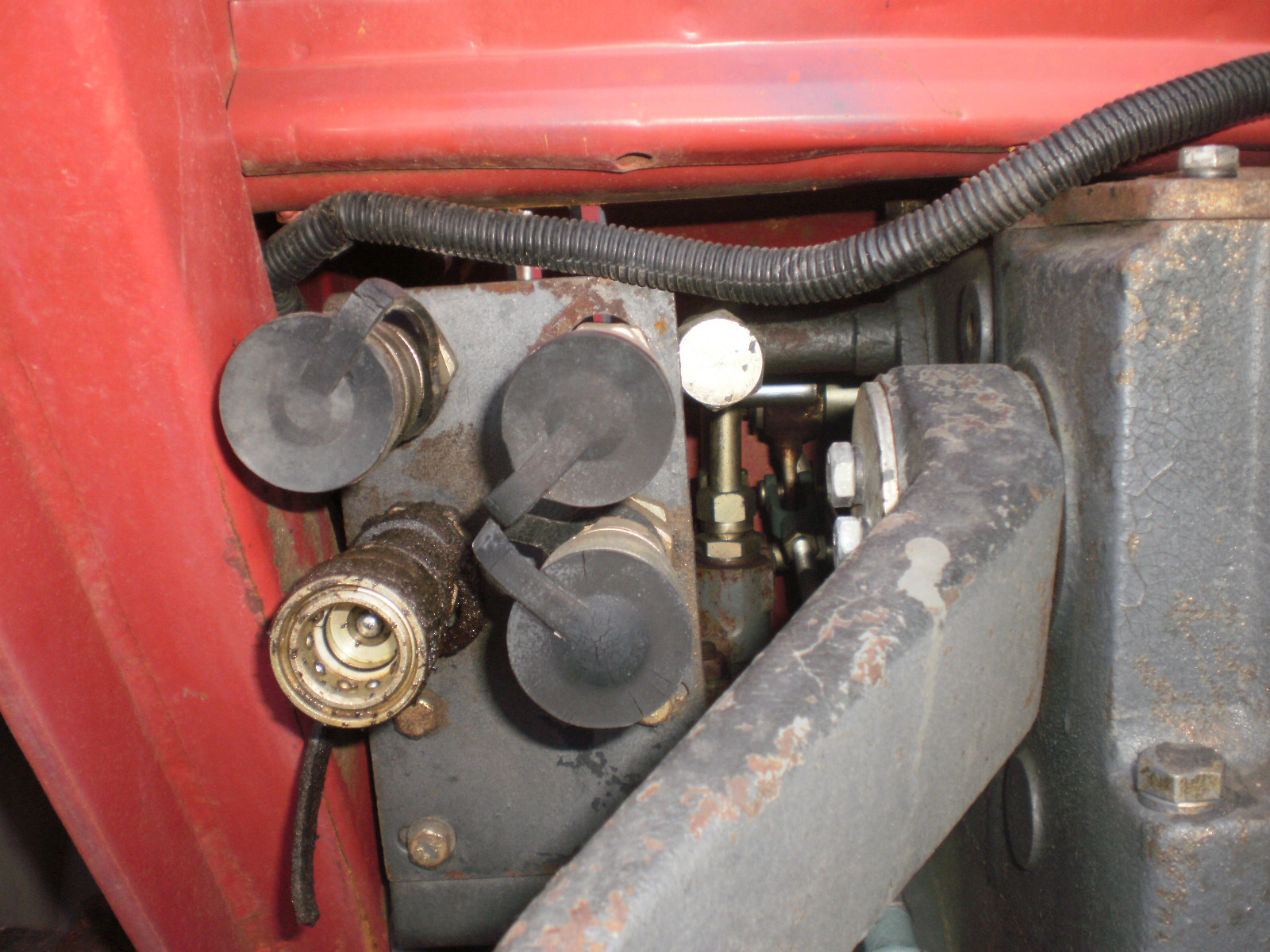

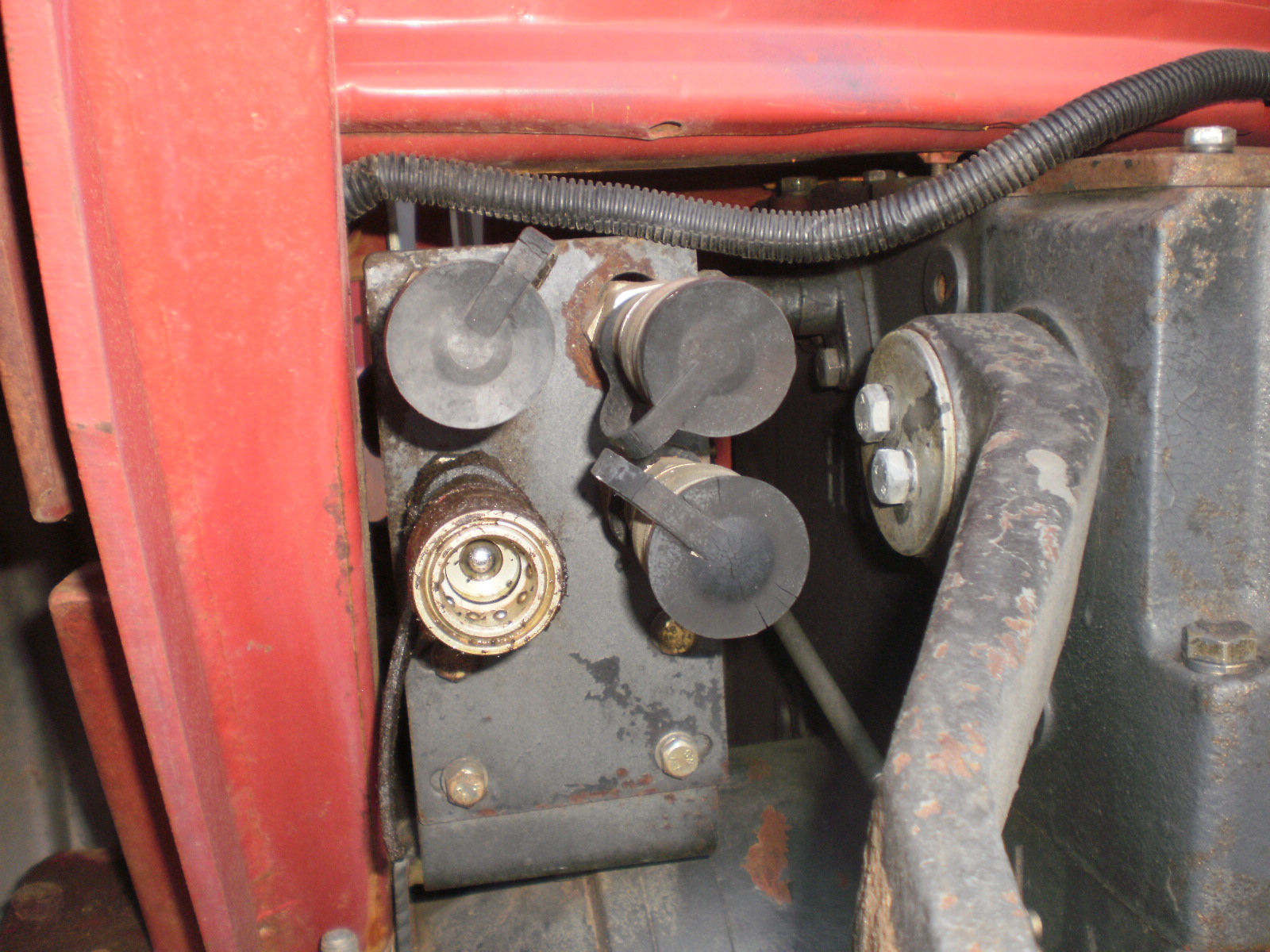

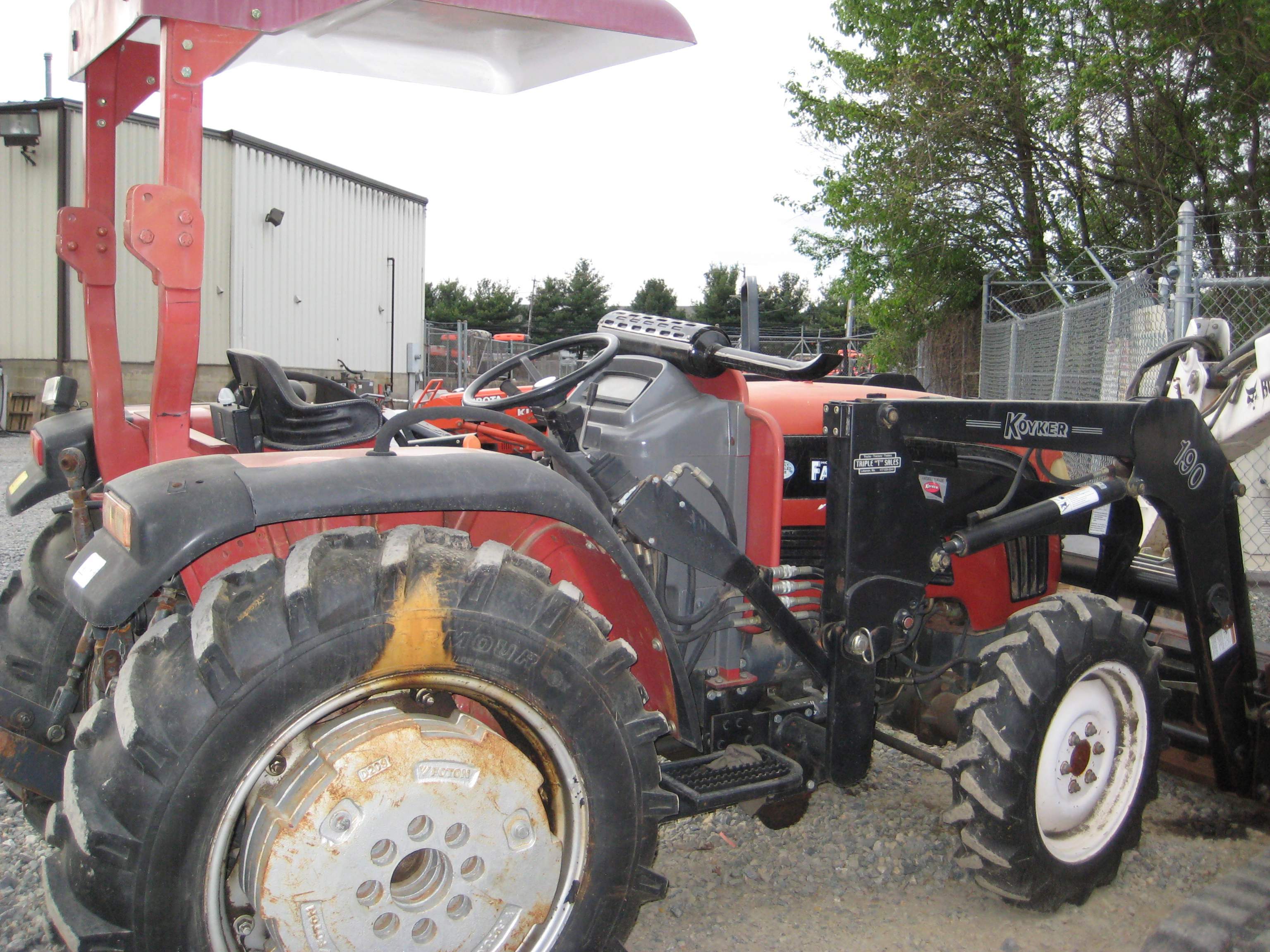

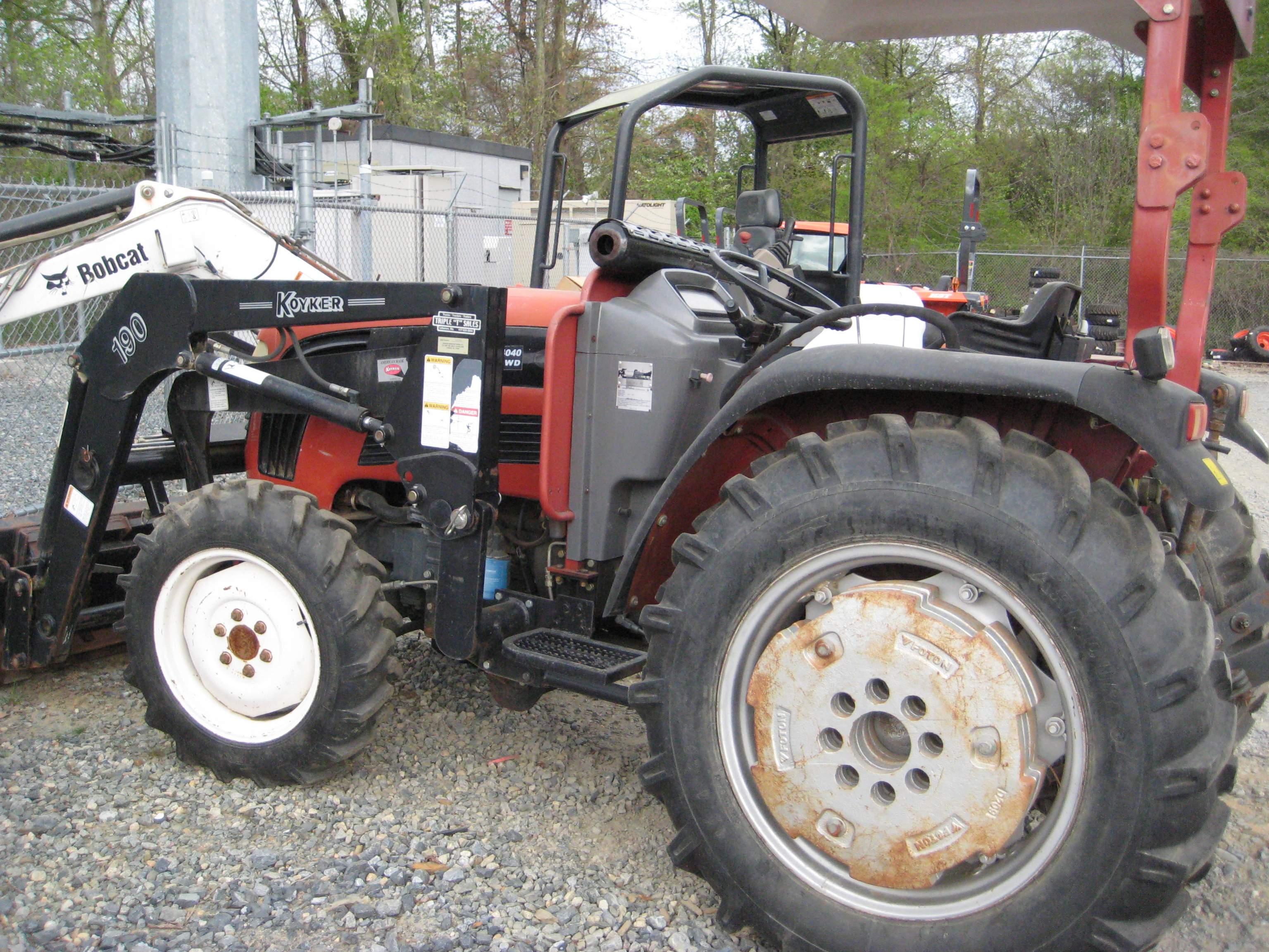

Thanks for the responses guys, keep them coming...I won't get a chance to try anything tonight because my daughter has a school thing I have to attend, but I'll be back after it on Wed. I am too hoping that I don't have to dive in to the fluid reservoir, but if necessary, we'll do what we have to do.
I don't have the manuals yet, but the guy that I bought the tractor off of supposedly does and will be sending them to me as soon as he gets a moment.
I've attached some pictures so you guys can take a look. Any suggestions, info. or direction you guys can give me will be greatly appreciated.

Looks to be in good shape. Too bad we're not closer, I enjoy helping out on projects like that.

Foton FT404 FEL
These are pictures of our FT404 which have 2 pair of QD fittings, plus a single one-way pipe also with a QD fitting.
As you can see, the leftmost pair is connected to the FEL hydraulic tubes. In order to operate the FEL, while sitting in the driver's seat, you must lock the leftmost corresponding lever in open position with eg. a rubber cord shown on the second photo. But in order to operate the rear 3 pt hitch, you must disengage the rubber cord and put both valve levers in mid position. That's how the hydraulics works on our set up. The advantage is that mounting/unmounting the FEL hydraulics is simply by disconnecting the two hydraulic hoses.
Now I see your Koyker FEL is directly plugged into the tractors hydraulic system, with either parallell or serial connections to the 2 pairs of QD fittings. Does controlling the 2 pairs of QD work? Those people who mounted the Koyker loader should know. Your way of mounting the hydraulics for the FEL is better than ours, so I'm interested in your results, as it will enable me to free up one additional set of QD fittings.
