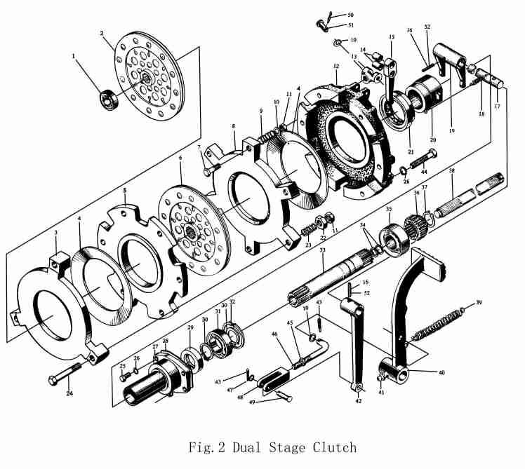

I will check everything again to make sure all of my settings are correct. The only thing that is different on mine based on the photo attached is that on my clutch friction plates, the center hole lip that protrudes outwards, is facing the rear of the tractor and not the front as it appears to be facing in this photo.

The parts diagram is helpful for visualizing what's going on inside the clutch, and I'm going to take back my answer in post #2, I don't think having the clutch out of adjustment can cause the problem you are having.
Just to get us oriented: pieces #5 and #12 don't move and are bolted to the flywheel. #2 is the PTO clutch, and it is squeezed between the flywheel and #3 by the spring, #4. #6 is the drive clutch and it is squeezed between #5 and #8 by its spring #10. When you push on the clutch pedal it pushes on the bearing #21, which pushes on the three fingers #15. They are attached to #8 by the three bolts #7, and the fingers pull #8 toward the rear of the tractor, which releases the pressure on the drive clutch disk and allows it to spin. #8 is connected to #3 by three bolts #24, and when #8 moves toward the rear of the tractor, once it has taken up the gap it moves #3 toward the rear of the tractor, which frees the PTO clutch disk to spin.
So there is no way that the PTO clutch can release if part #8 isn't moving toward the rear of the tractor. So even if the gaps on bolts #24 -- the PTO gap adjustment -- aren't set properly it only affects PTO clutch operation. It shouldn't affect the drive clutch.
I can see two possibilities. One is, as you mentioned, the clutch disk #6 is in backwards. It slides on the transmission input shaft #33. If you look at the picture the shaft only has splines for a short distance. It is possible that with the disk in backwards there is no room for it to slide toward the rear of the tractor, so that when #8 moves toward the rear of the tractor the clutch disk remains firmly pressed against #5 and the clutch remains engaged.
The other possibility I'll mention because I had it happen to me. When I replaced my clutch I put the PTO clutch spring #4 in backwards. When I did that, it got cocked at an angle and kept the PTO disk against the flywheel even when #3 moved toward the back of the tractor. If spring #10 were put in backwards the same thing could happen, but to the drive clutch instead.
Unfortunately both of these possibilities mean splitting the tractor again. Before doing that I would watch through the access hole while a helper pushes on the clutch pedal. You can see the pieces that are supposed to move, and make sure that everything that is supposed to move is moving and nothing that isn't supposed to move is moving.

I went out to the barn last night and took a look again at the setup. I first marked the location of #8 with a mark on #12 to see if #8 moved when the clutch was applied. It didn't. It appeared that #8 was not centered on #12 and possible being held up enough by abutting on #12. I loosened the bolts and tried to center #8 on 12 and freed it up enough to move a little bit but not enough as I still can't engage the gears. Today I will split it again and check my clutches to make sure they are in correctly as well as making sure everything is symmetrical when I put it all back together. I know that the springs are in correct as they have to fit within the groove of the pressure plates. I'm still thinking that it has something to do with the clutch plates. More to come..... Thanks!
