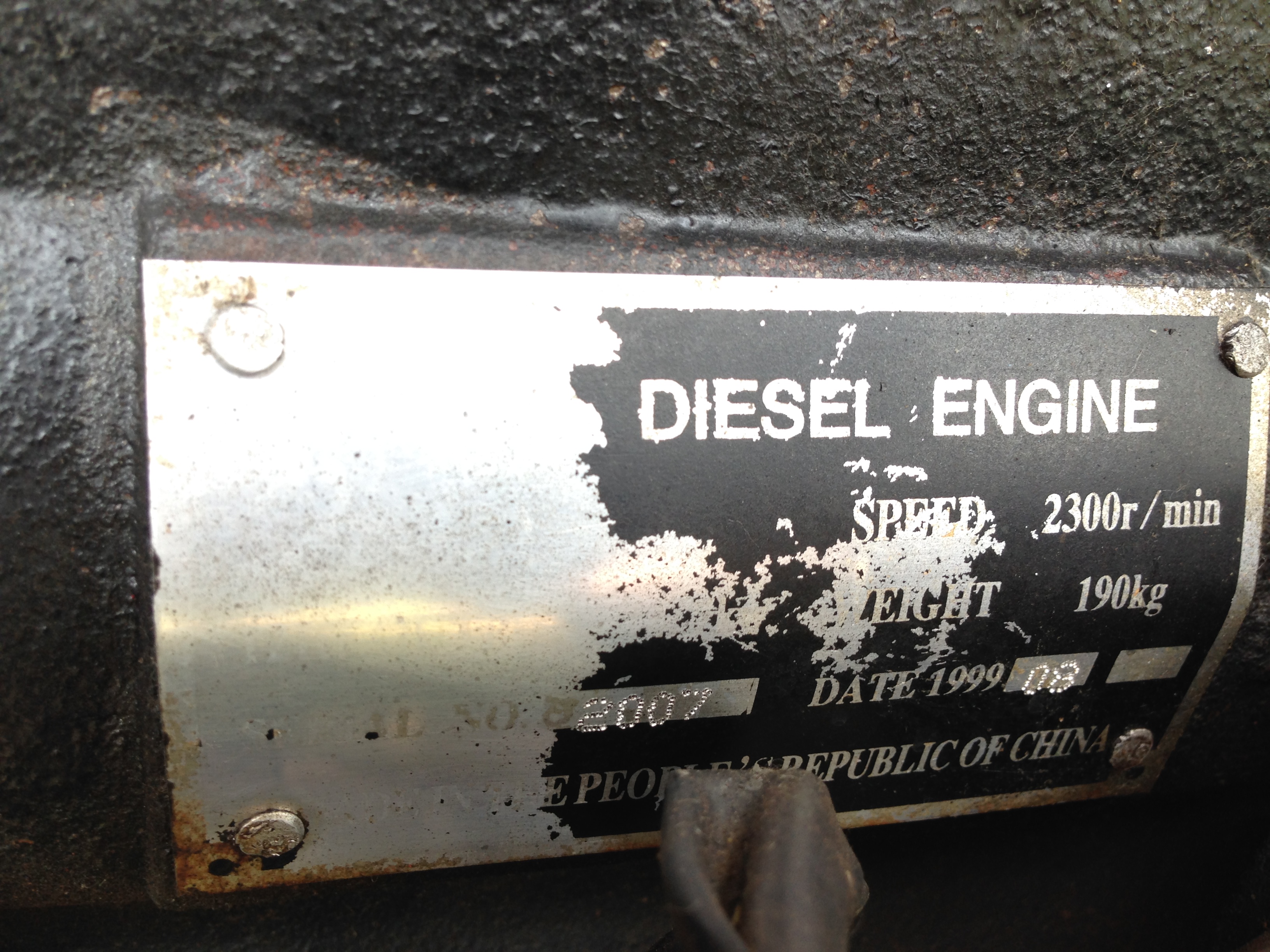

Hey folks, this Farm Pro 2420 tractor was purchased second hand. Did not come with a manual or what so ever, I am trying to figure out the engine model so I can make some parts purchase. Can someone help me to identify? The tag is worn out so can't read half of it, there's no stamp anywhere else. IMG_2250.JPGIMG_2249.JPGIMG_2251.JPG

I think that's a TY290. You may want to do a google image search and compare what comes up with your engine.
The naming convention for Chinese diesels is the letters are a manufacturer code, the first number is the number of cylinders and the last two numbers are the cylinder diameter in millimeters. So the TY290 is a two-cylinder engine with a 90mm (3.5 inch) bore.

Thanks, I think it is a TY290. I've searched for the water pump and it look exact like mine.
