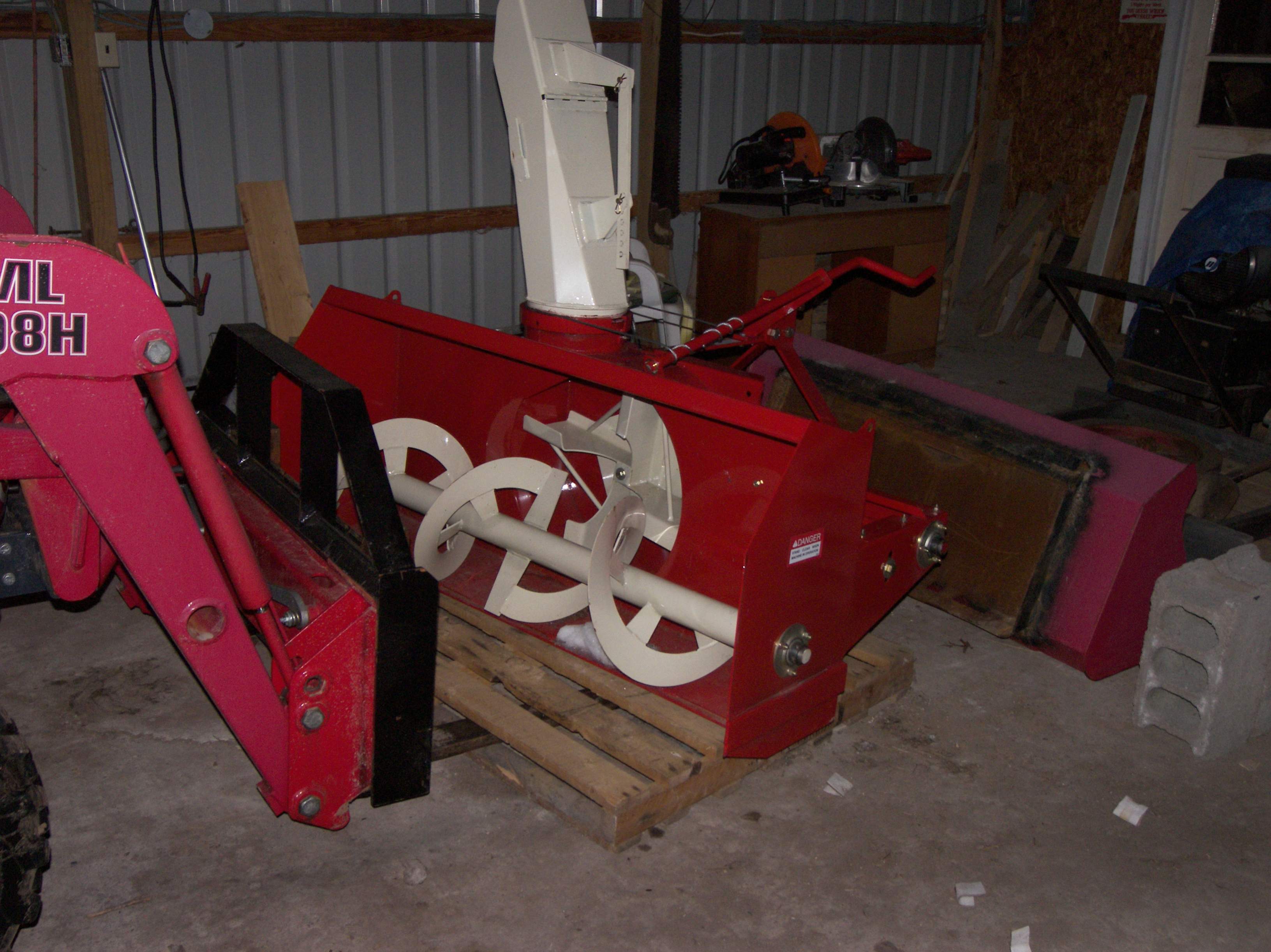

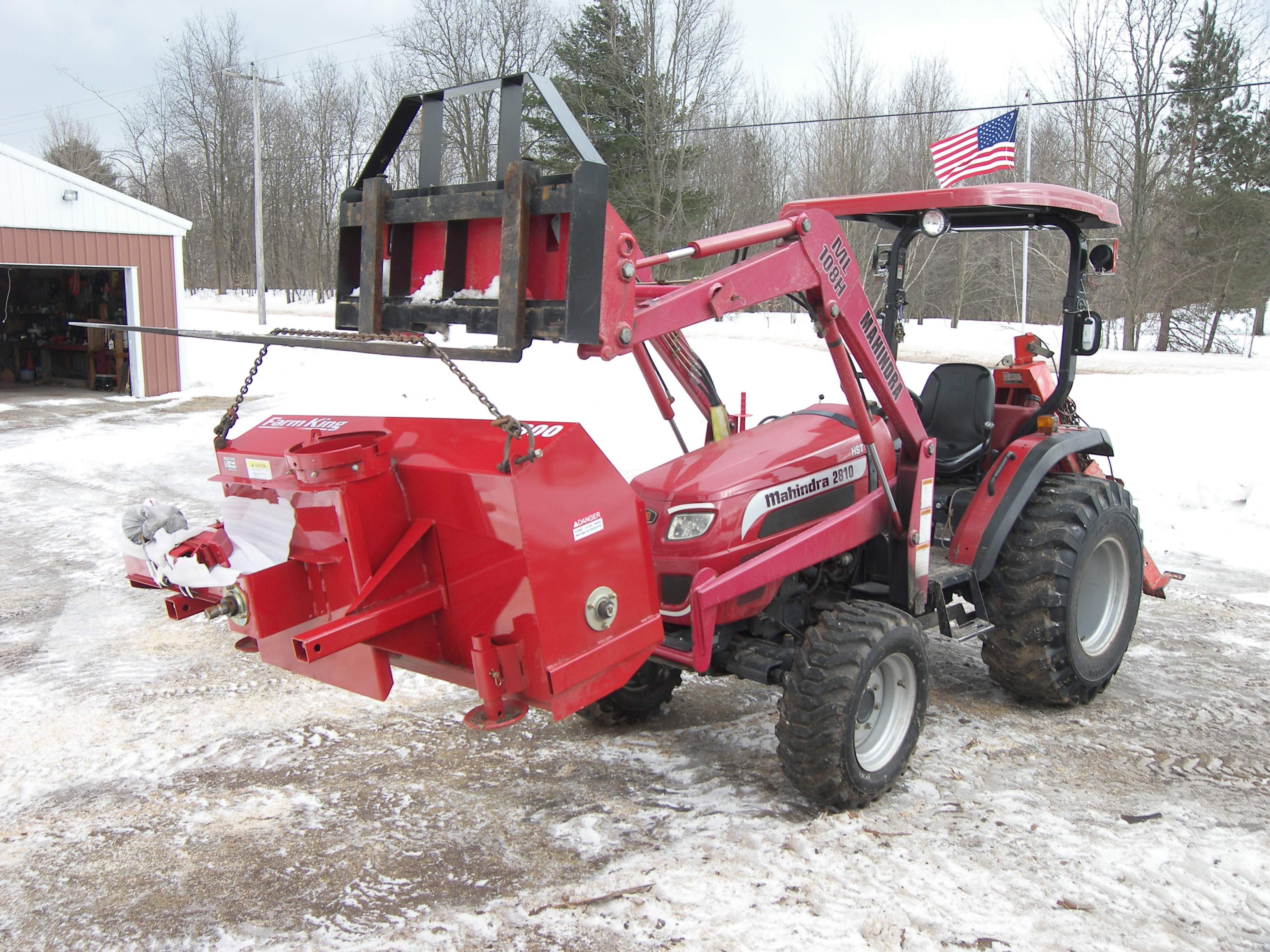

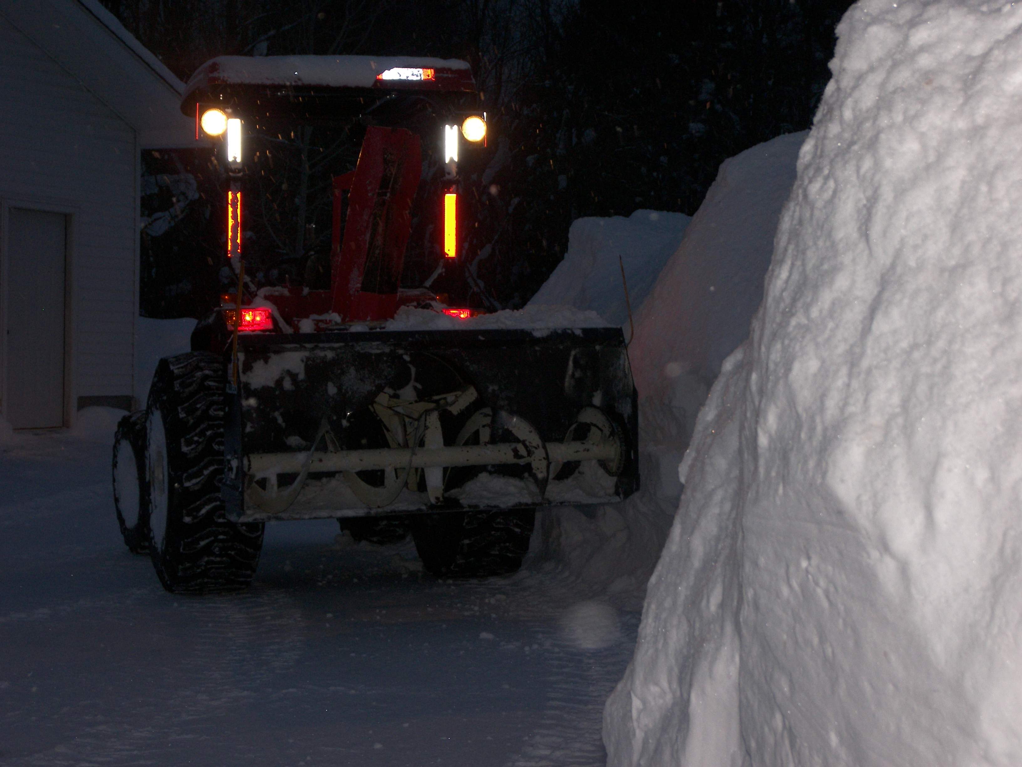

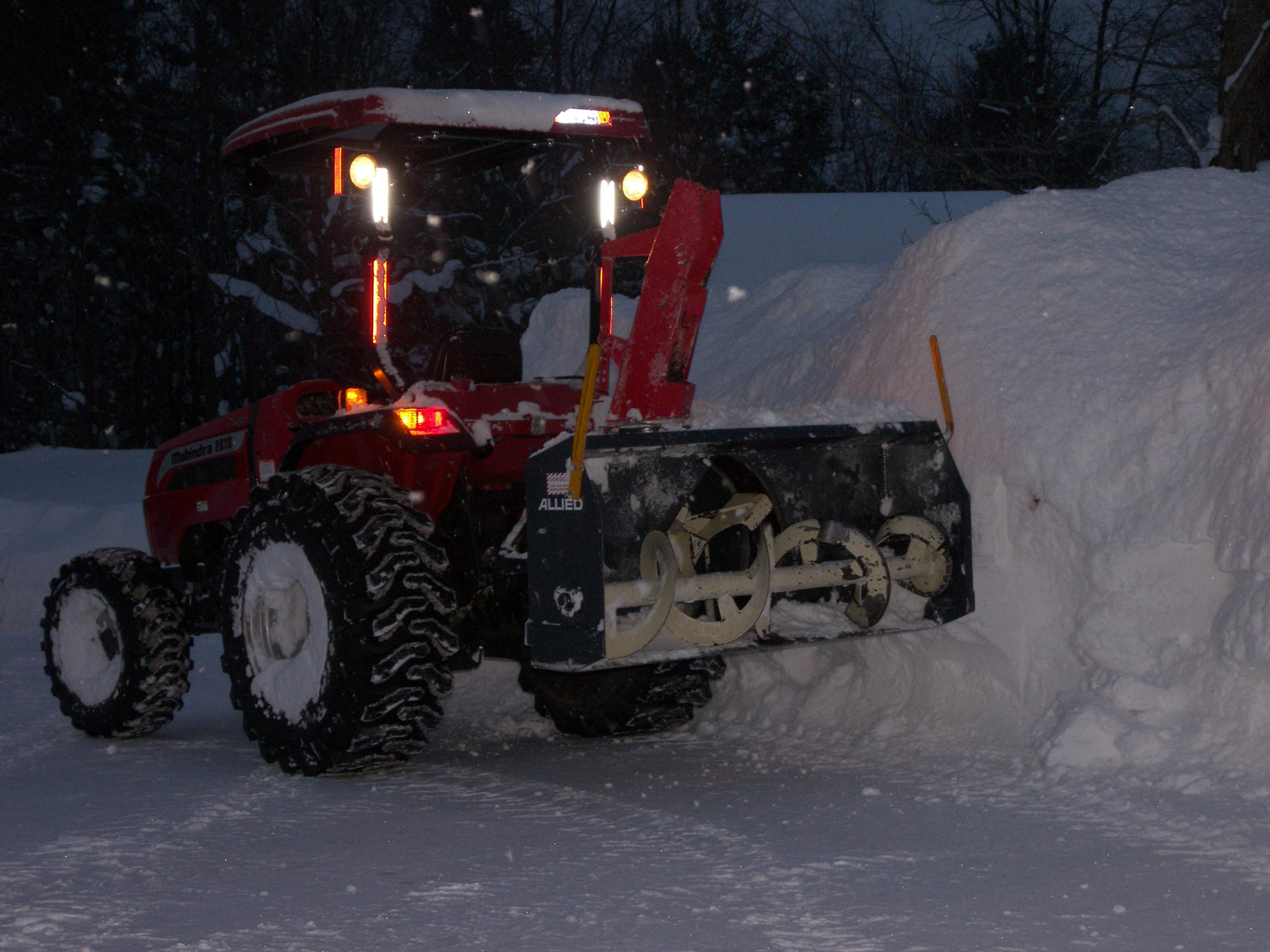

Good day, I have had an Allied/ Farm King 600 for 16 or more years on the rear of a MF, 2810HST Mahindra, and now its going to work with my Kioti DK35SE HST and loader. Last Feb. at the Syracuse Farm Show I bought a new on for $1600. I couldnt pass that deal! The first one kinda wore out. Each day in the winter when it snows it plowed over 2 miles of driveways, all of which are gravel. Yes i have replaced bearings, gears ect. but this machine gets used to the max. One storm it run 24 hours a day. Neighbors call my blower the "Snow blowin, stone throwing, rock crushing, driveway leveling, BEAST" , It's ate a couple of mailboxes, lots of rocks, mud, brush and lots of stuff thats not good for it thats barried beneath the white blanket. . After that many years of service (or abuse), its wore bad. I gave the old one to my uncle, there doing some work on it and they are going to use it this year.
The new one hasn't seen any snow but i'm still hoping and its still early.
Yea ! i'de buy another, there good machines. . . John :thumbsup:

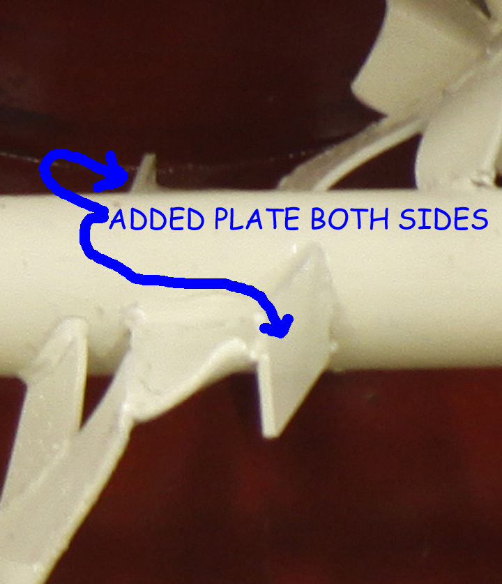

I had an older model (maybe 6-7 years old) farmking 60" blower and it worked very well except for 2 issues that i had with it.
1. I'm not sure how current models are made, but mine had three, 1/2" diameter metal rods that supported the impeller arms. These bent fairly soon and i had to replace them with 3/4" rods. These held up for the life of the blower.
2. I had the tips of the auger flighting bend on both sides. I ended up welding 2 edge gussets and this really helped the problem.
Granted, i have lots of rocks that seam to grow during the winter. I clean up all the area before winter snows hit, but ^%$# if i don't suck up some boulder.
