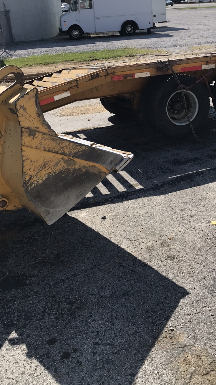

/ farm ,highlift jack #13
I hate those things. If I need a high lift jack I’m using a less deadly approach. IMG_7600.JPG
