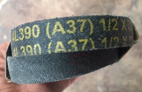

What's the part number for fan belt for YM2000D? My manual for YM240D doesn't list number. Think I can get it locally (there is a John Deere and a Yanmar [new] dealership in area)? Regular car parts store? Thanks.
Edit -- looks like it's a 37. Will check local dealers.

just pull it off and take it to your local auto parts store to match it. probably way cheaper as well. they arnt anything special.

Thinking it is an a37.

A 37. Picked it up at local AutoZone for $9. Lawn equipment type belt.
