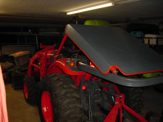

Nov 20, 2005 / Falling Object Protection pictures? #4 Maine_Polack Gold Member Joined Nov 2, 2004 Messages 358 Location Central Maine Tractor Mahindra 6500 4WD iurl] This one s still in the making... I gleemed the idea from "Red Rocker". It was to make the whole thing fold down to get in garage if neccessary. All four "connection points" to be pinned together. The ones attached to the ROPS are top link ends. It is made out of 2" square tubing, with 3/16" wall, because I found some used. The canopy itself is Alum, because I had it. I have made an expanded metal piece to cover my back, and expect to make one for the front, and sides, that are easily removeable. More info? PM me. Also look up "Red Rocker"'s posts on his set up, as he has posted a bunch of pics.

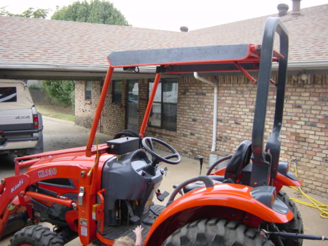

Nov 21, 2005 / Falling Object Protection pictures? #6 RedRocker Veteran Member Joined Apr 28, 2004 Messages 2,188 Location Bowie TX Tractor Kioti CK30 HST, dual remotes, FEL. Here's what I came up with. Attachments 775059-Kioti Canopy1.jpg 60.6 KB · Views: 456
Nov 21, 2005 / Falling Object Protection pictures? #7 RedRocker Veteran Member Joined Apr 28, 2004 Messages 2,188 Location Bowie TX Tractor Kioti CK30 HST, dual remotes, FEL. Folded Attachments 775061-DSC00340.JPG 60 KB · Views: 348
