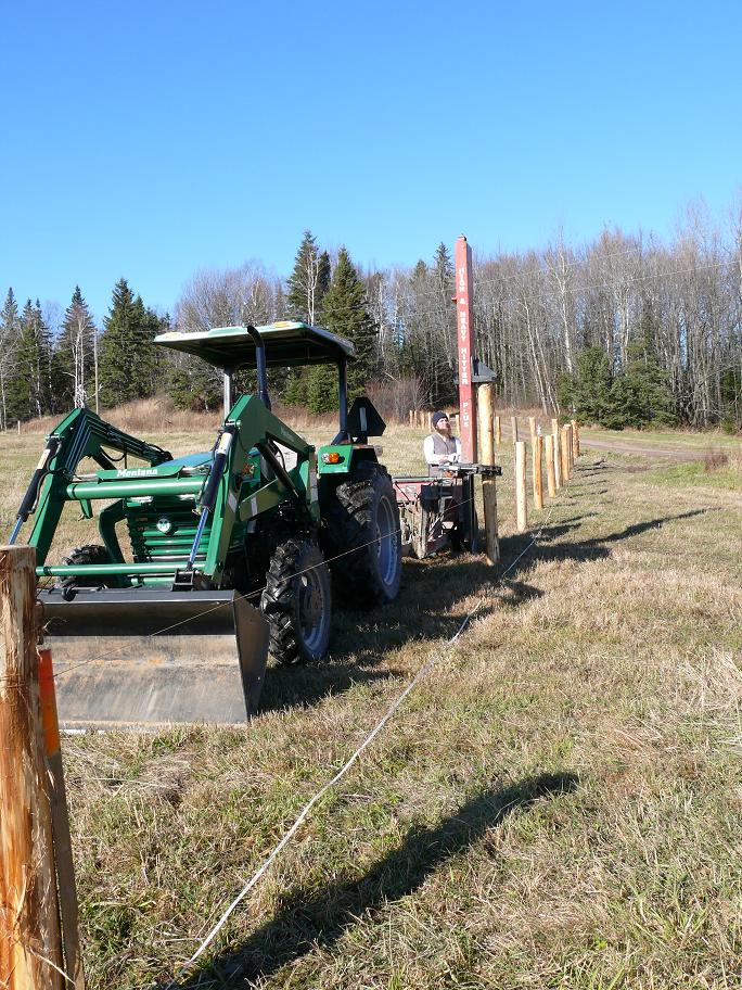

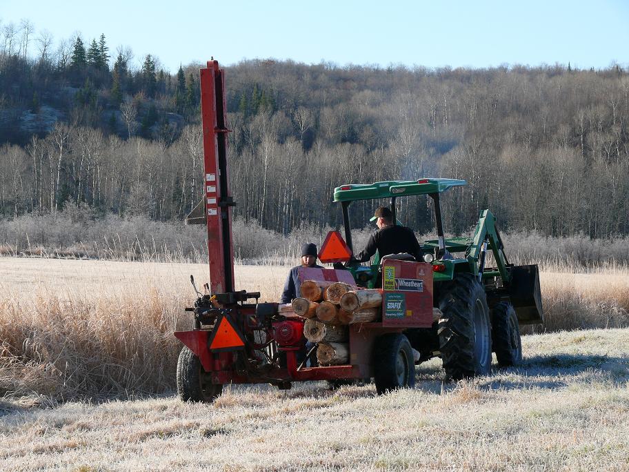

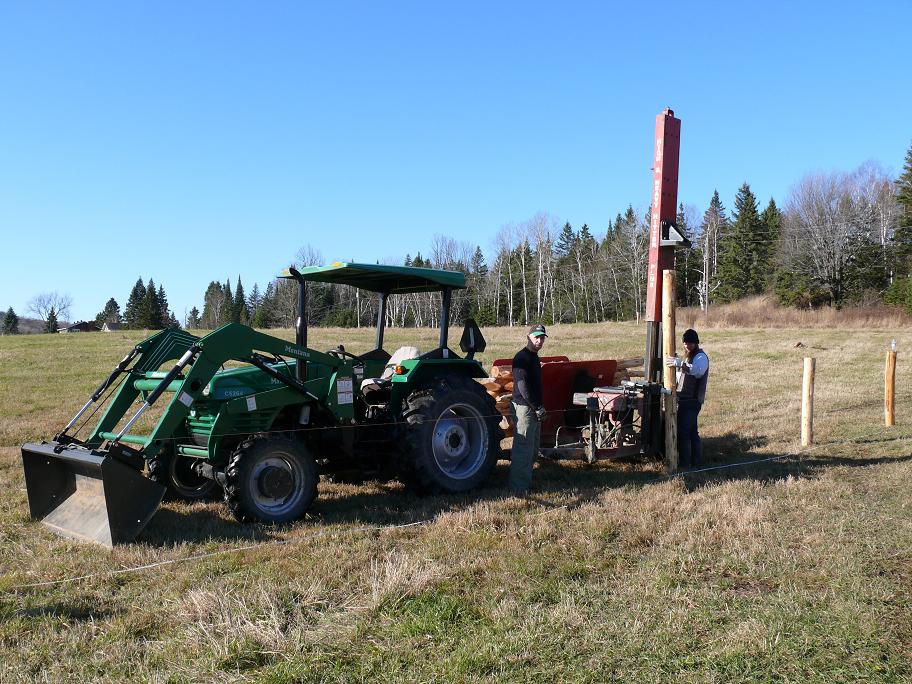

Hired the post pounder and local guy again to put some more paddocks in (take advantage of the good weather). I ran the Tractor, loaded posts, etc. Sam did the pounding. Day started a wee bit Frosty (-7) but got up to a Balmy 12 degrees (Tshirt weather). We pounded 92 posts in 8 hours. The Montana 5264 was the tow vehicle as you can see. We're pounding into Pure Blue Clay here (once you get past the 6" of topsoil.

Neat rig. Do the posts have a pointy bottom end?
   / fall project - post pounding - more paddocks #3
Do the posts come out as tight as when you use a PHD and tamper?
JB.
hi Guys, yes I do sharpen the posts ( you can see a few in pic 2 i think), makes it easier to pound, you dont have to but they do go in better if you do.
They are solid as a rock once in, tighter than if you use a PHD and a Tamper.
Im told that they are less prone to heaving with Frost too....we'll see.
the speed of this process is great, you can do a post every 5 minutes start to finish.

Did that driver set up have hydraulics to tilt and move the whole thing back and forth to get the post lined up?
Eric, yes, the pounder has all hydraulic controls:
the Pile Driver has Hydraulic tilt in 2 directions for leveling/perpendicular control
the Pile Driver moves sideways with hydraulics
the Trailer itsself has a hydraulic Tongue so it can move without the tractor for fine adjustments.
We did 90 in 8 hours, some are faster than others depending on how hard the clay is at any given spot.
shattered 2 posts in the process, 1 was just too thin and dry, the other had a fracture and some internal Rot.
we did that same rate this past june, 150+ in 12 hours.
it makes a big difference having 2 guys, especially when the other guy owns the Pounder and knows how to use it. its worth payng the hourly rate to have him operate it.
