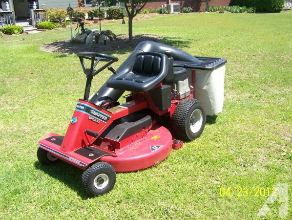

If I were going to build my own, I'd get a cart with a box on it, put a round, single blade deck from a Snapper riding mower like this under it,
Then power the blade with a hydraulic motor like what drives my current Power Trac deck. That one motor for the 60" deck will have plenty of power for one 33" blade under the Snapper deck and should have enough lift to push it up a 4' tube into a dump cart. I'd then just run some long hydraulic hoses from the front of the PT to the back to the cart and tow the thing around the yard to pick up leaves.

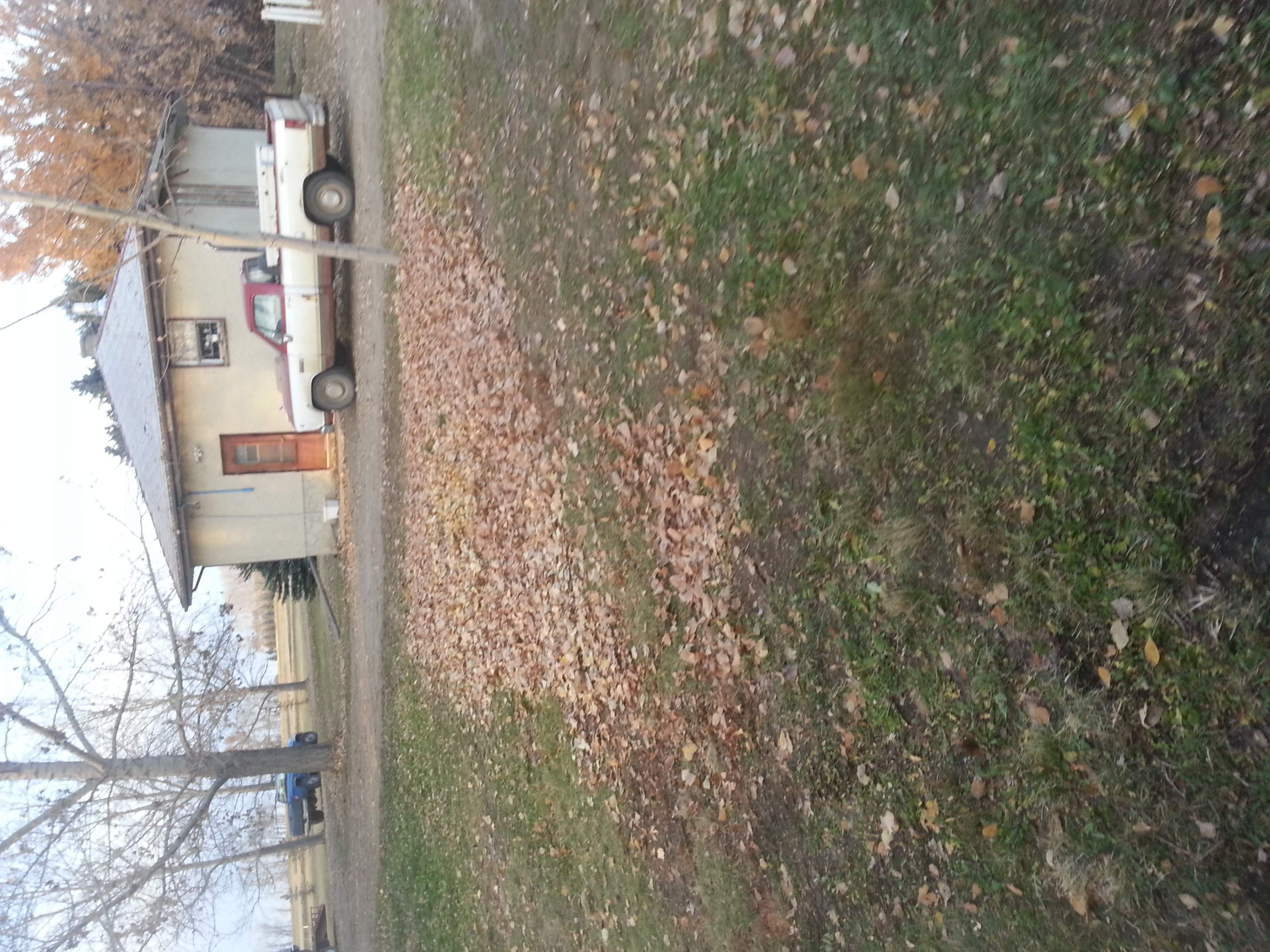

Buy a Lawn Genie. I bought mine for $200. One of the best leaf vacuums I've ever run. I don't have a picture of the actual machine but if you google it you'll get an idea of what I have. This picture is of one pass at walking speed over about 4 inches of dry leaves.

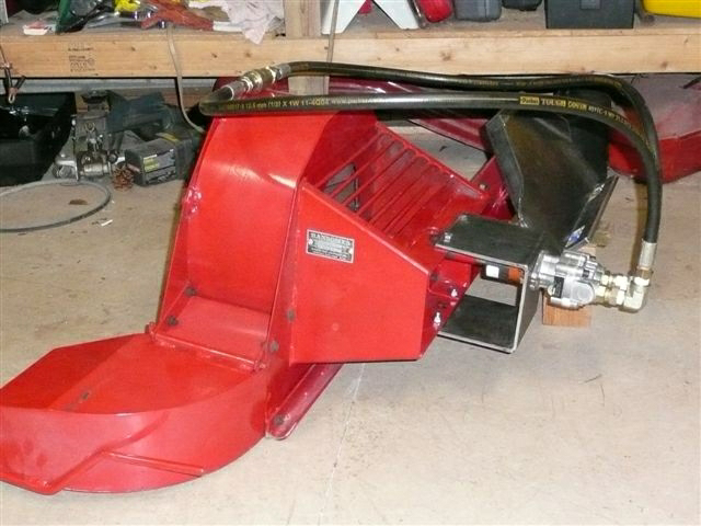

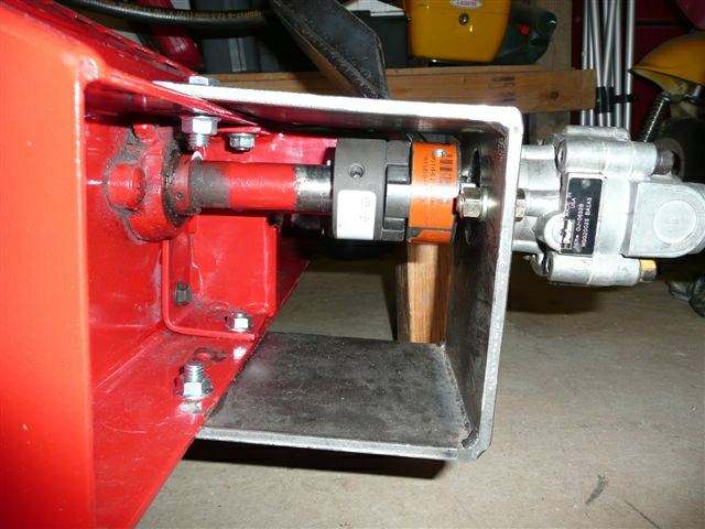

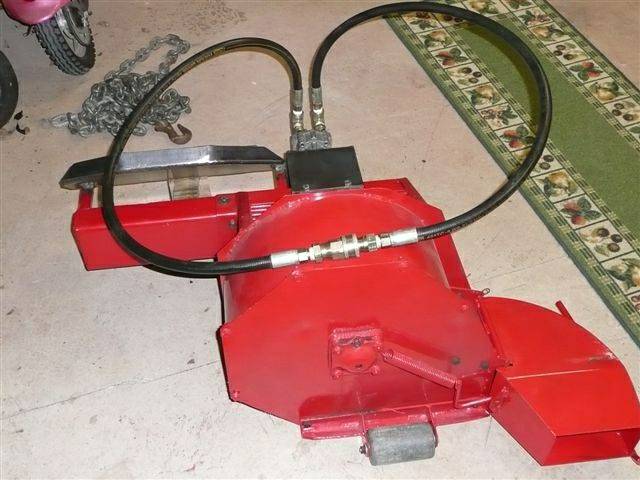

This is something a made some years back and it turned out to be one of my favorite attachments. It's from a steiner.
