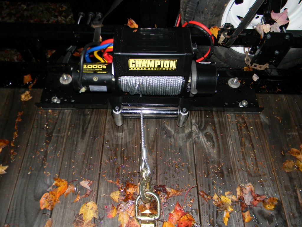

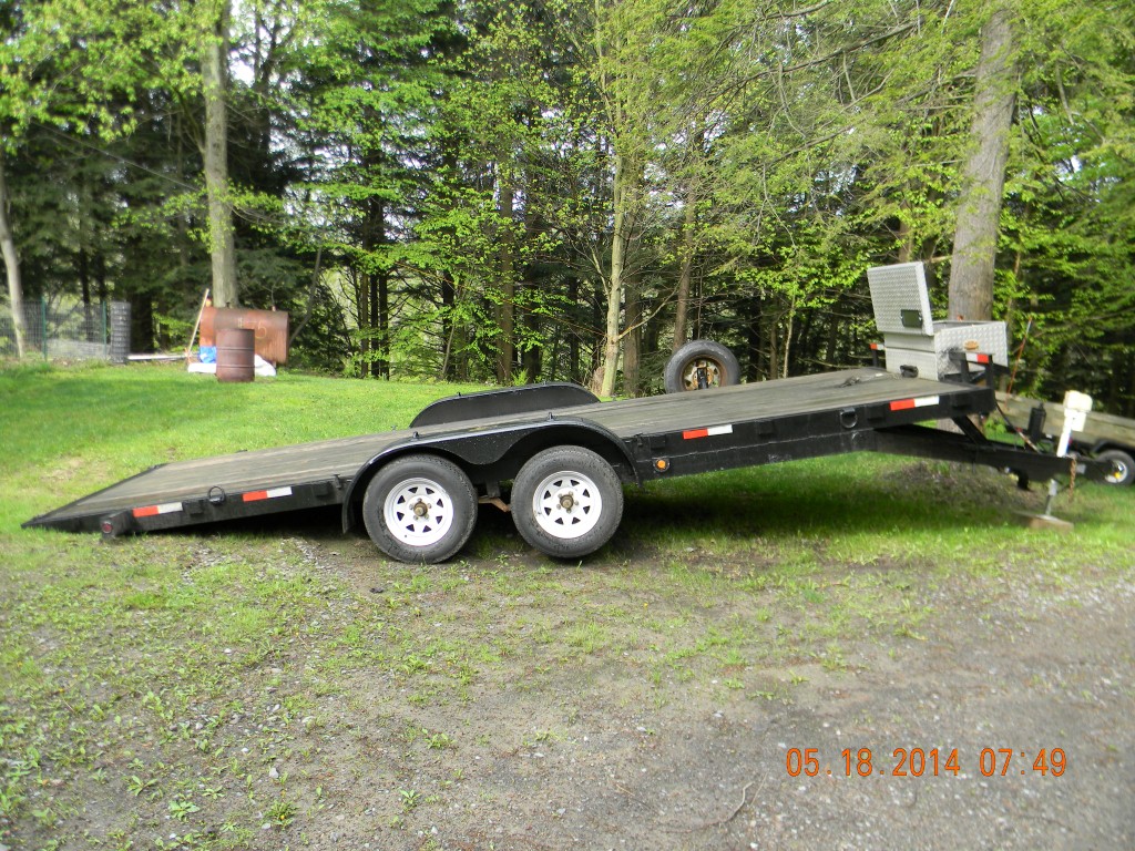

On my previous tilt bed trailer I mounted the winch inside a TSC box on the front of the trailer. The box was supported by 1/4" angle and the winch plate bolted through the box and angle. I cut an opening in the box and mounted the fairlead. Current tilt trailer has the winch mounted to the deck. Front of winch plate bolts through the trailer front cross beam and back mount bolts go thru 1/2" thick plates on top and bottom of the deck. For both winches I bolted a D-ring on the deck for the cable hook. When retracting winch cable without a load I hold tension on the cable using heavy leather gloves. Always wear gloves if hand are in contact with cable.
That first photo looks like the cable has bird nested on you with lots of loops overlaid by the cable. Definitely not enough tension on it as it was rewound.
You are correct. Once the winch is put in free wheel and I pull out 25-30' of cable to hook up a vehicle to drag on the trailer the cable is in sync on the roller. The problem with that setup is with the winch mounted inside the box I could not see the roller as the cable is retracting to guide each cable wrap properly. The new trailer winch isn't in a box so I can guide each wrap as it winds up. When not in use I cover that winch with a large rubbermade tote.

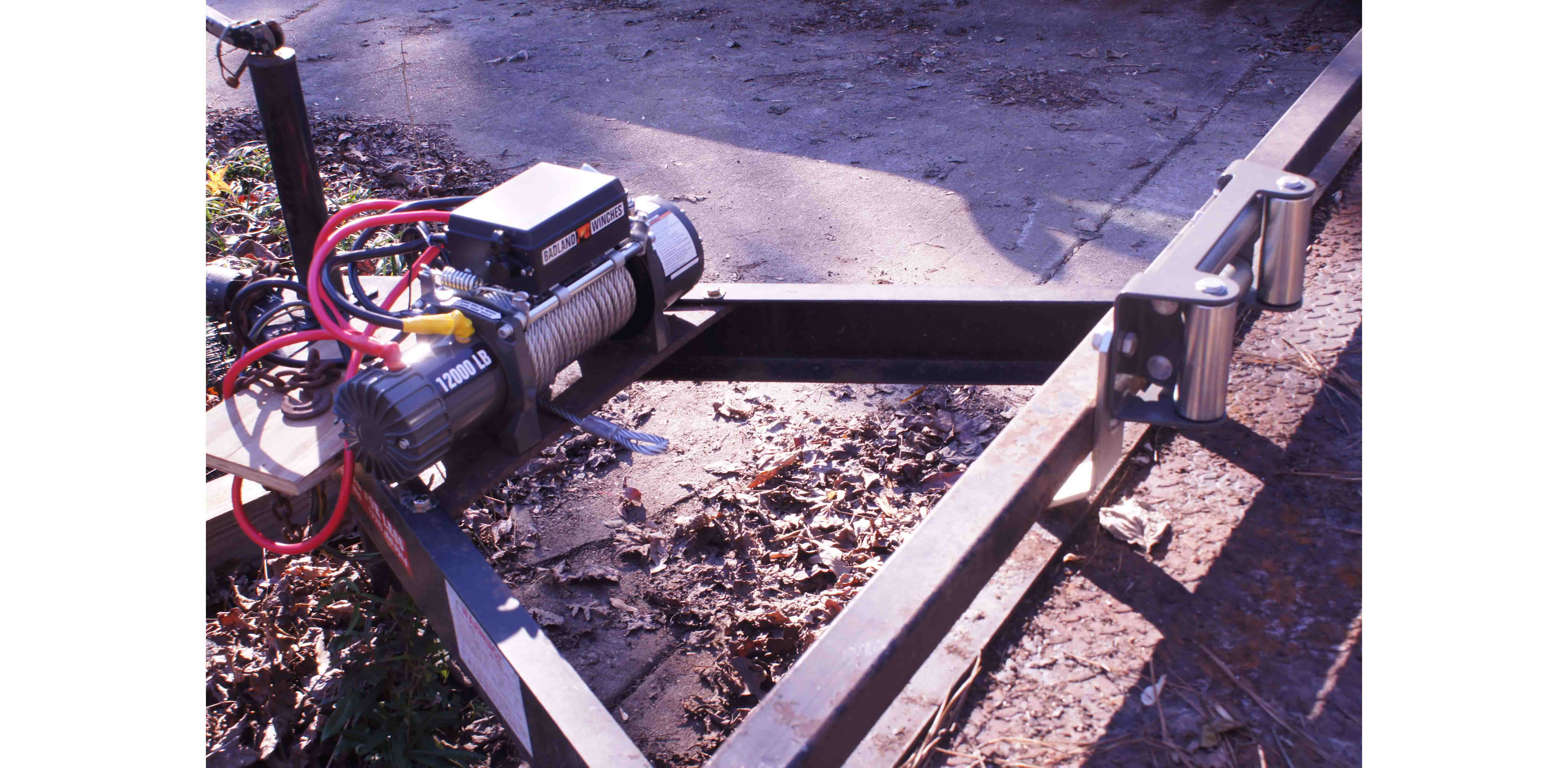

View attachment fairleadw.jpgJust a photo of how I mounted the fairlead and the winch. The metal plate I had for the winch was not very long so the winch is closer to the front of the trailer than what I had really hoped for but it does allow the cable to completely clear the tire stop bar when threaded through the fairlead. I have only off loaded a small car with the winch, got it on the trailer with a hand winch and a come along and that effort convinced me that a powered winch would be better. So I don't know how well the cable will spool back in when pulling a significant load onto the trailer but I think it will be fine. Just handheld the cable with a rag when rewinding this time.
Well it seems I cannot upload a photo for some reason. Believe me it is about this far apart .....
