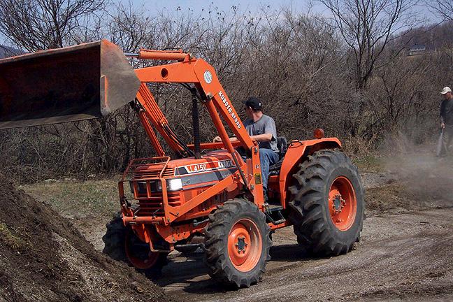

Hi - I notice you've gotten some responses that say the price is too high, but no one has commented on the L3750 itself. The L3750 is one of Kubotas's L3 chasis series which, in my humble opinion, is one of the best products they have ever offered. During the years that Kubota was trying to gain market share in the US, they were competing with Massey and Deere and other "massive" tractors. The '70s L series Kubotas had been lighter weight machines developed for Japanese agriculture - smaller, more compact, lighter weight than American machines. To make more inroads into the mid-size market, the L3 chassis was introduced - a much heavier and stronger tractor. The original L3 models were L3350, L3750 and L4150 (attached picture is a 4150) . These numbers represented the PTO horsepower - their gross hp was about 20% more. Taking everything into account, the L3750 would be more comparable in size, weight and strength to today's MX5000 or M4900. It is stronger and heavier than any of today's L-series except possibly the L39. Weight is important handling round bales and square balers. I think it would have power enough for a 6ft haybine or 7' mower conditioner with sicklebar, assuming flat land.
If this tractor is clean, and if it has not been painted, and has been in one owner's hands the whole time, it may indeed be a rare find and worth $15k. That said, the dealer has to wait until someone happens by who appreciates what the L3750 actually is, so it could take some time. If he took it in trade from the original buyer of it, he probably had to allow a high trade-in on it so may not come down a lot. For perspective, I sold my L4150 (with loader) for around $18k a couple years ago. I got top dollar but the buyer knew what it was and was very happy with the value he'd gotten.
On the used-vs-new front, the L3 is so well made it is likely you will not need much service - so the warrantee thing may not be much of an issue. My L4150 never had a failure of any kind during the years I owned it. These are the machines the Kubota legend was built on. If you find an unmolested one with low hours - do what a duck would do with a junebug - think about it for a nanosecond and grab it. It would probably be a fair deal at $15 and would be downright sweet at $12k. I'm admittedly a huge fan of these L3 machines. I love how strong and well-engineered they were. If shiny new with electronic display appeals to you, then maybe it's not your cup of tea. But if heavily built precision over-designed robust machinery makes you smile, you'll be happy you bought it. Sorry to be such a chearleader - but it is an L3 after all. It's what I do /forums/images/graemlins/cool.gif Take care, Dick B

Dick, I'm glad we finally got an LXX50 question to flush you out of the underbrush! Nice to see you again. /forums/images/graemlins/smile.gif I was thinking about you as I was reading this thread, and then there you were, right on cue. Your "L3" radar is working flawlessly. /forums/images/graemlins/smile.gif
Hexe - between the 4150 with 4400 hours, and the 3750 with 400, I'd much rather have the 3750. As Dick said, that would be a rare find indeed. Those L3 tractors are amazing - I looked at one when I was tractor shopping a couple of years ago, and they give the impression that the one attachment they crave most is a 105mm Howitzer. The axles are amazingly strong, and they are just plain "built". Dick didn't brag about his L5450, but deserves to. Now THAT is a tank.
I wouldn't worry too much about the relatively small price difference between the '86 L3750 and a new tractor. The most important thing is that you "buy it right" so you can get your money right back out of it when or if you decide to go for something else. For instance, maybe you'll want a nice hydro machine. Bear in mind, you probably have a better chance of recouping your purchase price with a used machine than with a new one.

Hexe - whether to buy a backhoe is up to you - this pic is my present rig - the fabled L5450 (Hi John) which has an 11ft Bradco hoe. I used the hoe for rock removal in my open land - but it only gets used once in a great while now - mostly it's off the tractor. This is a decent size digger, but large animal burial takes skill too, which takes time to develop. (Not good to practice in front of the family when Dobbin kicks off)
Regarding the L4150, the average homeowner/landowner only puts 50-100 hours on a tractor in a year - sometimes less, especially if they have more than one machine. 4400 hours is a lot on any machine, even a 4150 - the original parts are all well worn and the value of the machine depends more on how many parts have been replaced and how good a job has been done of keeping up with it. Most of these machines were sold to commercial users - landscaping contractors, rental outfits, etc. and many have had a hard life. This one would require a very close inspection - which would be tough from a distance. What appeals about the L3750 is that it (1) is a one-owner machine with known history by the dealer (2) that it impressed you as very clean and (3) it has very low hours. It might be good to be extra sure these are all true before offering cash. How about only putting $12k on the desk first, then another $500 if the dealer doesn't stop crying?
