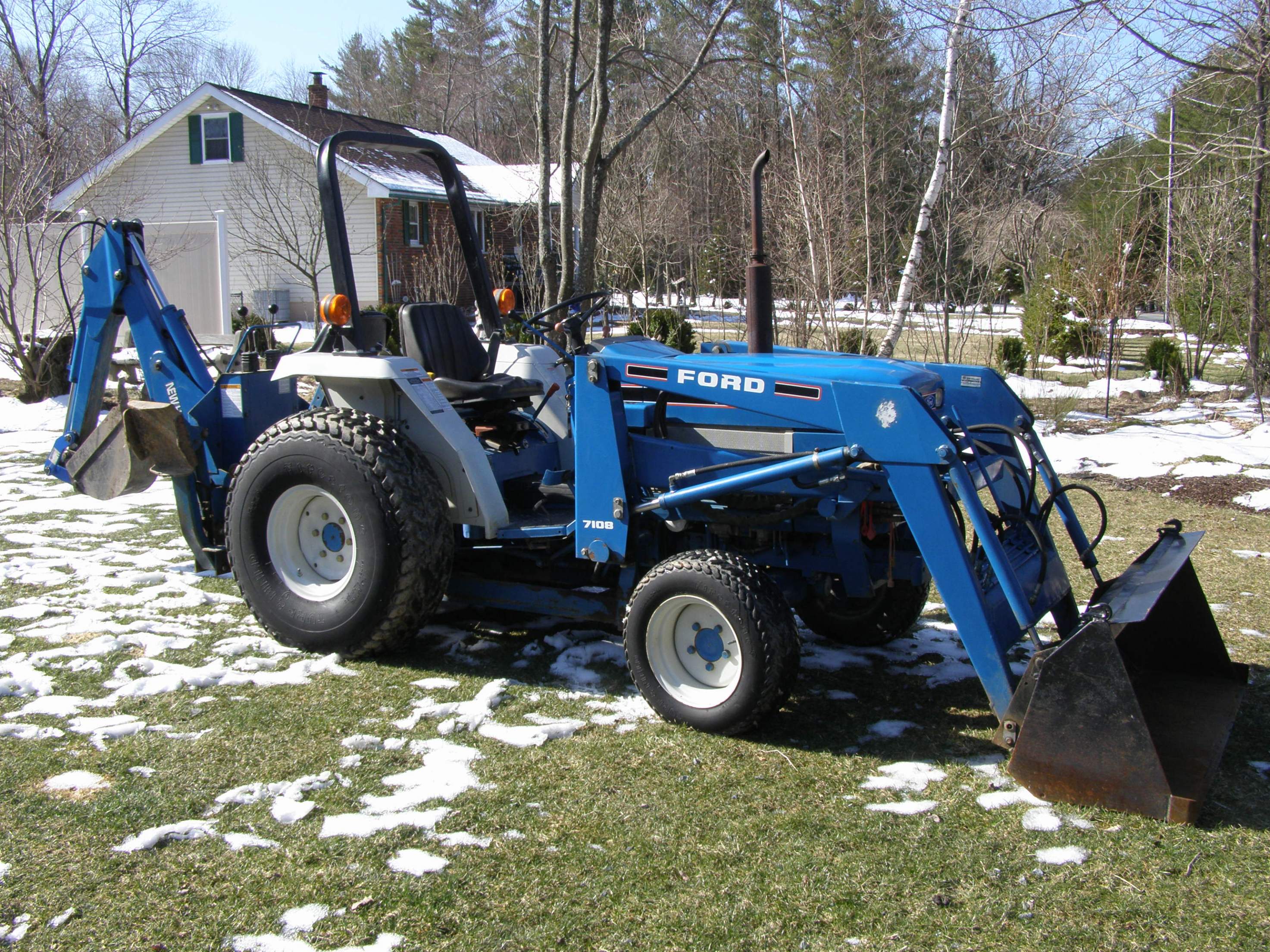

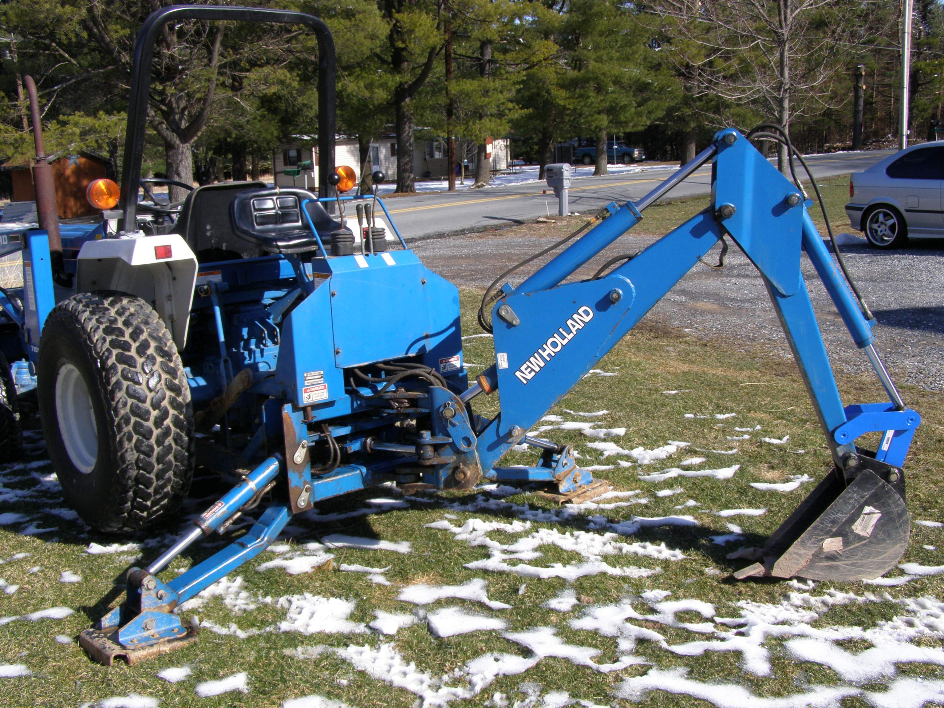

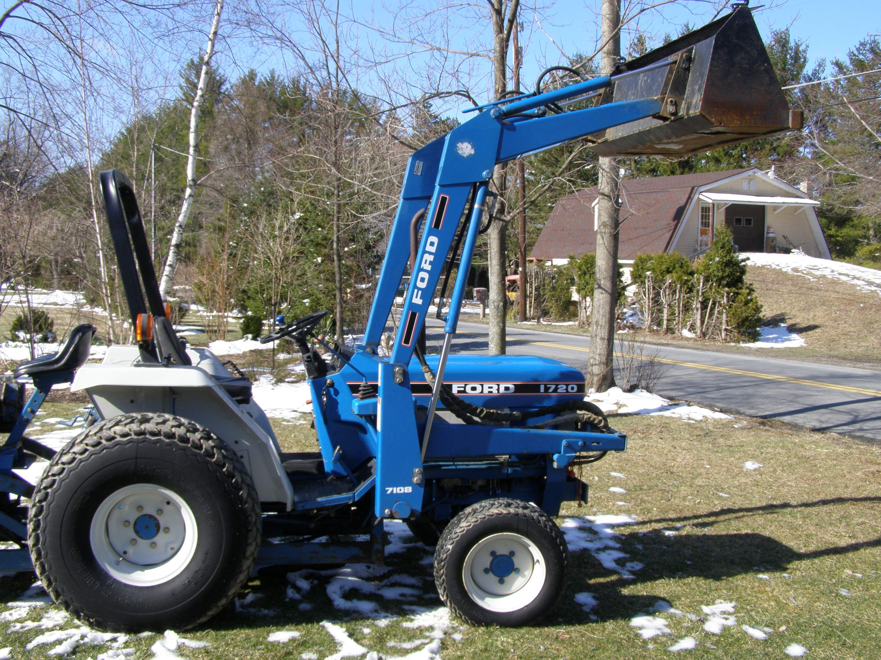

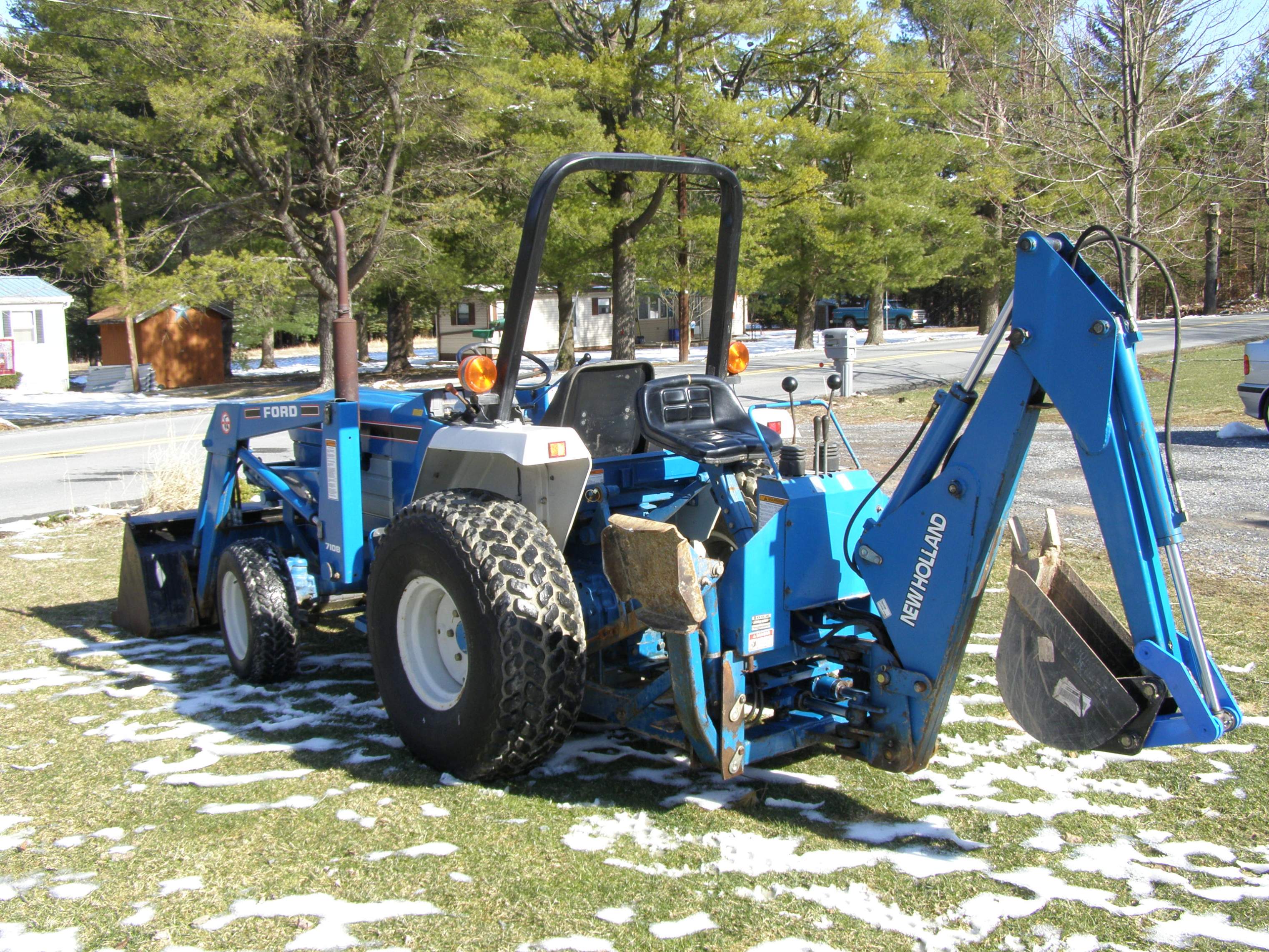

Oh and BTW I'm selling mine its a 1989 with a 7108 loader and 757 backhoe. has 978 hours on it and works wonderful... its also 4WD ---- $13000
