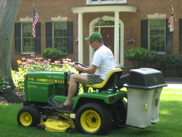

That would be a bad investment in my opinion. My 318 I bought in 1987, and none of the cylinders on the plow, steeting or lift leak. I think they last a very very long time.
You might be better off investing in oil for oil changes since you should do that every year and the price of oil will probably not go down any time soon....
